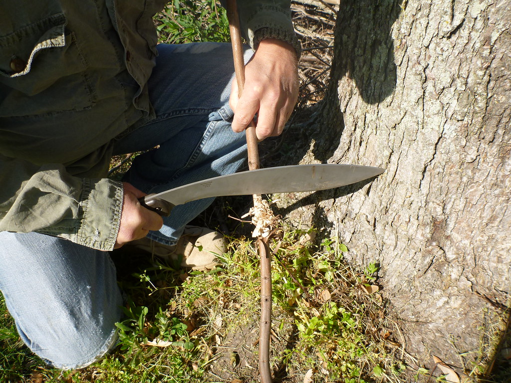

Here are some big knife tricks that I've picked up and haven't seen posted anywhere before, so try em out for yourself. Most of you probably know these, but some may not.
One of the things about a survival situation is you need safe, easy ways to do things without expending much energy. If you have a big knife, let it work in your favor. A different way to make fuzz sticks is to jamb the tip of your knife into a tree, use that as the fulcrum and lever the knife down. Makes shavings and feather sticks without having to brace the stick against your chest and keeps your hands out of the way. Like this...

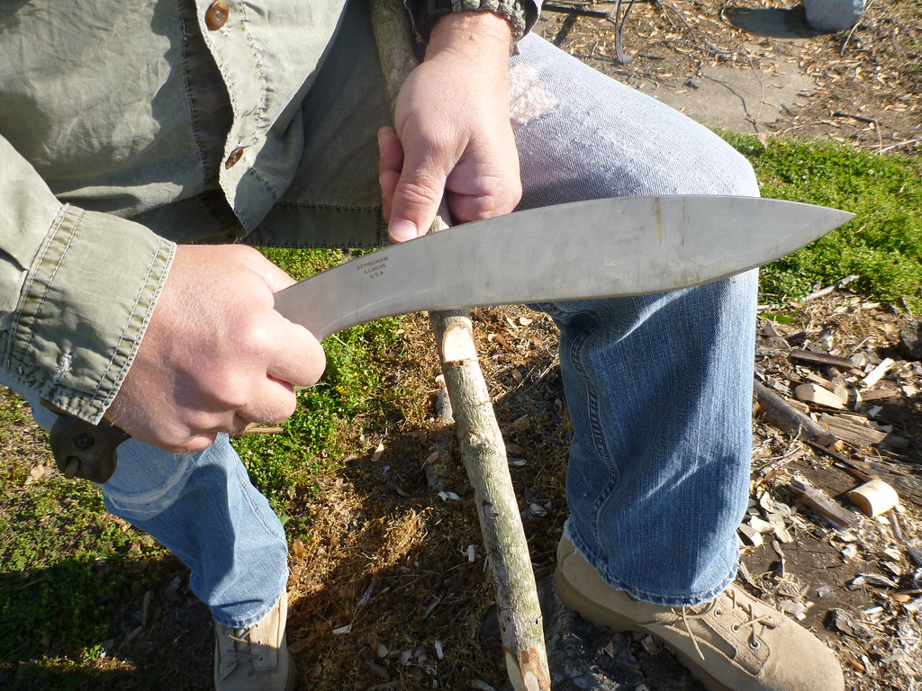

When pointing for a stake (or whatever), set it up on something and keep your grip hand at or below the work. You are more accurate and your chops are effortless. Everything vital stays out of the way.
