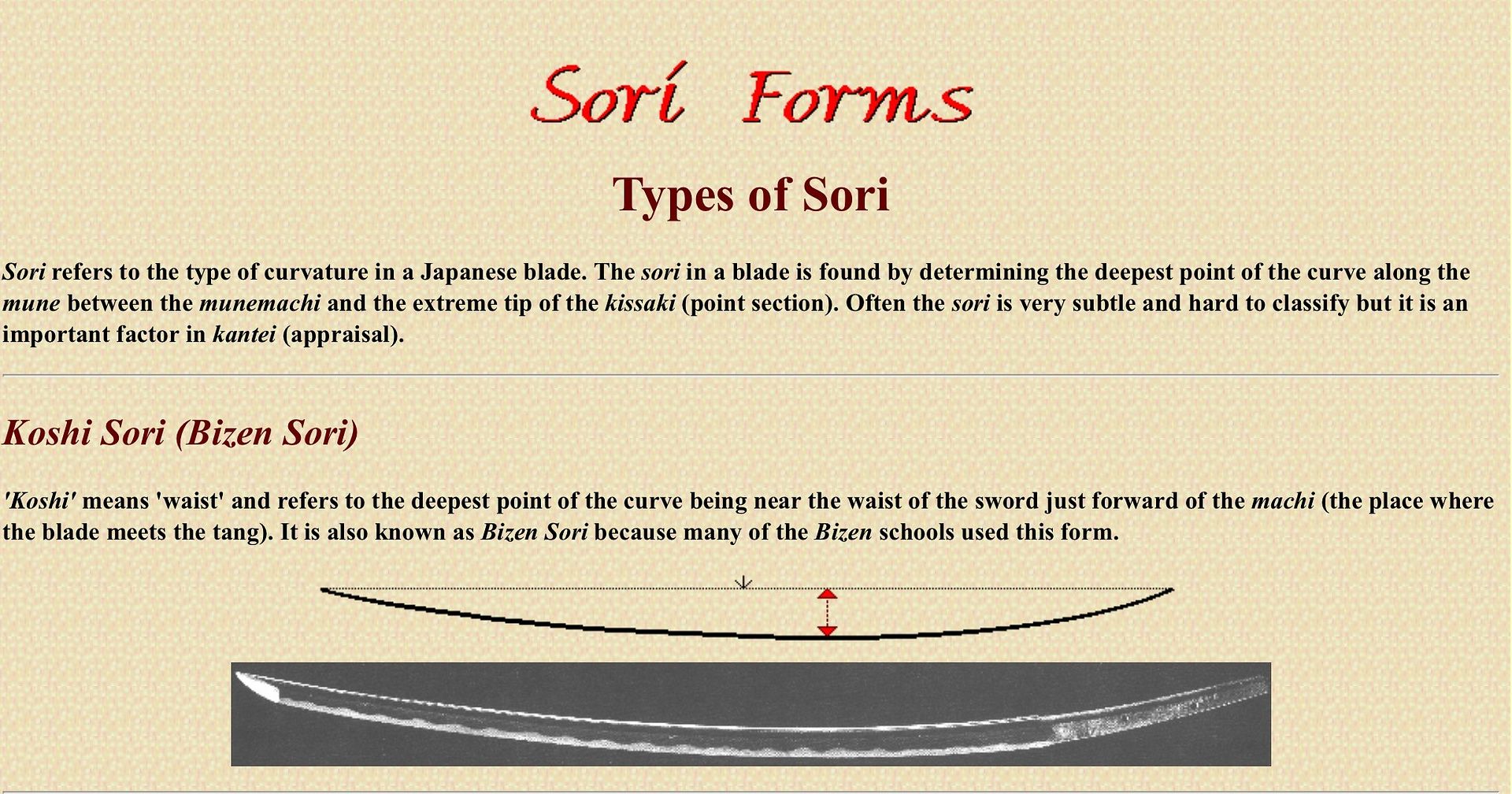

For those of you that do not know what Sori is
Sori is the term used to describe blade and handle curvature in Jaanese style blades

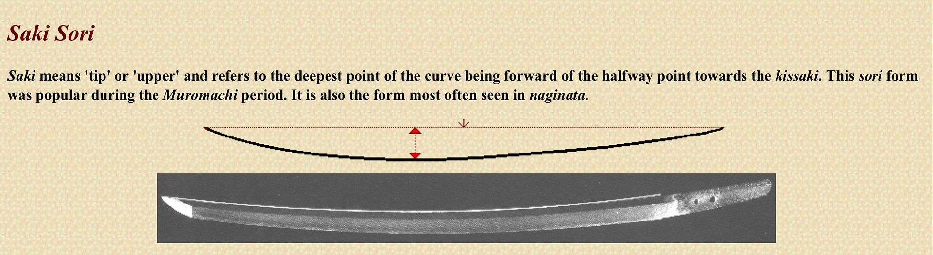

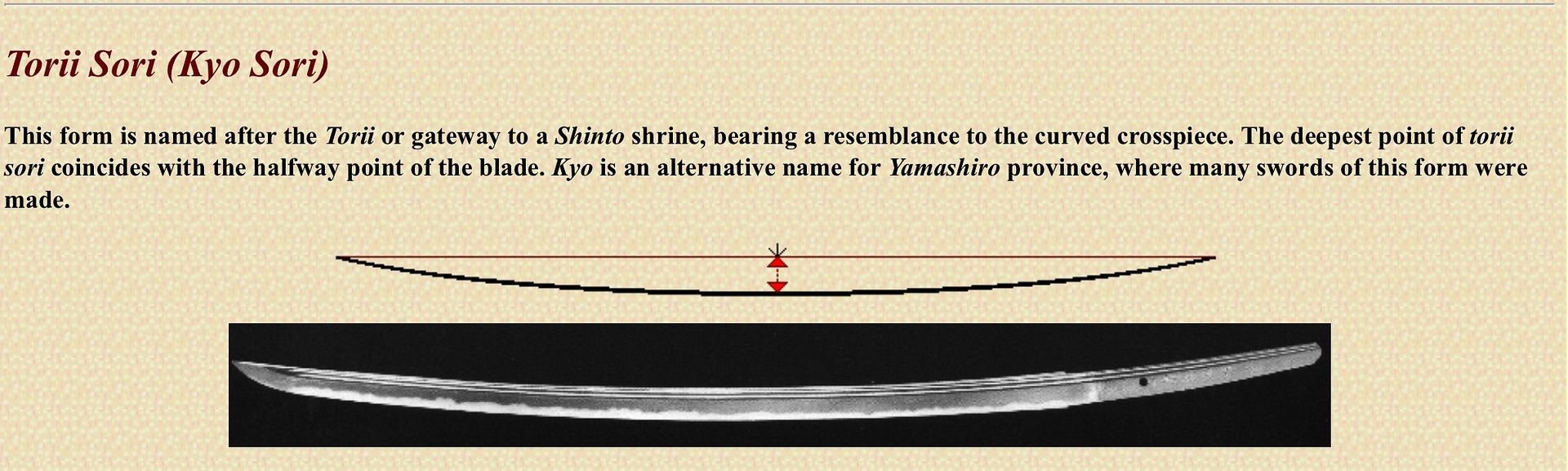

On a sword I like to see Koshi Sori or Torii Sori
This is good on smaller blades also but on a KWAIKEN sized blade I really wanted to see one that exhibited Saki Sori

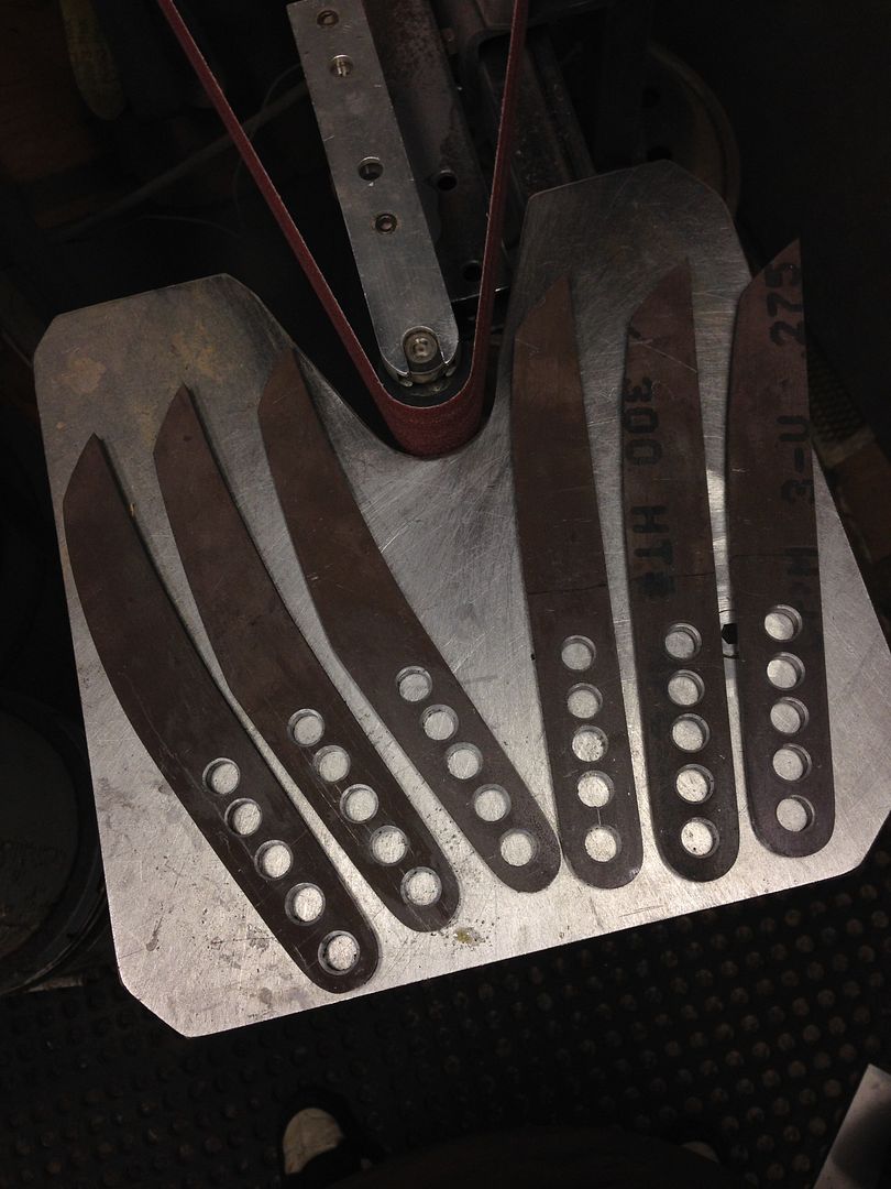

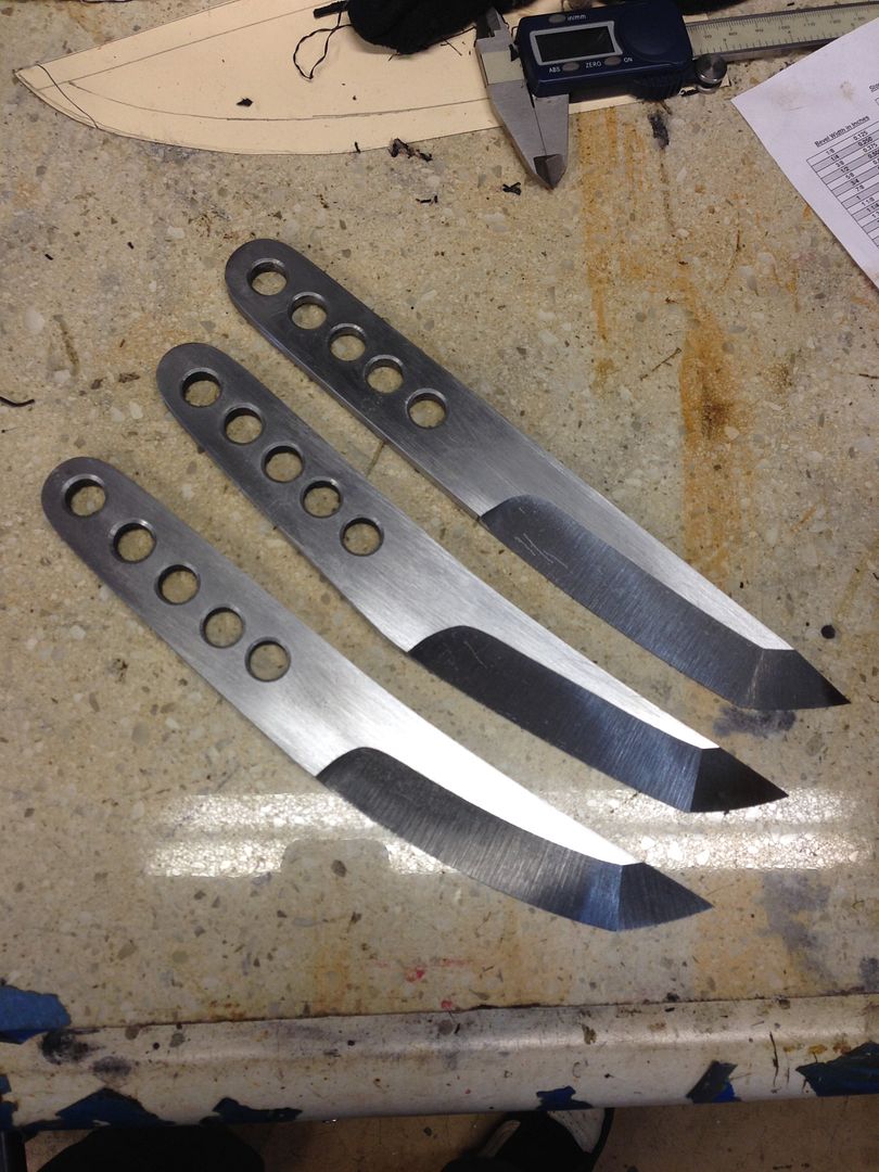

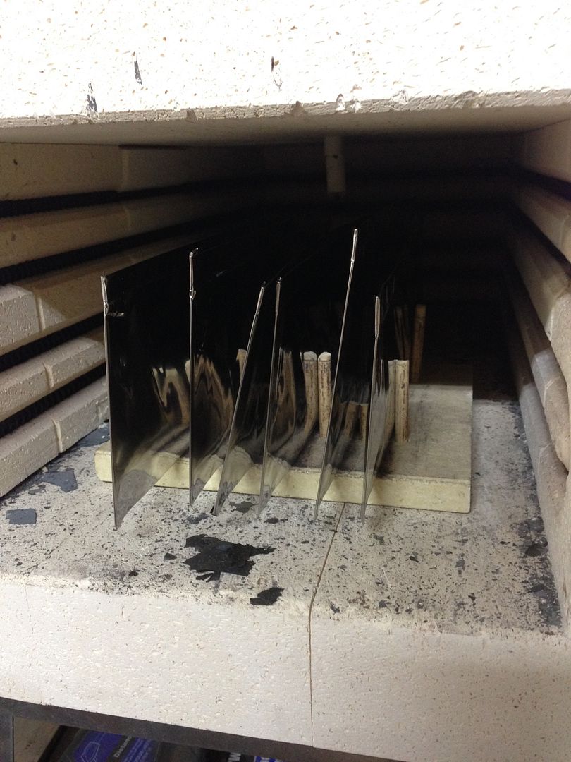

Anyway moving on.....I am actually working on a batch of kwaikens right now, including Joe's And my original Kraiken design. On this batch I went full "strongboy" with 1/4"+ CPM 3v. With a 20 degree chisel, it is the equivalent of a 10 degree per side cutting edge. So although super thick, they should be nasty cutters.
I didn't get any pics of me hunched over my bandsaw cutting out the blades, but it's not very exciting anyway.

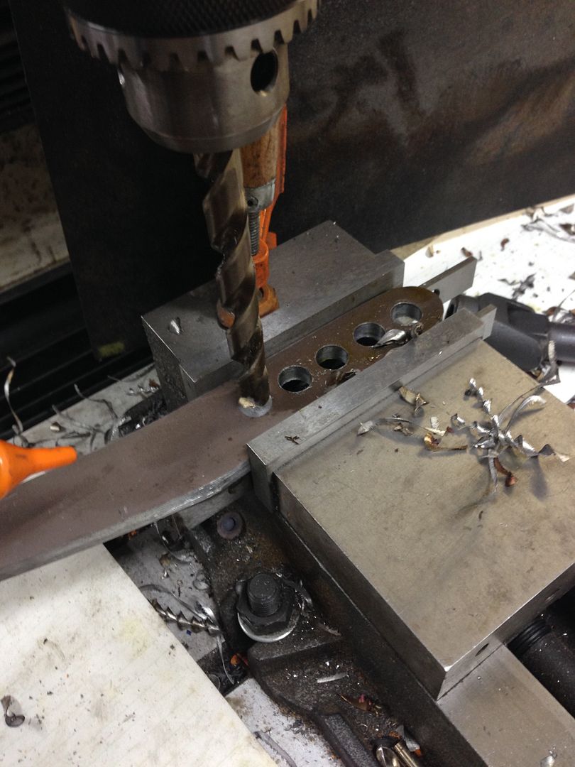

Here I am lightening the handle area...
Here the blade is rough ground and ready for HT foil.
Here are all 3 designs ready to HT.

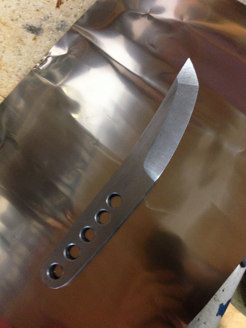

Ready to wrap in high temp SS foil. This keeps the 2050f kiln from burning up the steel. : )
Everyone in the oven!

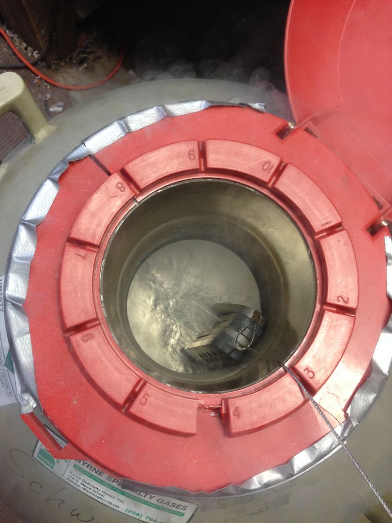

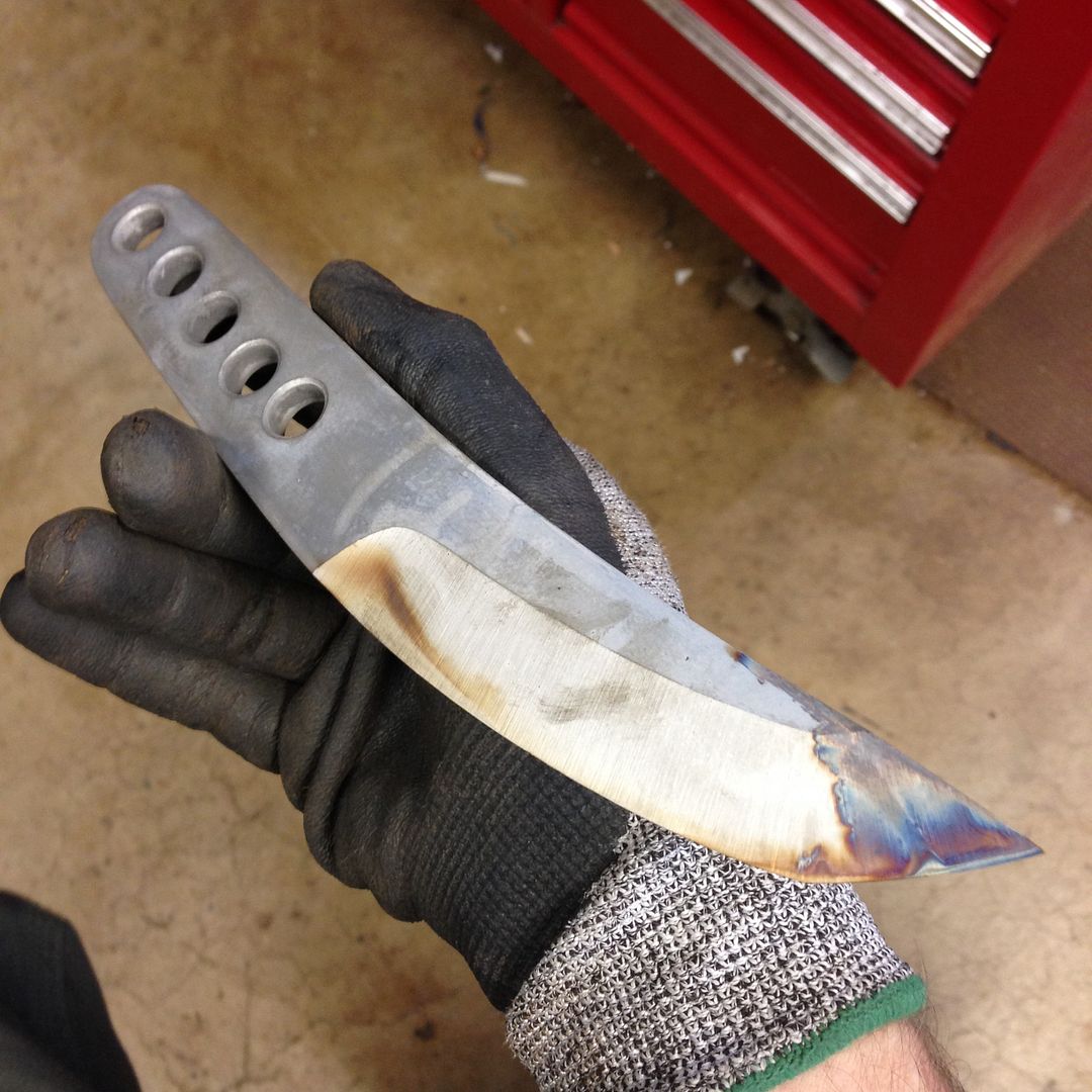

Once my HT cycle is complete, I pull the blades out of the kiln and plate quench them. Once the blades are cool enough to handle, I pull them out of the foil, straighten them if needed and then they got straight into Liquid Nitrogen for a Cryo bath.
Here is Joe's knife ready to go into LN.
Everyone in the pool!!

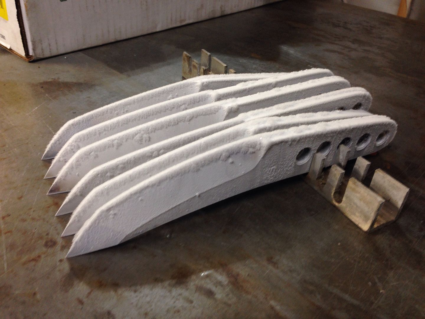

I let the blades soak in LN overnight, 6-8hrs is fine, but longer is fine too.
Here they are all frosty cming up to room temp before temper.

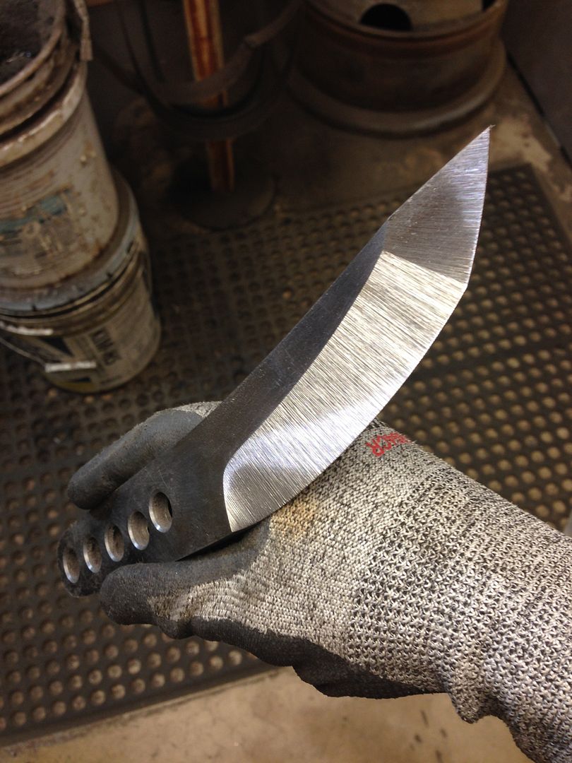

I was finishing up another kwaiken order today. But I did get the "swedge" ground in on Joes blade.
So that's a kicked back handle, SICK belly.

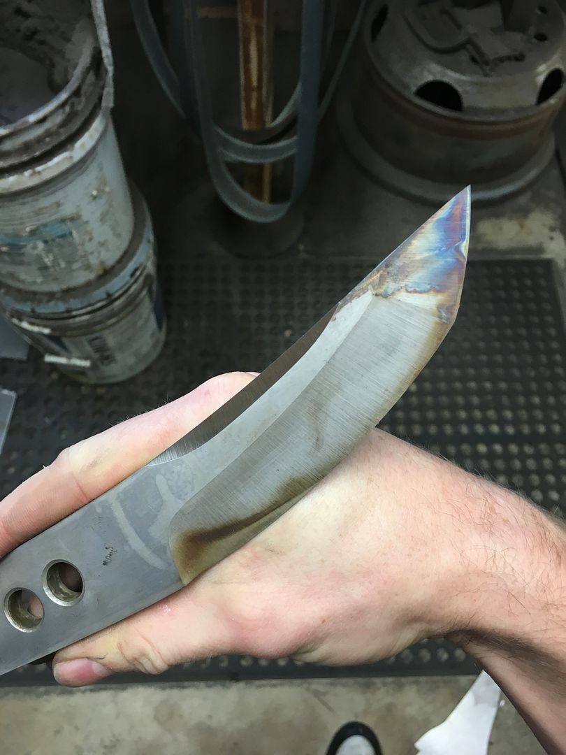

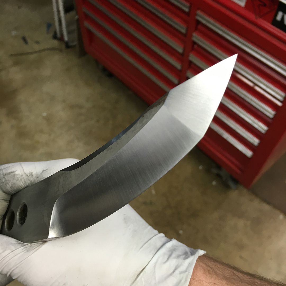

Finish grinding the blade.
Although I don't do the buffed 40 grit finish on these, I am leaving them with a machine finish on the flats and bevels. I'd be happy to do 60grit Finish if someone really likes that look though. ;)

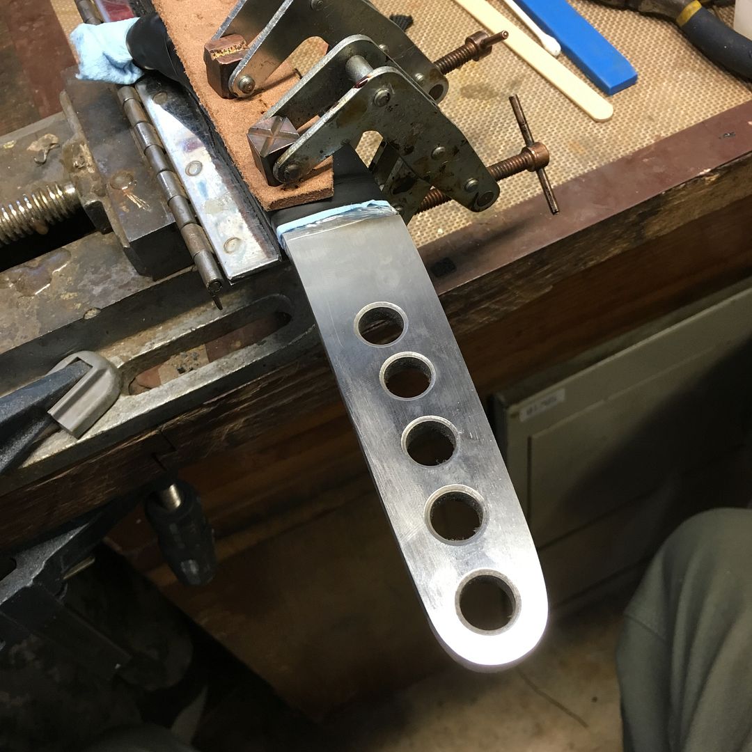

Ok, here are the progress pics for the day. After the last pic, I cleaned up the flats, etched my makers mark and then cleaned up the flats again.

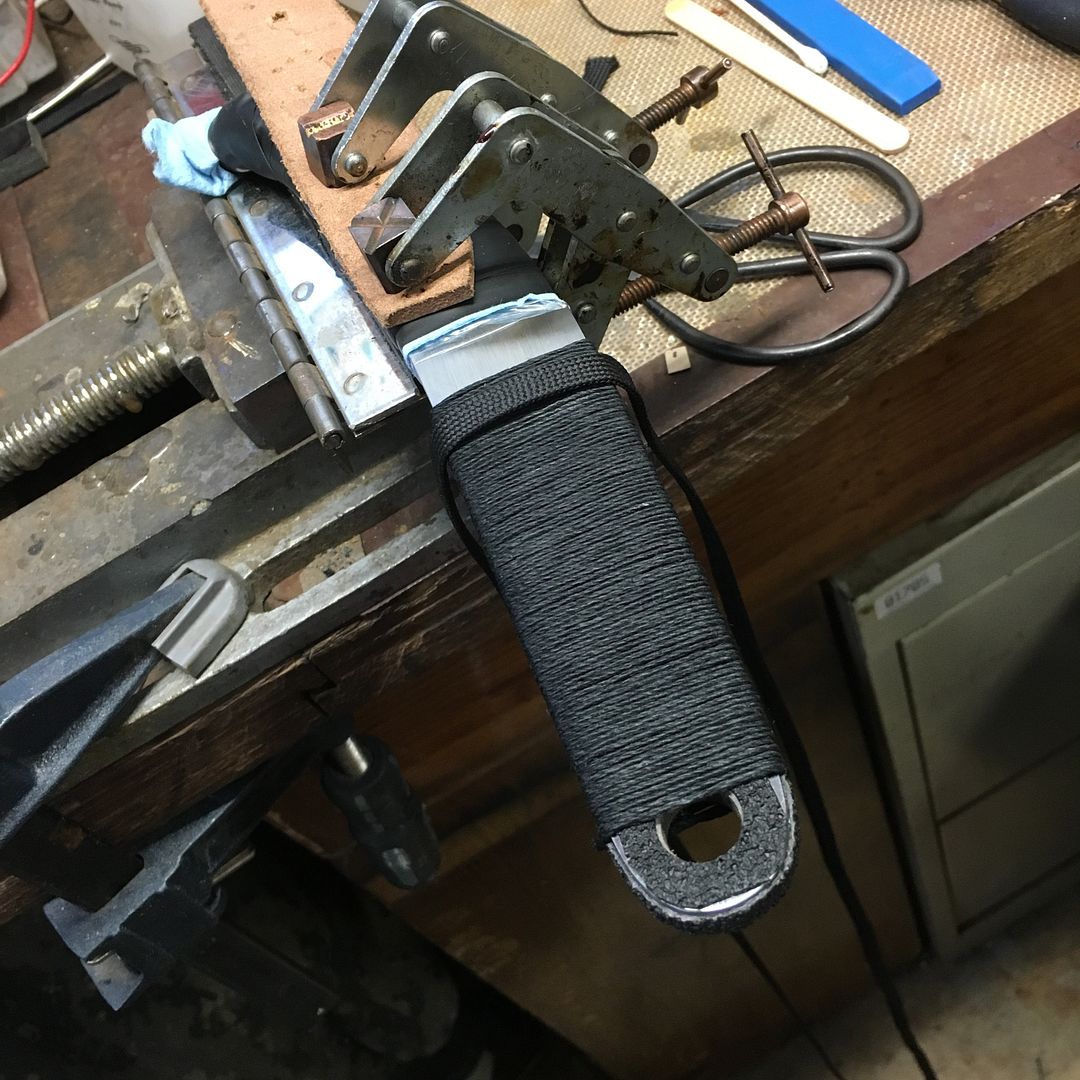

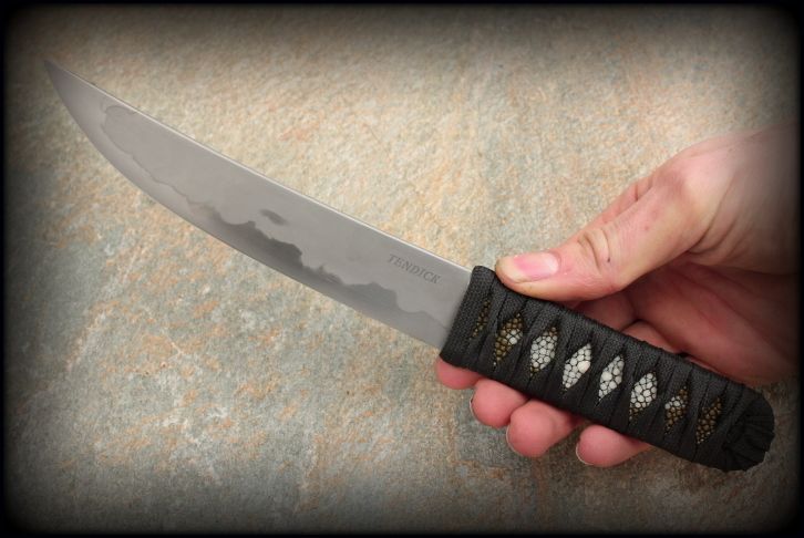

Here is the knife, blade wrapped to protect the finish, on my fancy pants handle wrapping jig. It basically is a hinge I clamp the blade to so I can flip the handle back and forth while I wrap it. Doing Tsuka Ito, my version anyway, is tricky enough. So this helps be an extra hand.

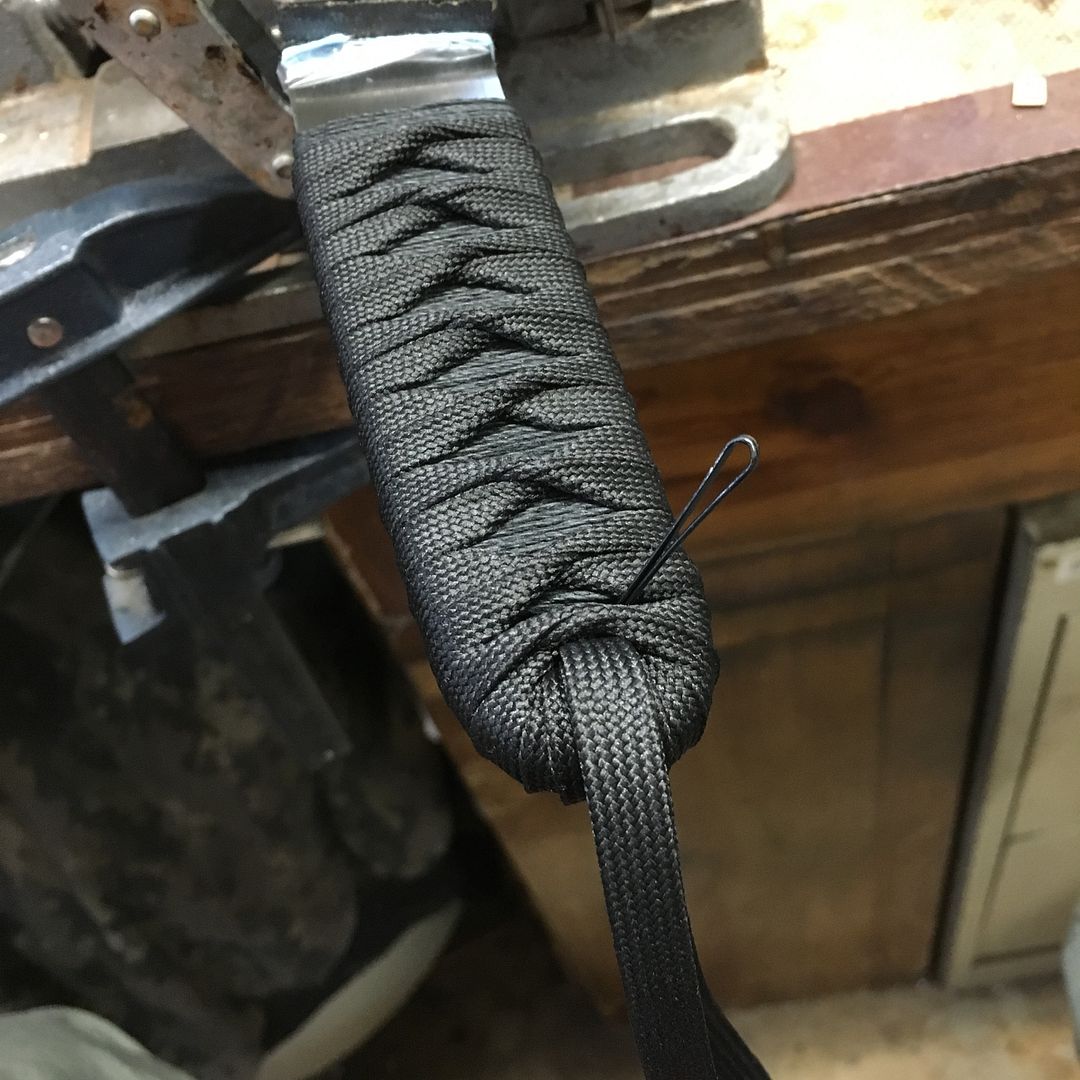

Here is the handle with the underwrap done. I used black hemp cord for this.
My hands don't leave the knife once I start the wrap, so no being wrapped pics. Here I am ready to tie the finished knot, Hair pins make this WAY easier to accomplish.
Notice the alternating over/under knots, IMO this is the proper way to do it. Most people wouldn't notice if all the knots were the same direction, but I would. It's the little details that make the knife.
It should be noted that Josh Mason got me started when I had questions about wrapping handles, probably wouldn't do them if it wasn't for his help back then.

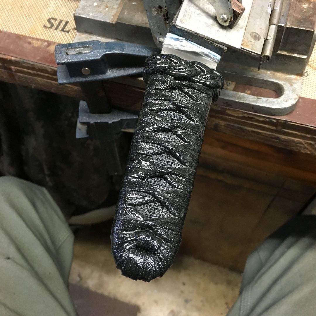

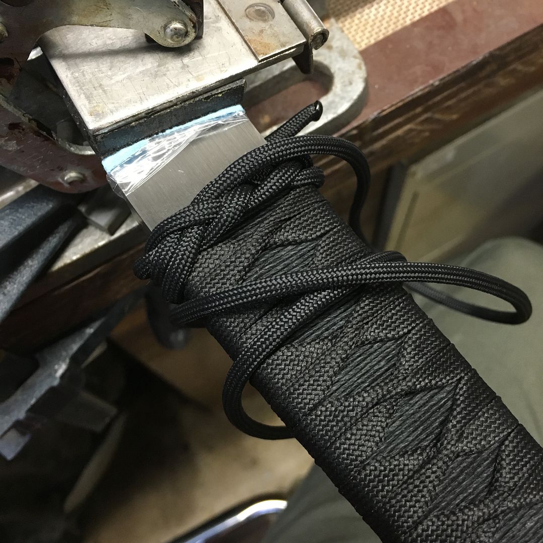

The wrap is done and I am tying the oh so fun Turks Head knot.
Once the knot is complete, I brush on West systems G/flex epoxy. I make sure and get it in all of the nooks and crannies. It has great "wetting" ability and 99.99% of what is on the wrap in this pics will soak in. If there are any wet spots after about 10min, I clean them up with a paper towel. If done properly you almost can't tell by looking that is has be treated, but it ends up being very solid.
