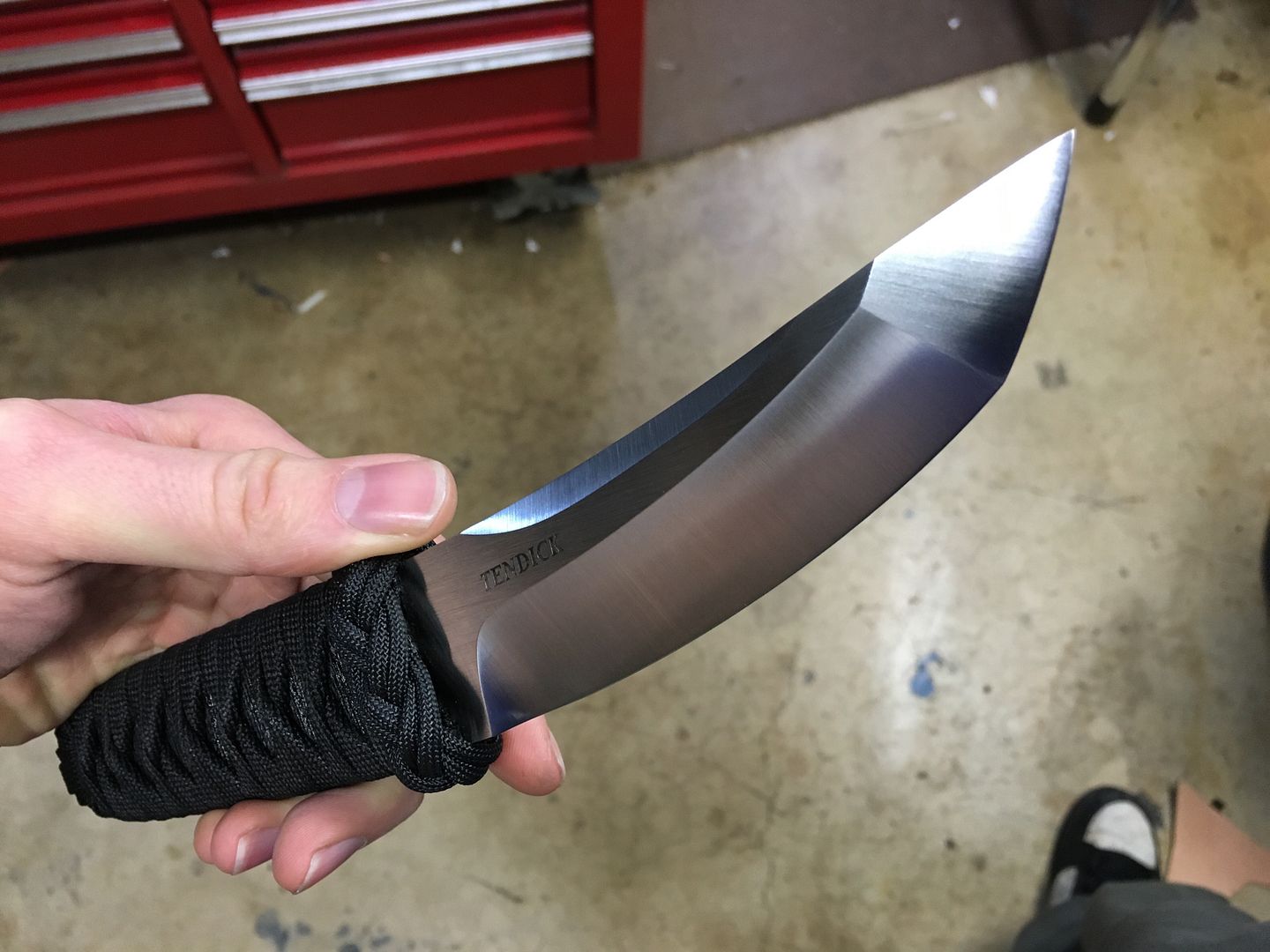

The knife is pretty much done at this point. I hope to get the sheath done tomorrow.

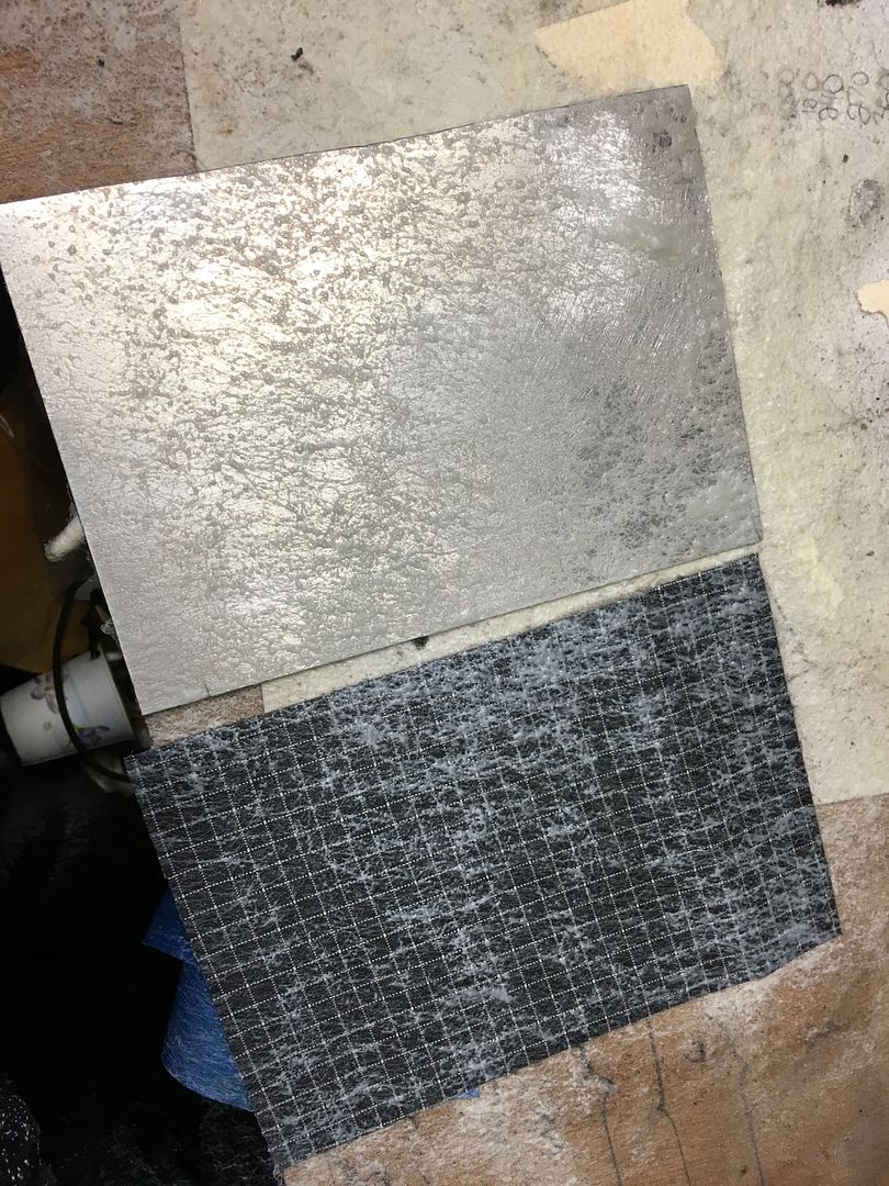

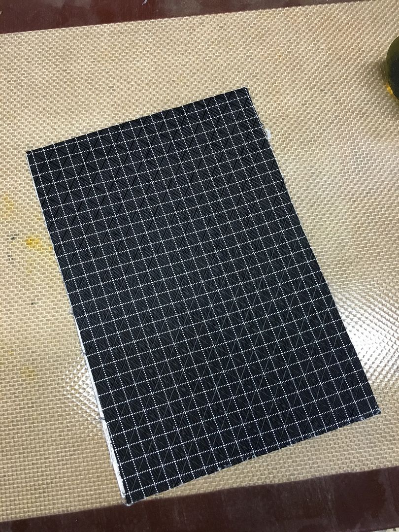

On the original sheath I used a Suede liner. While nice, it is a little bulky. On this one I wanted to try something else. I went with Dyneema Xgrid. It's a modern/high tech fabric that is waterproof, very tough and super thin. I think it will work out quite well.
Here I have used 3M 90 High strength spray adhesive on the fabric and Aluminum.
The fabric glued the metal.

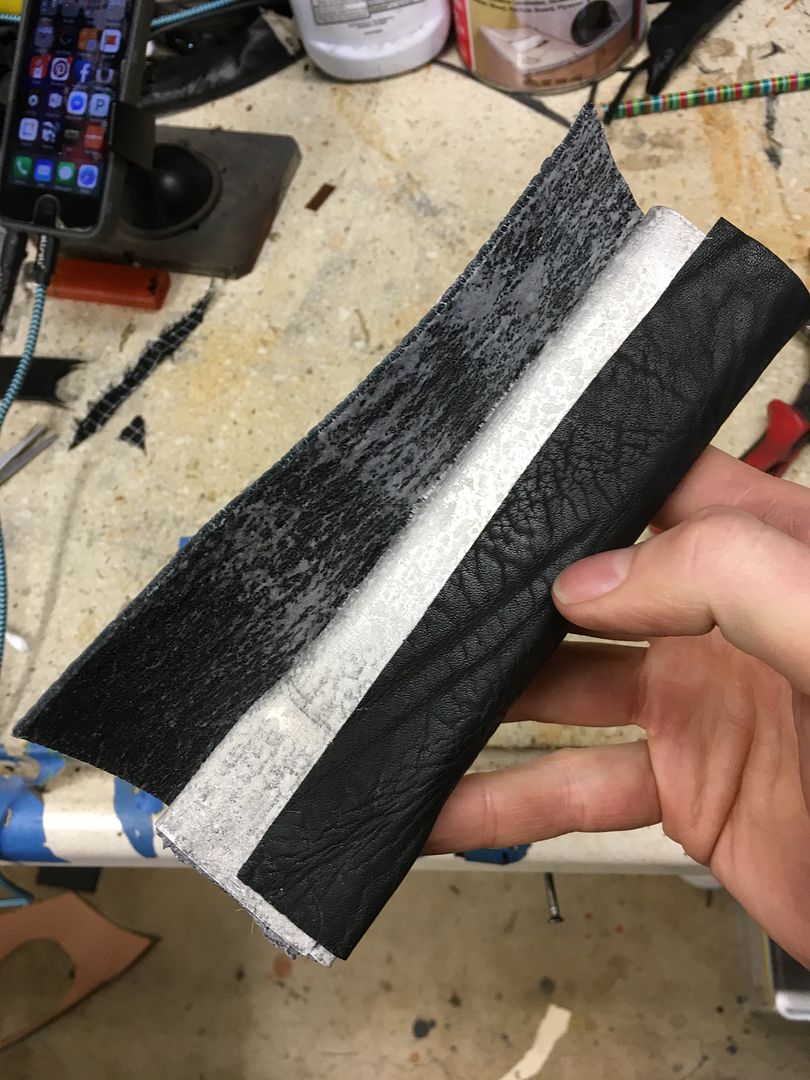

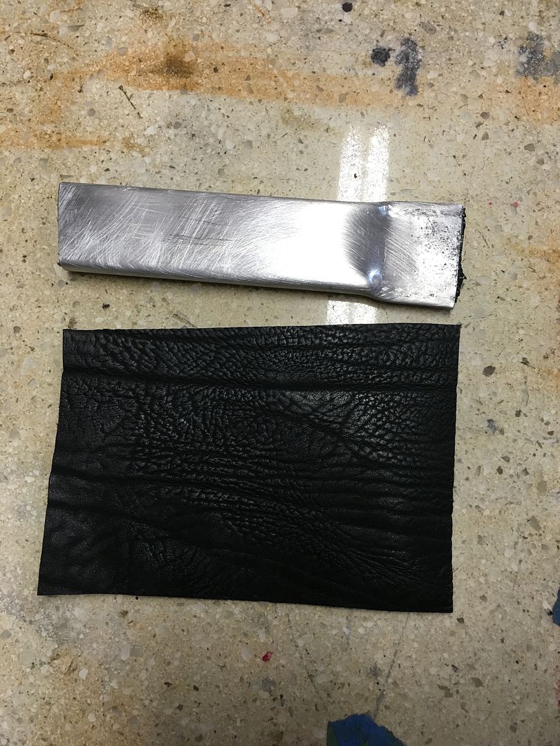

Here is the sheath after I have formed it, and the bison hide that I will wrap it with.
Wrapping the leather around.

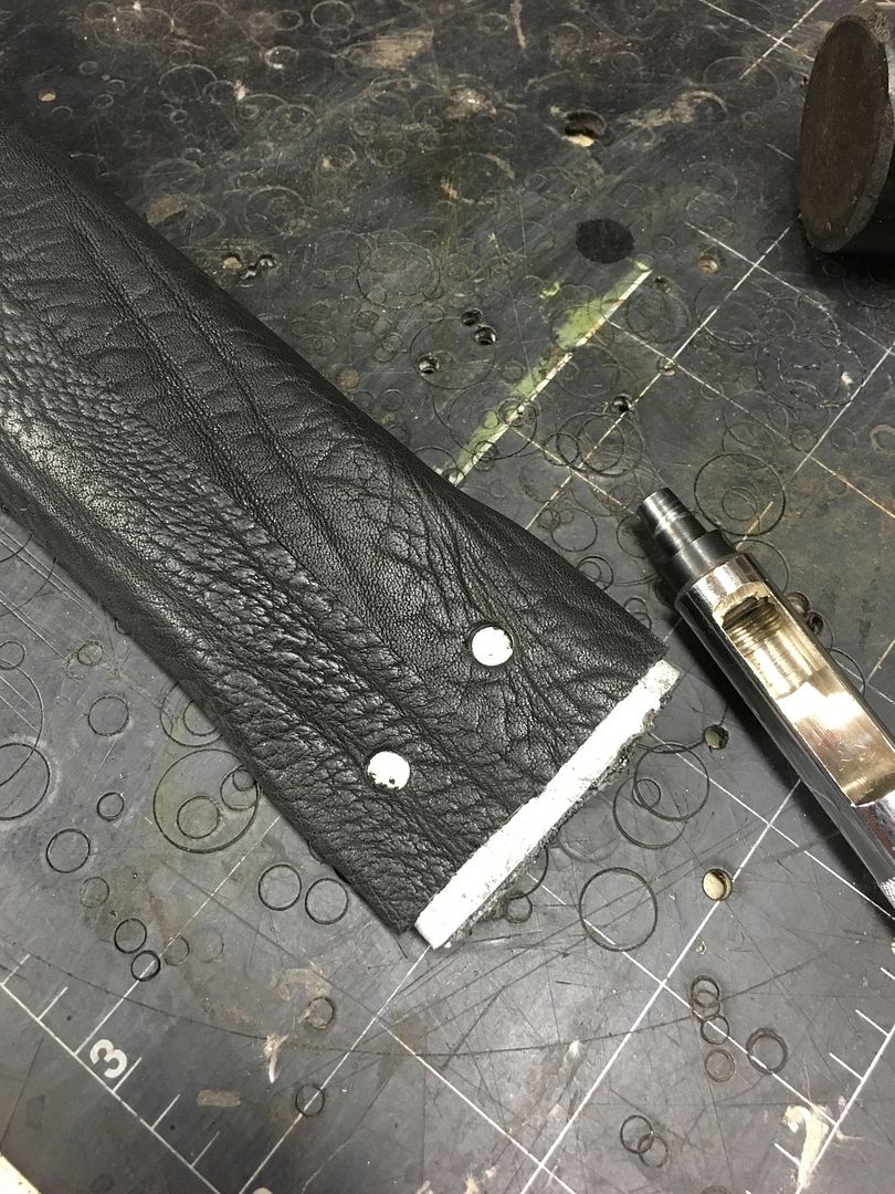

I punch holes in the leather before I drill through the aluminum. This makes for a much cleaner hole.

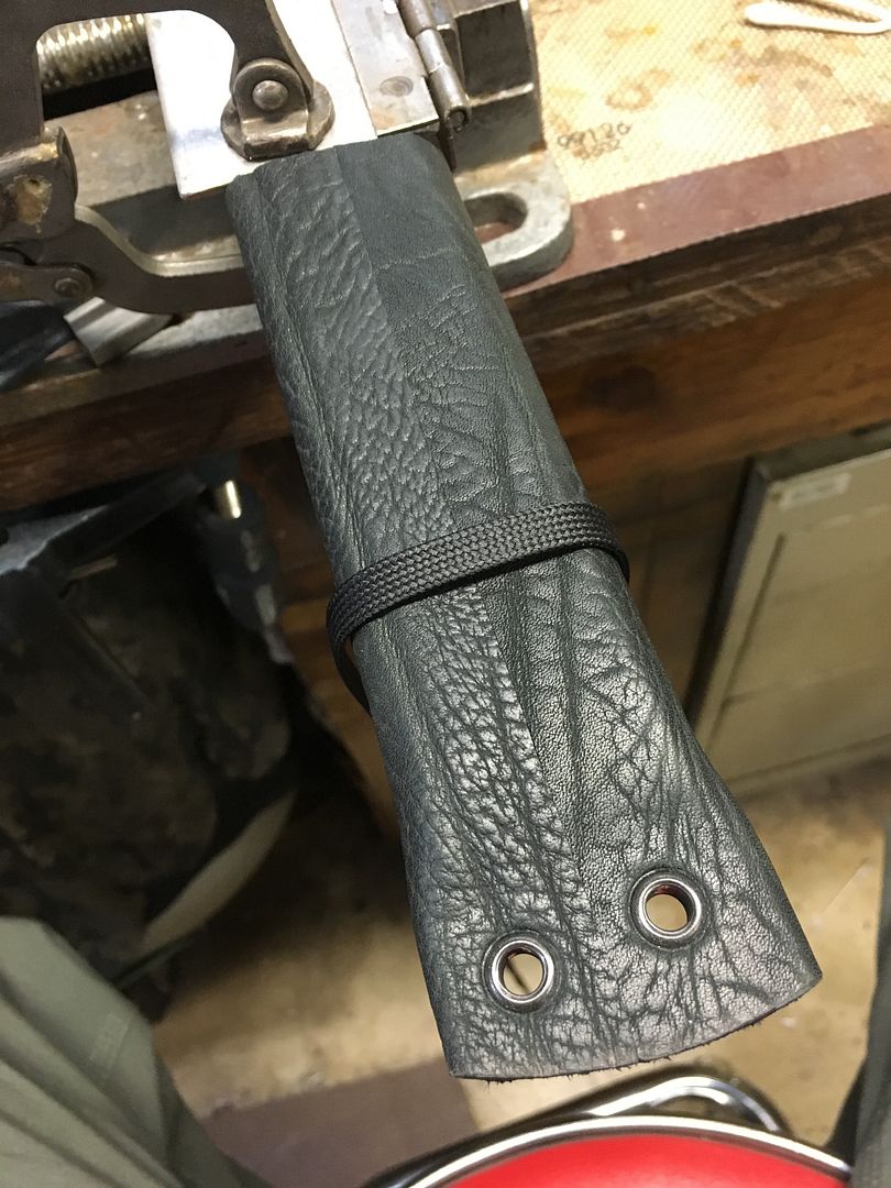

Here I have trimmed up the end of the sheath and installed the static line Eyelets. I tie the Ito on in way that it can be used as a static line, or you can attach one through the eyelets. Everyone likes options.

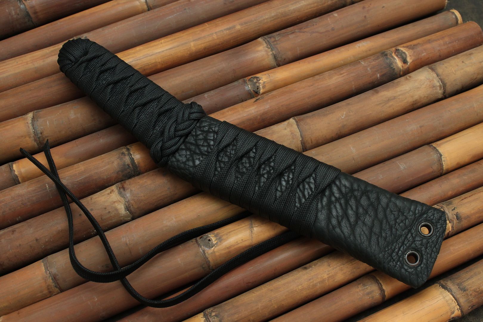

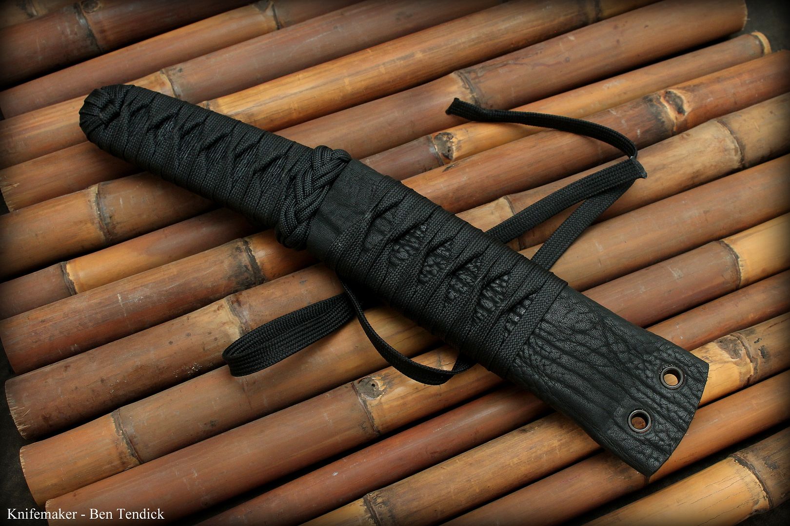

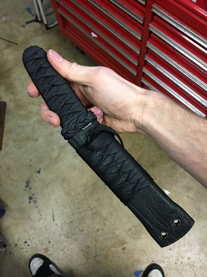

And the completed sheath. I soak the Ito in resin on the sheath to keep it from shifting around. It offers nice grip inside your belt.
I'll try and take some nice finished pics tomorrow before I get it shipped out to Joe.

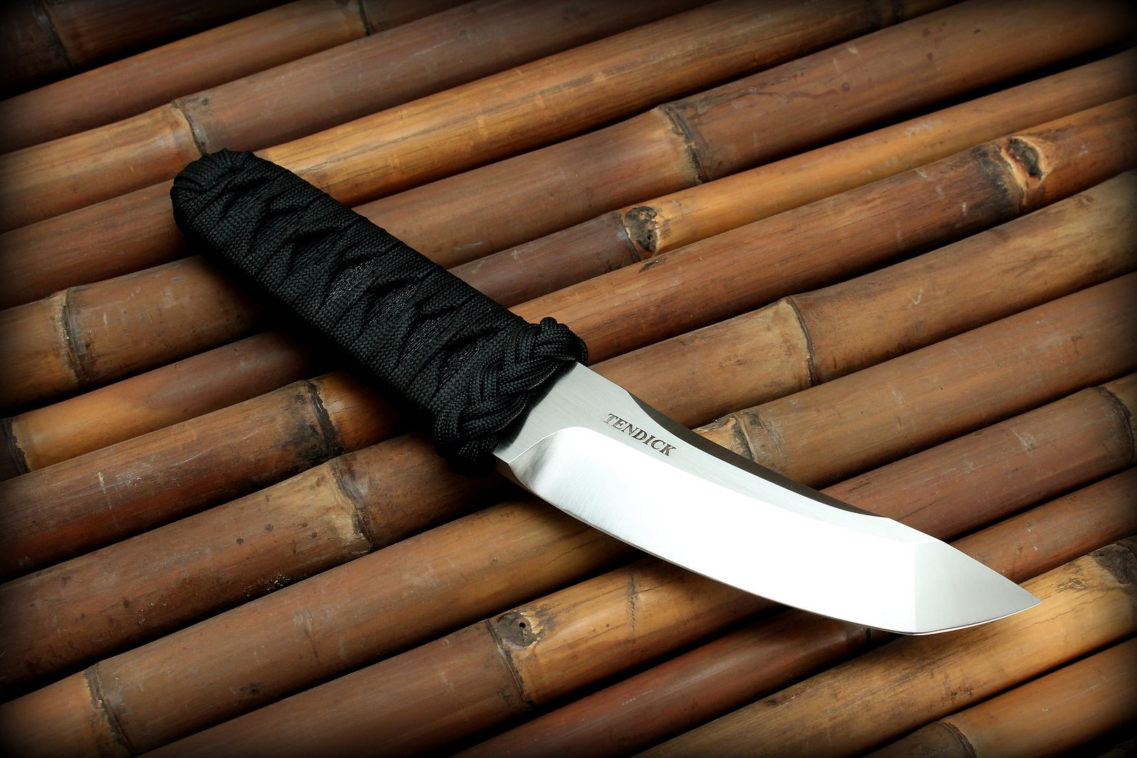

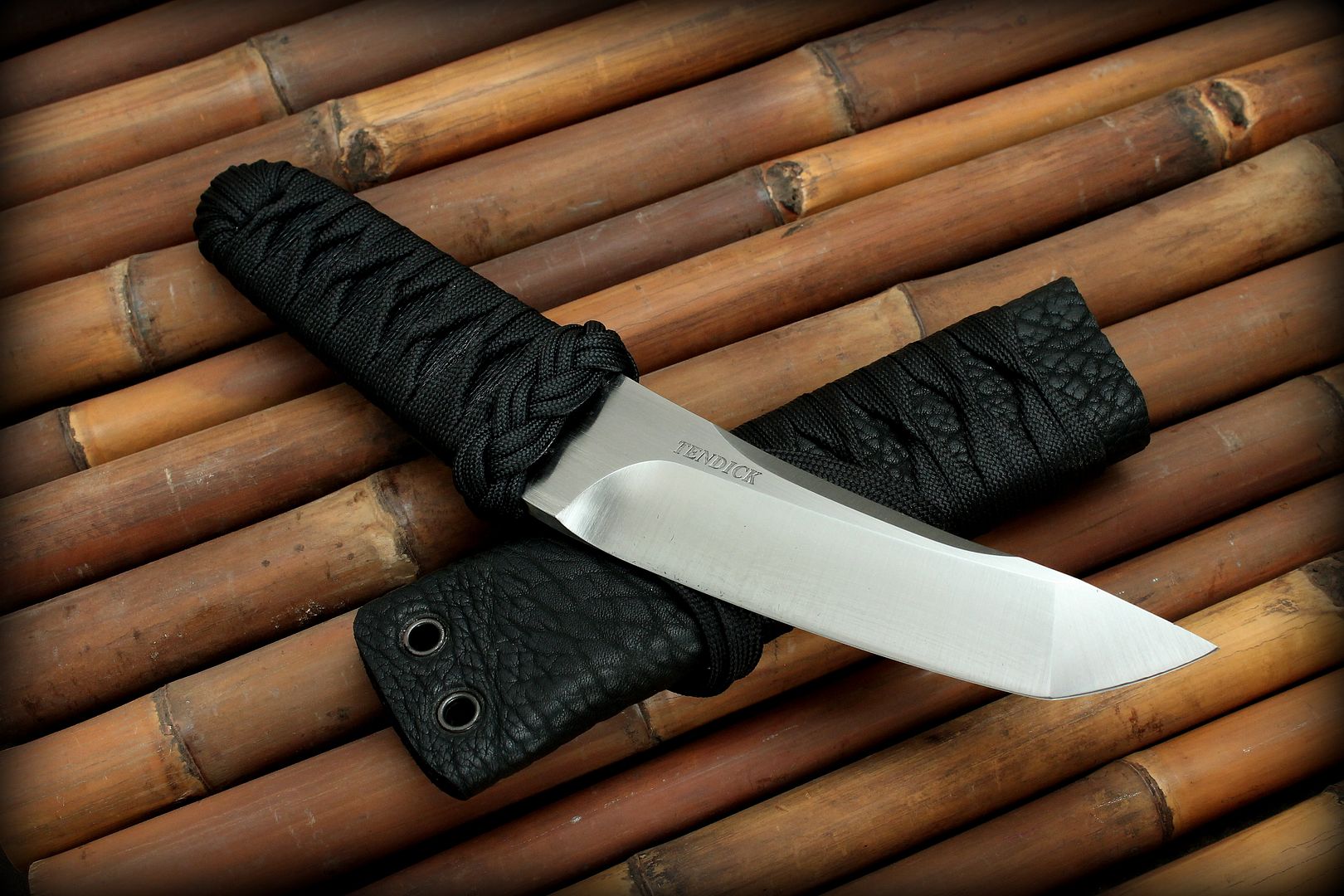

Thanks guys, here are the finished pics....
Shiny blades are a bear to Photograph. :)
Here's Joe's Version...
in the sheath...
And the version one Kraiken...

This blade arrived today
All I can say is that's it's so F'ing good it's sick :)
