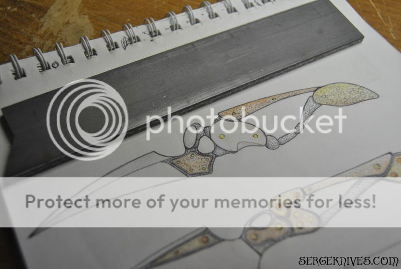

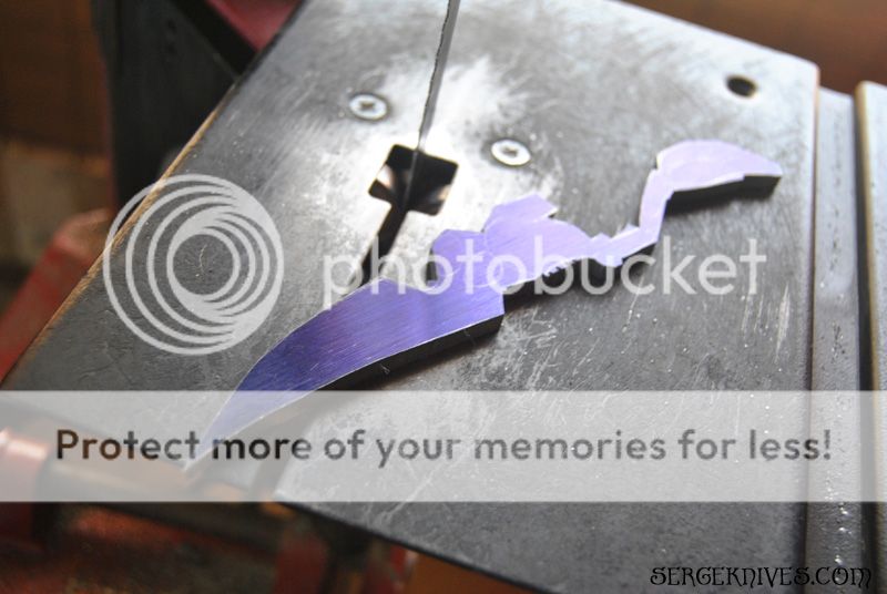

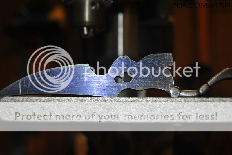

Hi all, I've decided to start another WIP knife. I drew this one up back in January 2010 and finally decided to give it a go. Obviously the knife is based on the profile of a wasp, haven't decided what materials to use for it yet. Blade is 3/16" 1095, hope you guys enjoy it!
Profiled with a band saw.

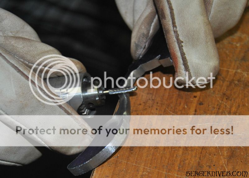

Cleaned up with a grinder.

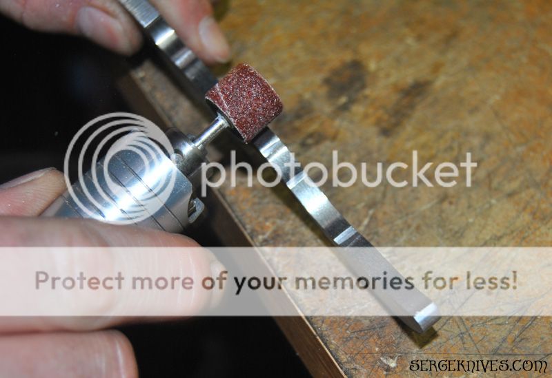

Further clean up with a rotary tool.

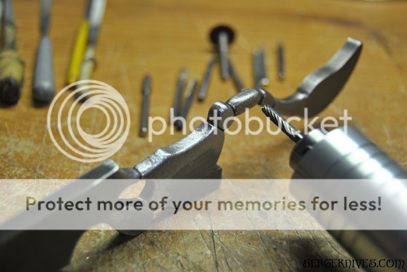

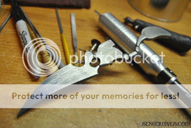

Starting to round the tail segments with a carbide burr.

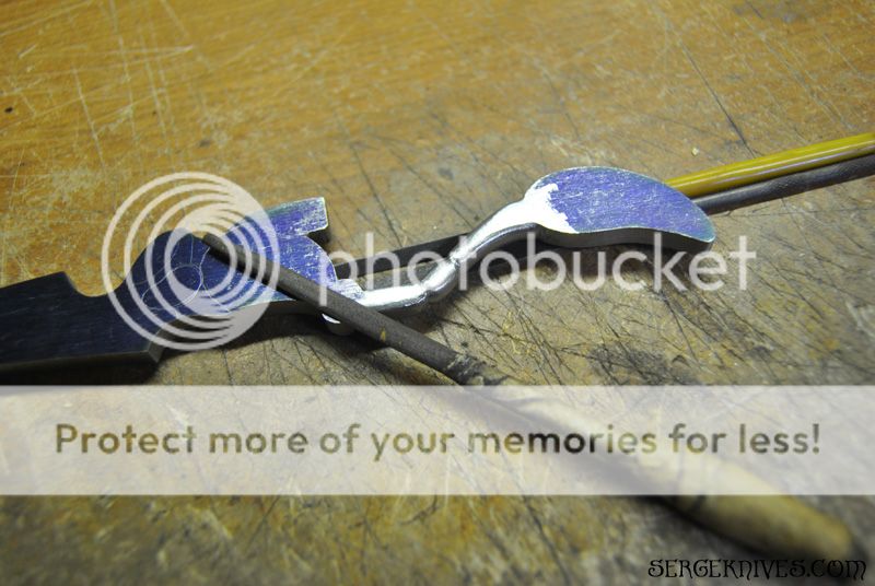

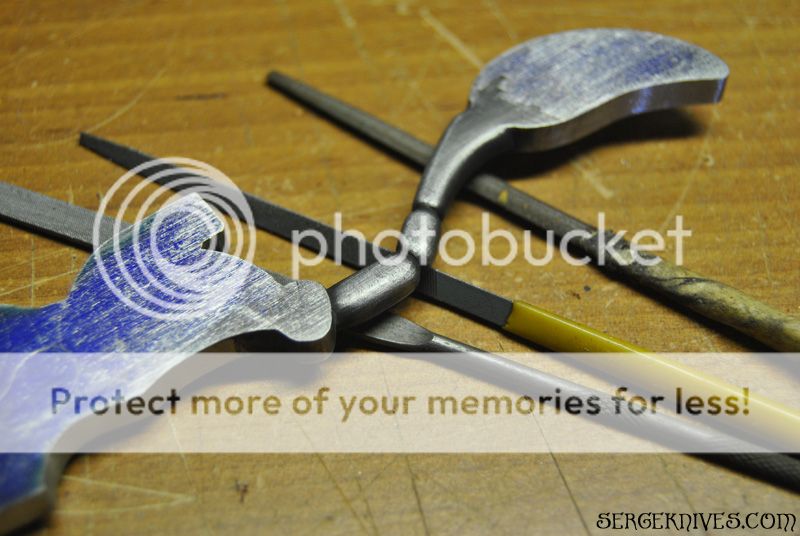

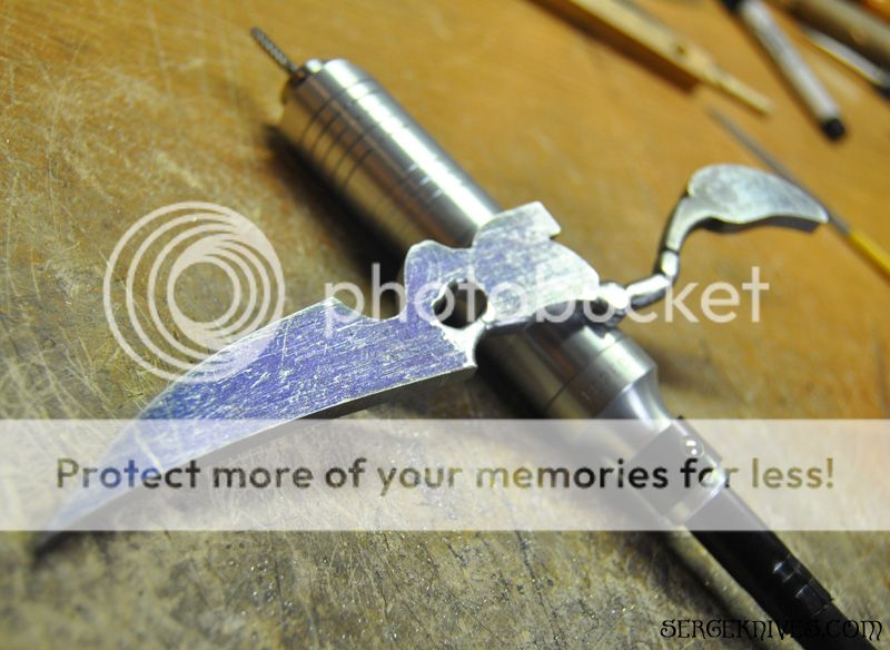

All hard to reach areas are done with a file.

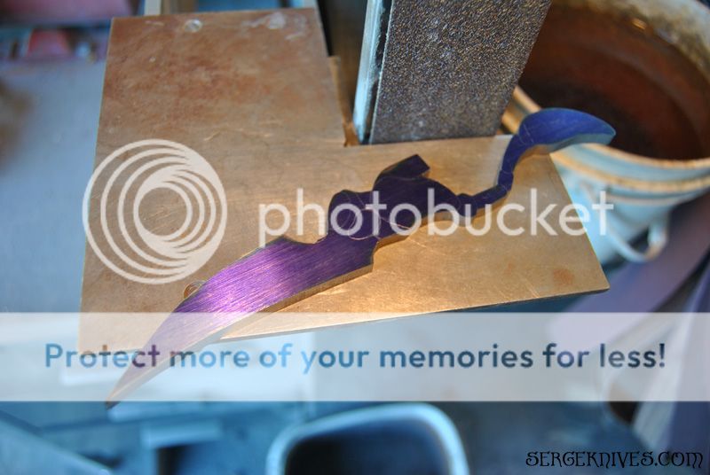

Darkened the steel to see whats going on better.
More later.

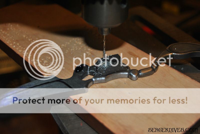

Holes drilled.
Connected.
This is where I am now. Started cleaning up some of the carved areas, head area needs more work.
More later.

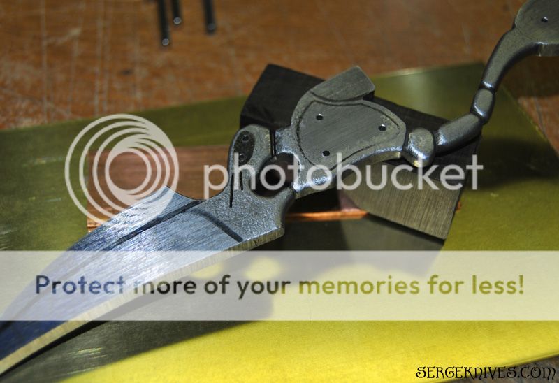

More contouring and cleaning up.
Drilling holes.
What do you guys think about carving in the two lines by the head? I can't decide whether I like it there (kind of a wicked look) or if they don't fit in with the rest well.

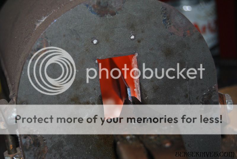

Starting on the copper wings, heating 1/16" copper sheet.
Copper flared out.

I like the lines, as long as no copper is going there...
