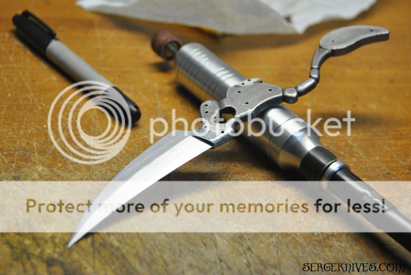

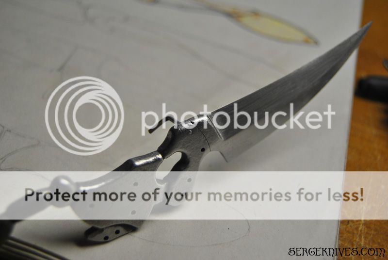

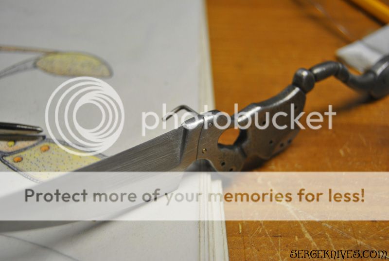

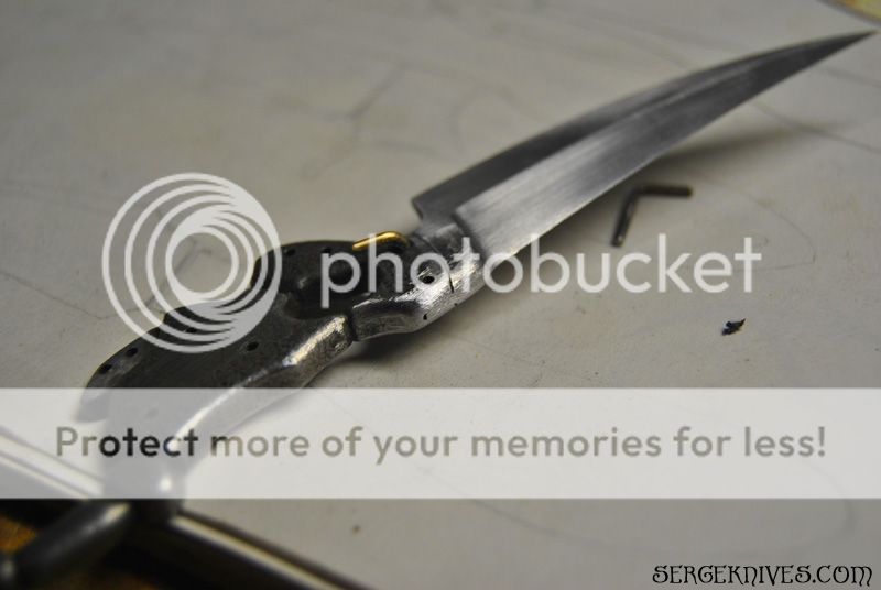

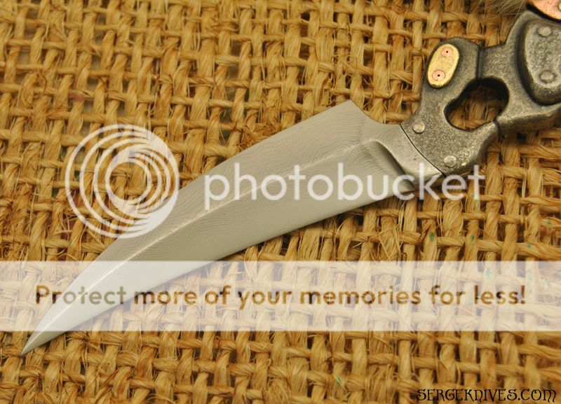

Blade ground, there is a wide swedge that is hard to see, which extends all the way to the top of the main bevel.
Blade handrubbed to 240 grit.
Countouring the "ricasso".

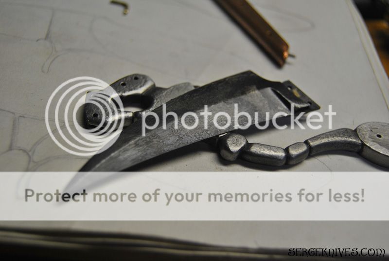

Countoured, texturing the area of where the blade meets handle.

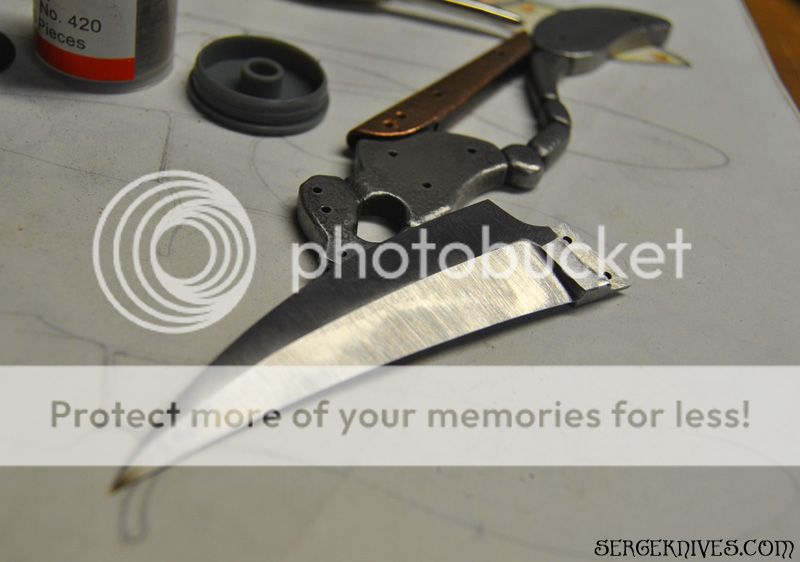

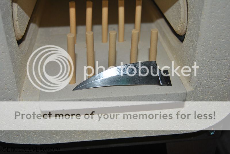

Blade quenched.
Cleaned up and ready for tempering, the damascus pattern is starting to show.

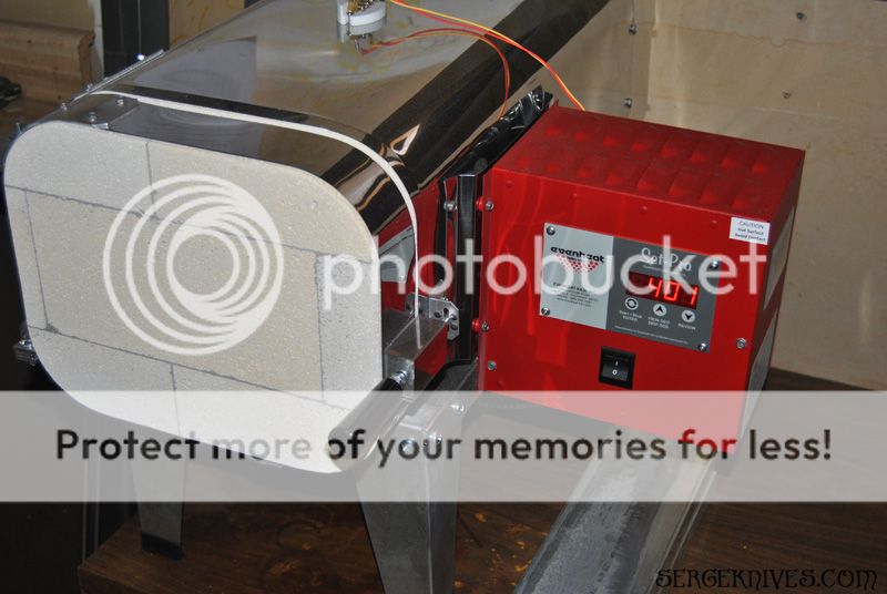

Just got the Evenheat a week or two ago, tempering the blade at 400 degrees for an hour, two times.

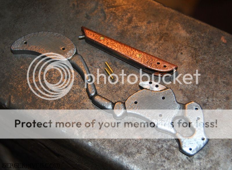

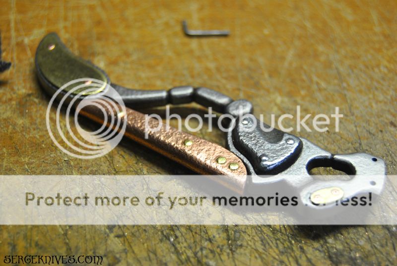

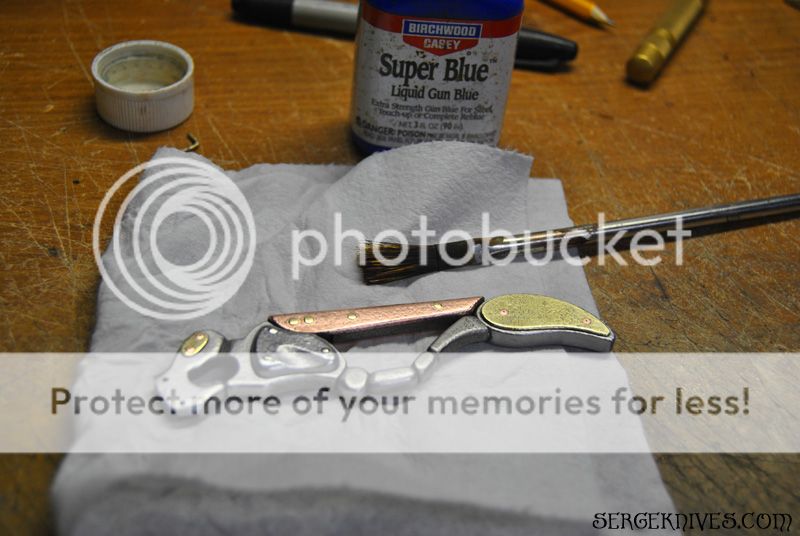

While the blade is tempering, starting to assemble the handle portion.

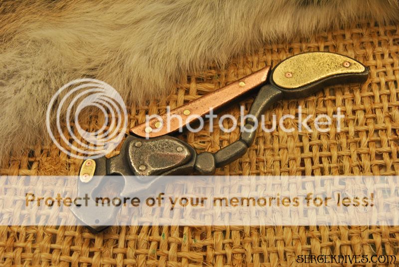

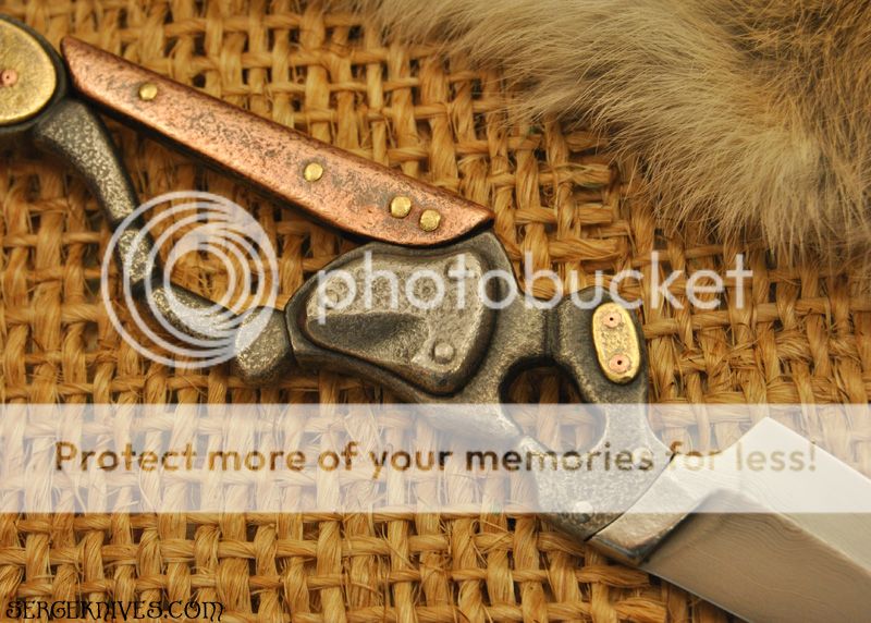

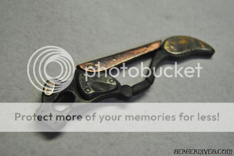

Everything peined on, textured again, and ready for antiquing.
Starting to antique.
Antiqued.
The handle is pretty much finished. Blade work tomorrow.

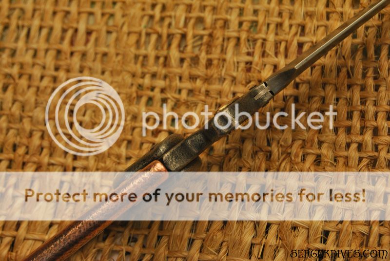

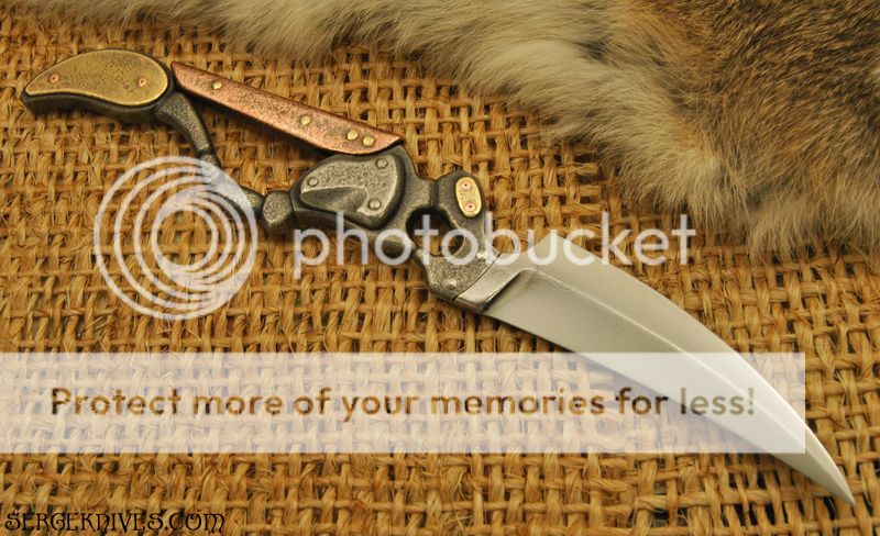

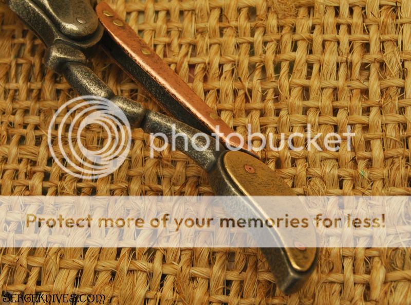

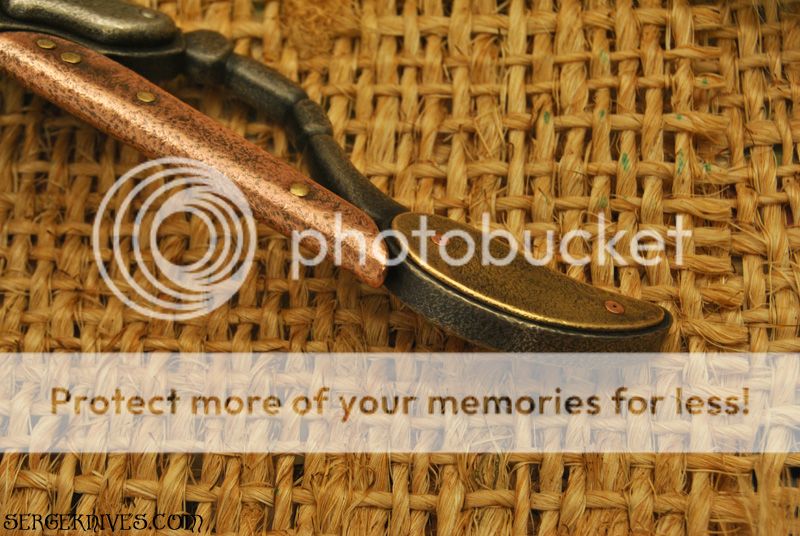

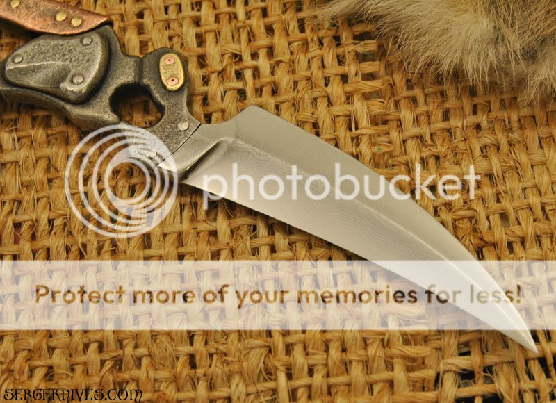

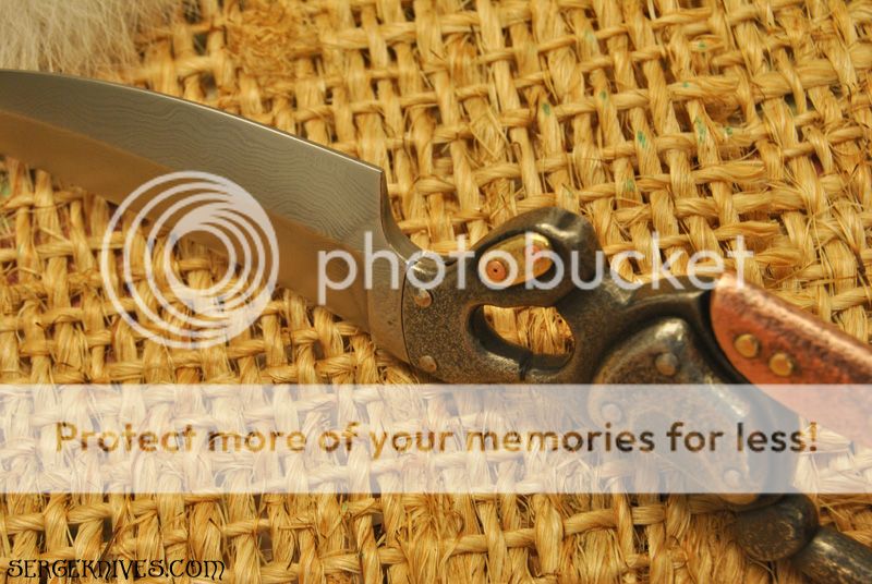

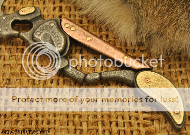

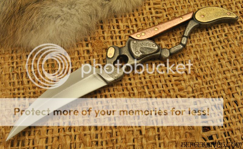

FINISHED! This is by far the most complicated project I have done to date, hope you guys enjoyed it. I still need to make a display stand for it, I'll post it here when it's done.
HA!!!!
I have looked at this thread several times, and only now, after seeing the finished knife, did I realize that the copper on the top was the wings!
Looks great!
Very cool knife.
I like how everything came together.
I think it is a great knife and a very unique piece of functional art.
