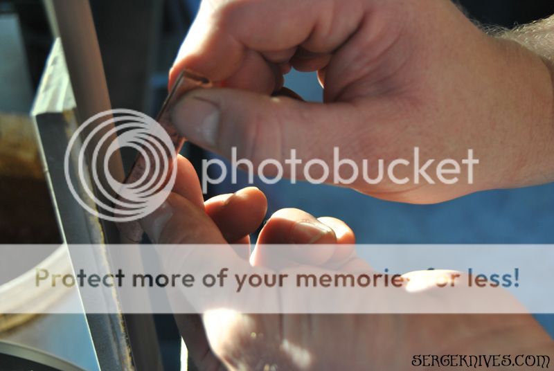

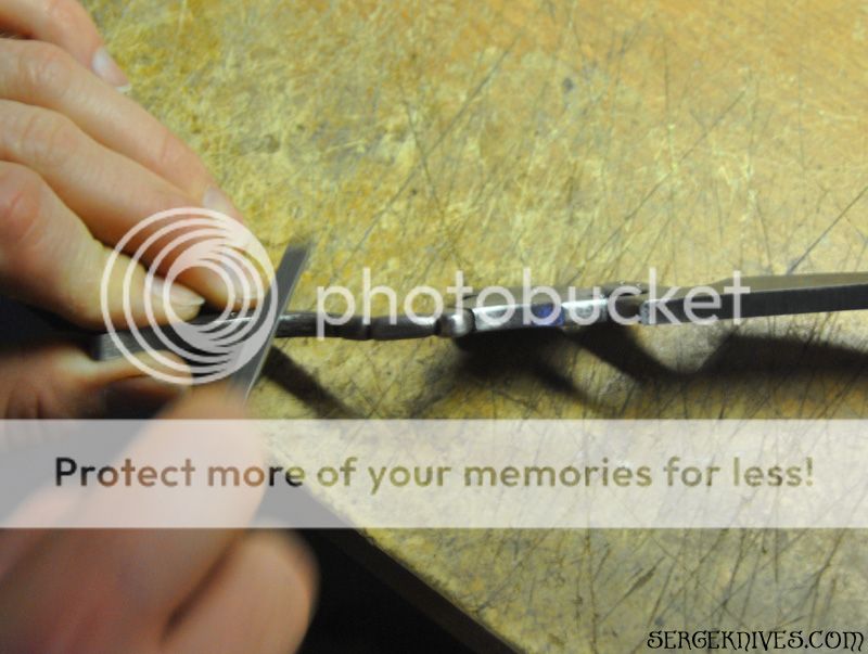

More curving of the edges with files.

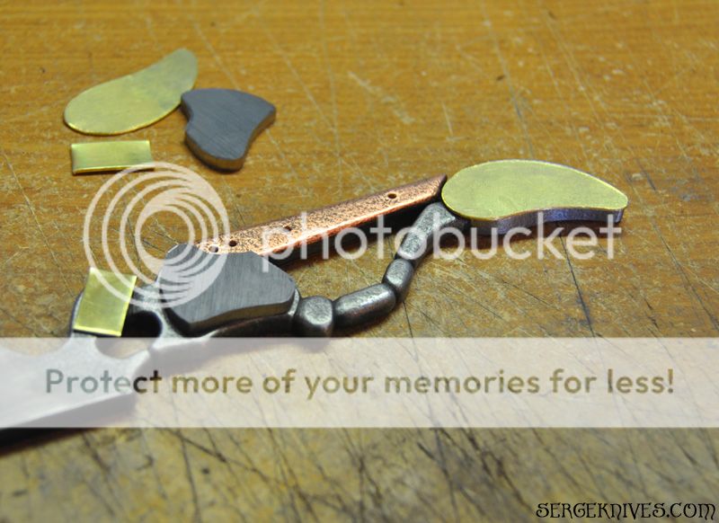

Starting on the copper wing.

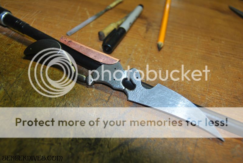

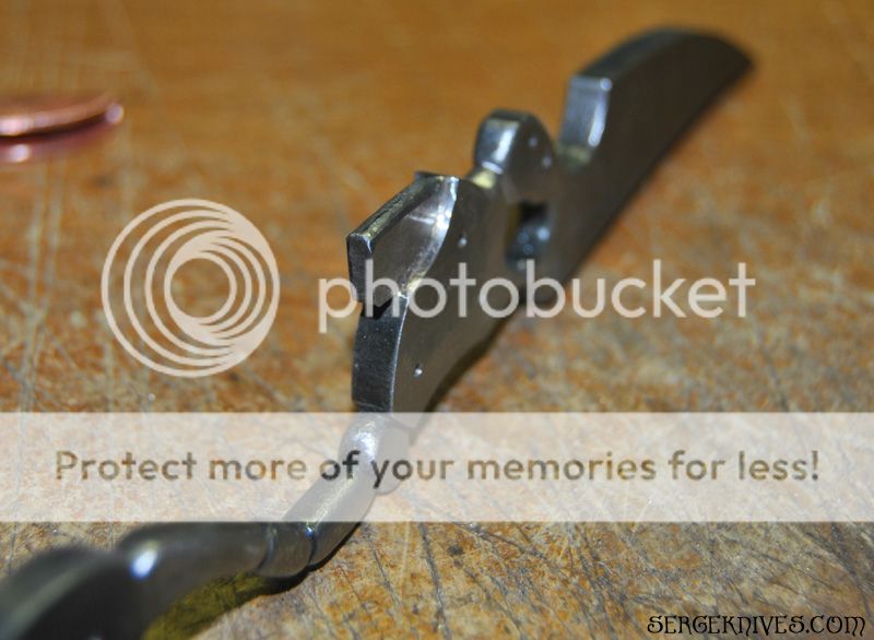

Grinding the 3/16" blade to a 1/8" for the wing to go over.
Carved in and cleaned up.

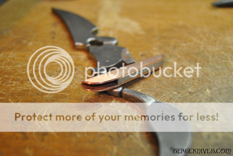

Starting to fit the wing.
Continuing to fit.

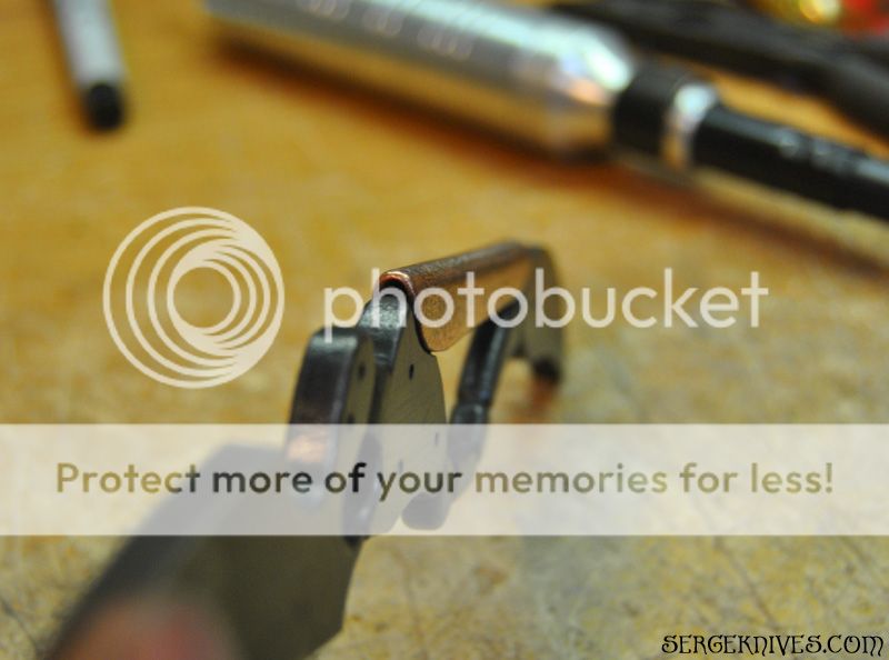

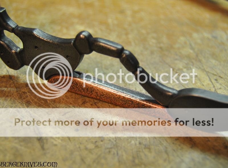

Inserted a steel bar inside the wing, so it's not hollow.

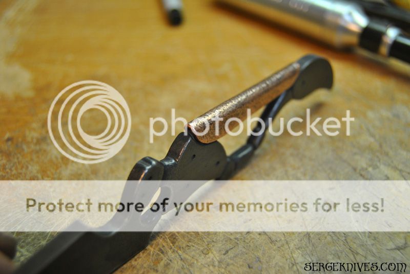

Texturing the wing.
Here's where I am now.

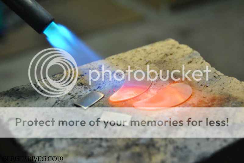

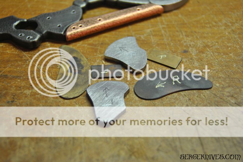

Materials cut out; brass and steel.
Annealing the brass.

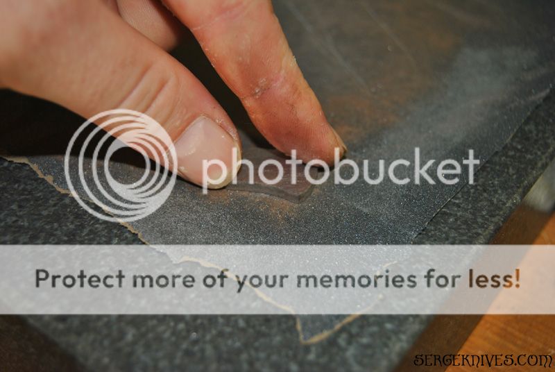

Flattening the steel on a granite surface plate.
