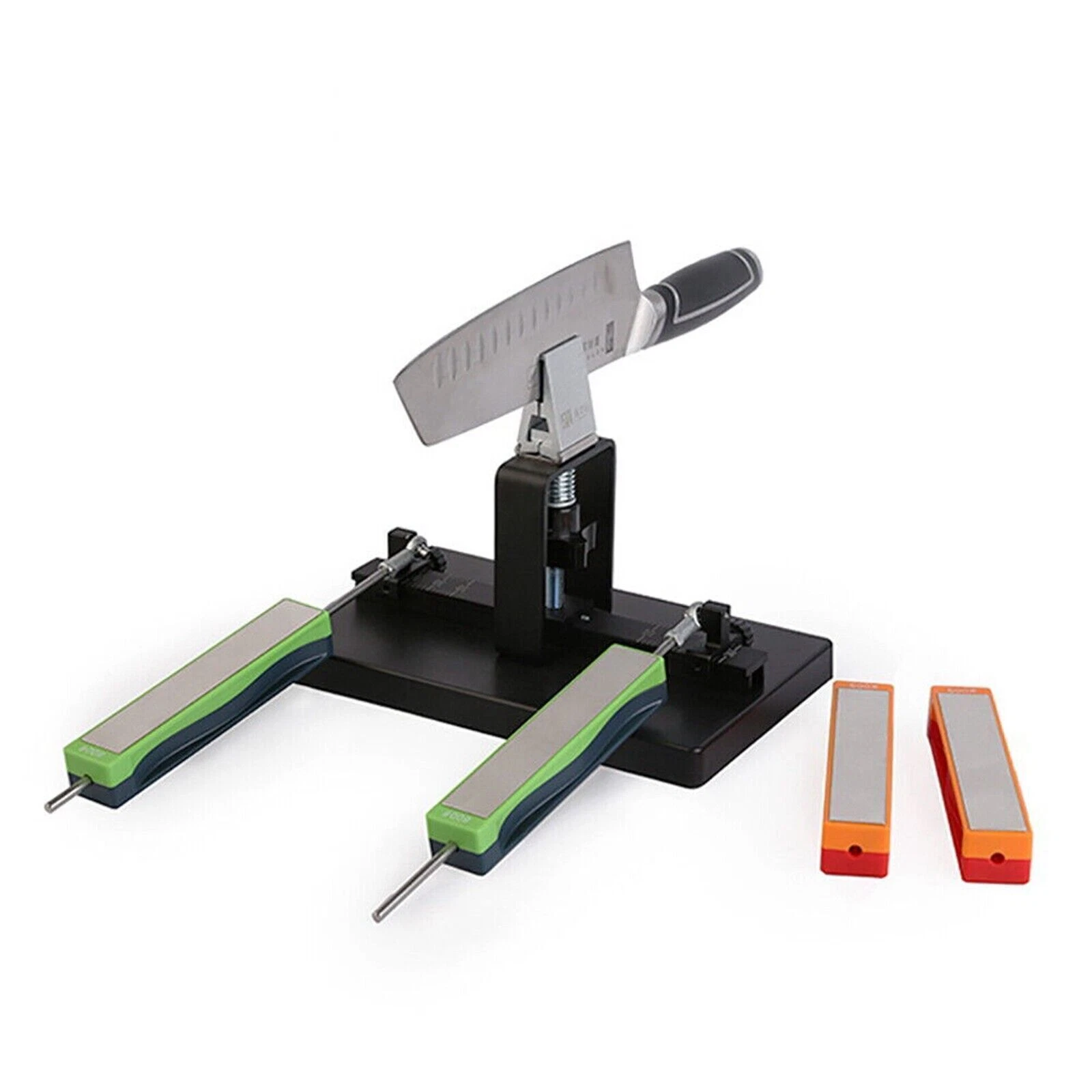

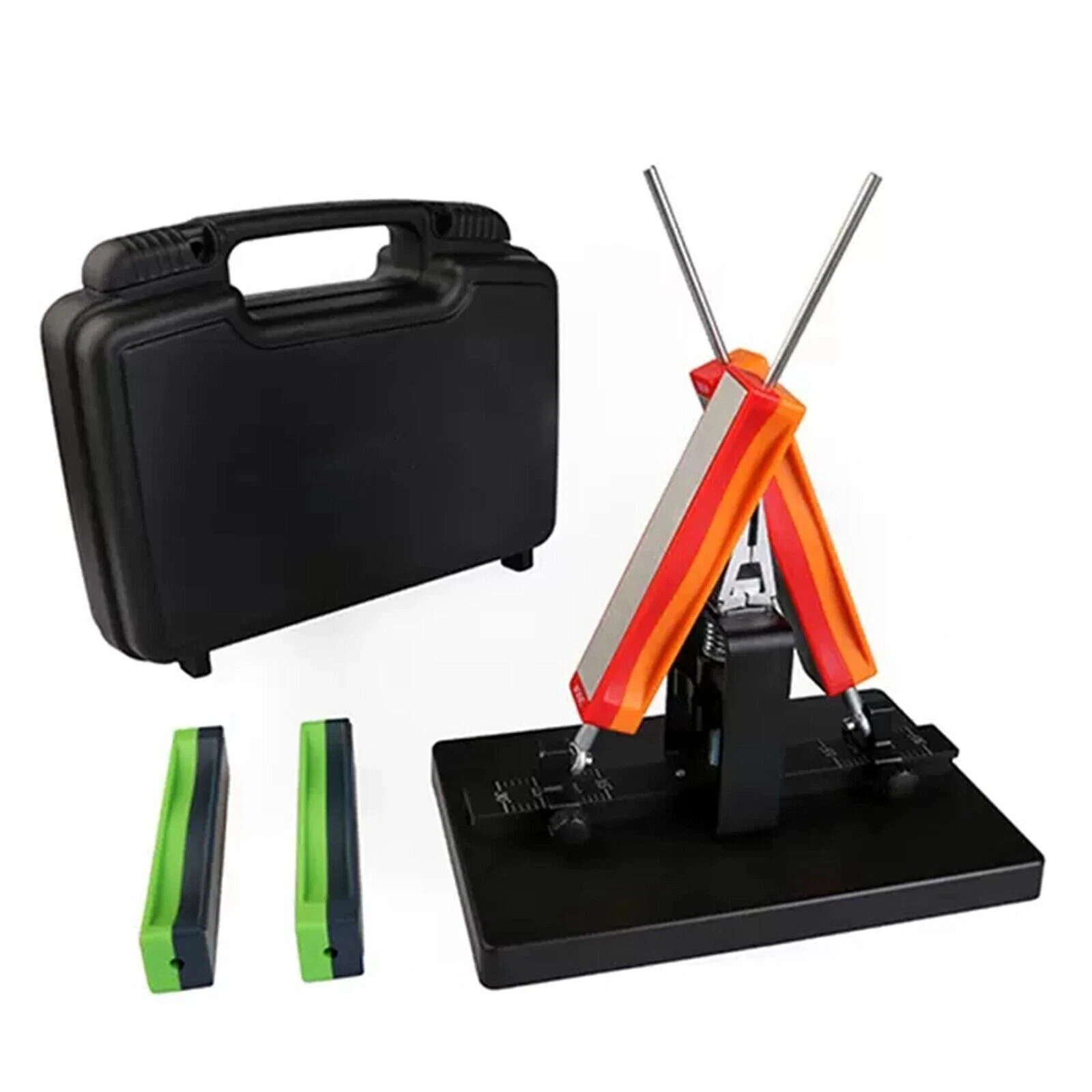

That'd be this one which I picked up for $130 off Amazon (cheaper than they are on Alibaba even)...
Which IMO is an absolutely AMAZING value. Compared to the Lansky !???
Which is little more than 2 bent pieces of metal with wholes drilled in them!??? Is just no comparison. It is NICE!

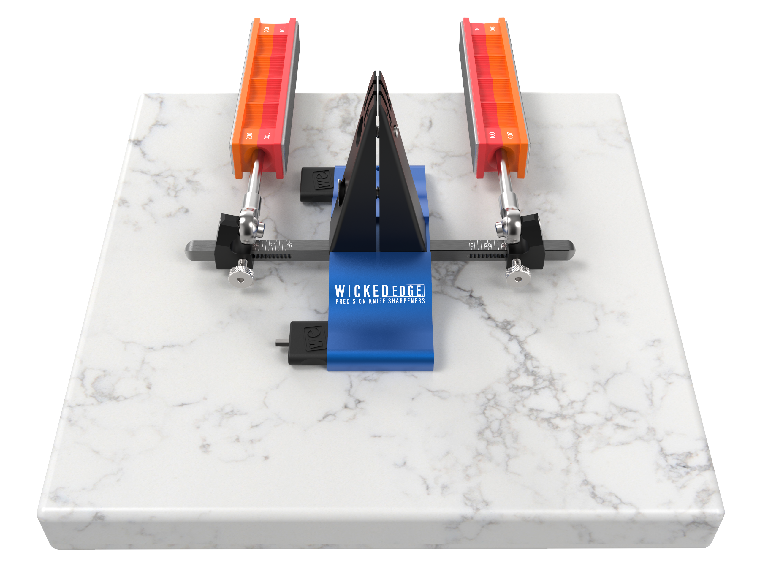

Sorry ... not the TS-prof ... the Wicked Edge
Which is pretty dang expensive ... and for which I found something that's similar in approach for a fraction on flea-bay for under $80

I have not used the Wicked Edge and I am not going to disparage it. I do get the impression it is more suited to pocket and hunting knives than kitchen knives. I have seen different techniques with it including up-down scrubbing strokes rather than sweeping along the edge.
The included stones with the Amazon sharpener look suspiciously similar to the ones I threw out. I bet you'll be amazed at the difference when you get the Shaptons.
EXACTLY. TRASH!! :)
