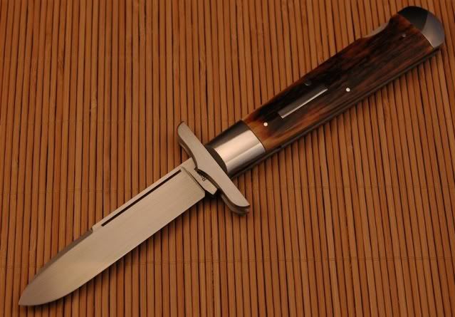

Hi guys,
Just finished hammering this one together.
Swing guard, mammoth ivory, 4 5/8" closed.
It gets mailed out to a friend tomorrow.
That's a nice one Richard! Mammoth looks great.. That one isn't
easy to make I'm sure. Not for the girls...;)
Jason
What a great knife, Richard! Nice choice of materials and forms. Very impressive!!
Is there anything you can't make??:eek:
I remember that "three-thick" fondly; mammoth also I believe!

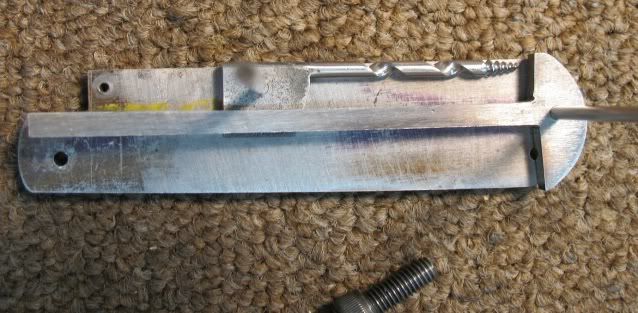

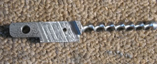

Getting started on a Horseman's knife.
First up is an awl. It's pictured on the pattern so you can see how it fits in the back of the knife.
Next is a partially done corkscrew. I still have to trim down the tang, and cut the tip down to the right length. The big hole on the back end is so I can hold it while I file the groove.
All the grooves and the threads on the awl are hand filed. I'll try and post pics as I get more parts made.
Thank you for posting your WIP! This is going to be a fun build to watch! The awl looks like it also works as a gimlet -- very cool!
I'm looking forward to this one too! Thanks for taking the time to share it with us, Richard.

Hey Ken. Everything slows me down. These were both the second attempts. The first ones were okay, but not juuuuust right. Working on the leather punch earlier this morning. Right now I'm off to move some cattle. Running out of water in the pasture they're in. Keeping my fingers crossed and hoping it starts raining. :)
