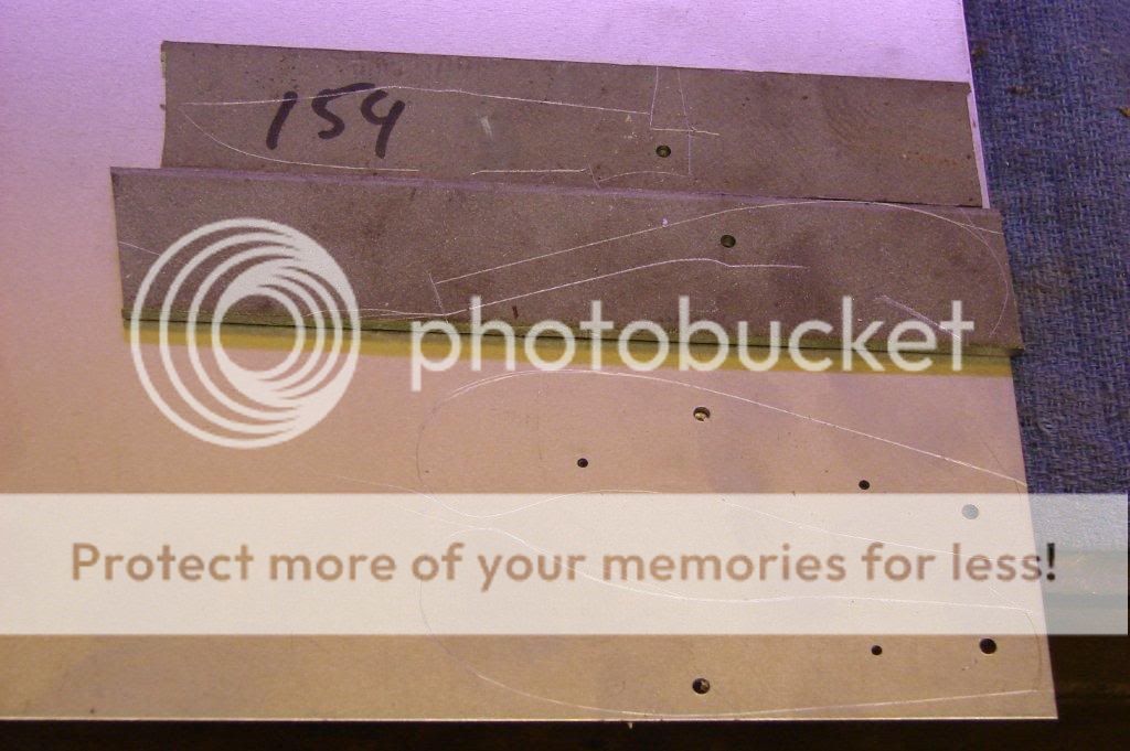

I got word yesterday that Rick is starting on my Saddlehorn!!!! :cool:
We decided that I will post some progress pictures for everyone to see.

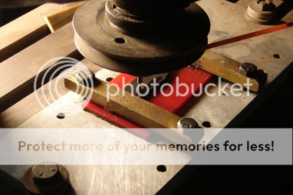

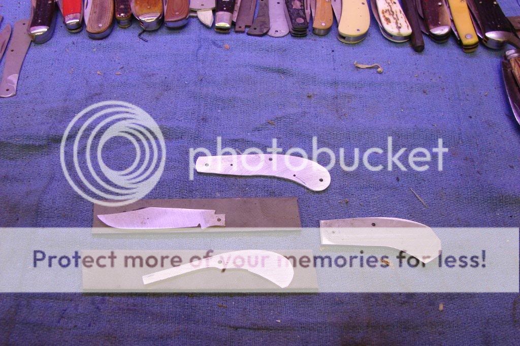

This is the 3 5/8 Saddlehorn pattern laying it out on 154cm.
Clamped the pattern to 154 and just drilled holes through it.

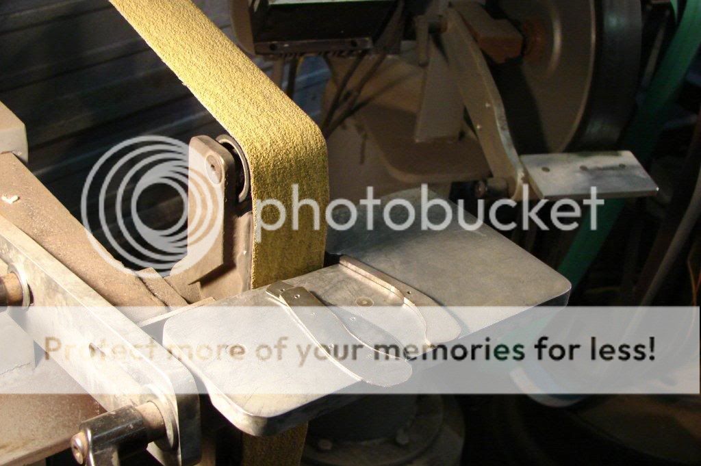

Cut out the steel on the band saw and now just profiling down to the line.

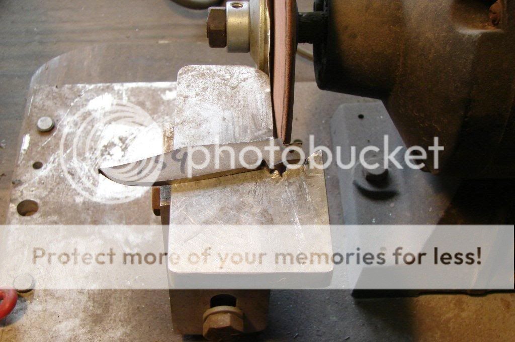

This is how Rick cuts the lock-up and choil on the blade.

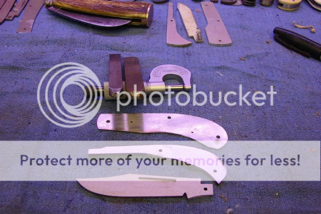

Surface grind spring and blade making sure everything is flat and within .0002 before heat treat.

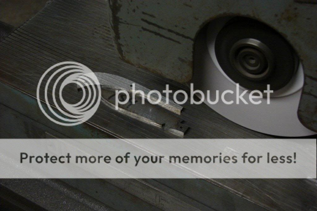

Cutting the long pull in the Saddlehorn. This machine started life as a deckel mill. Rick took three machine and made one. Know it's Menefee made.
