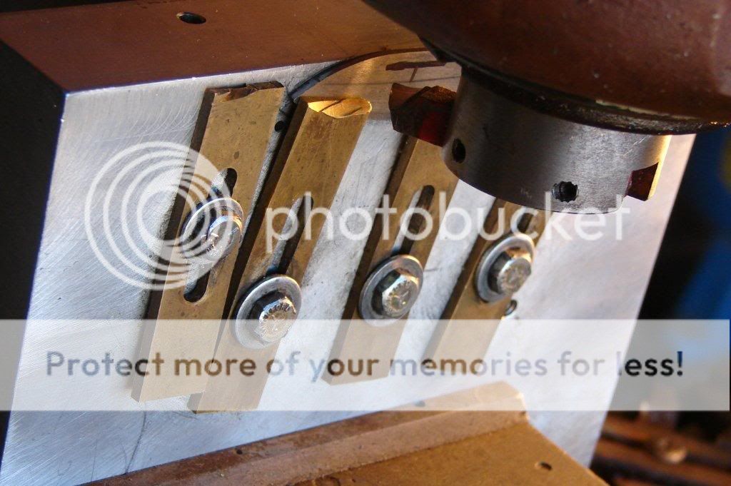

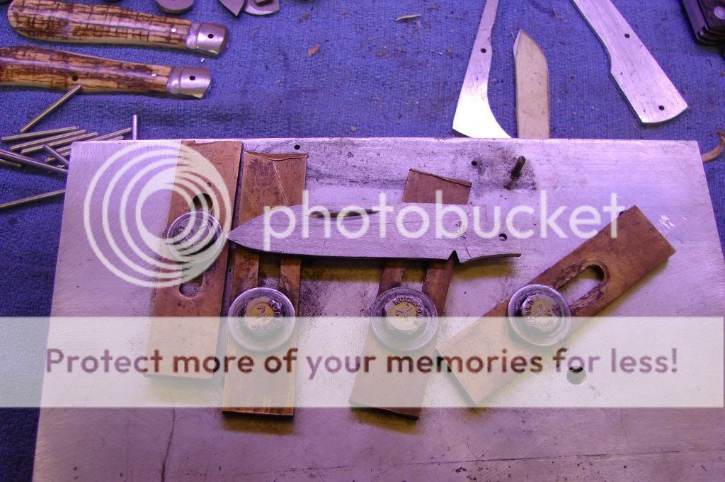

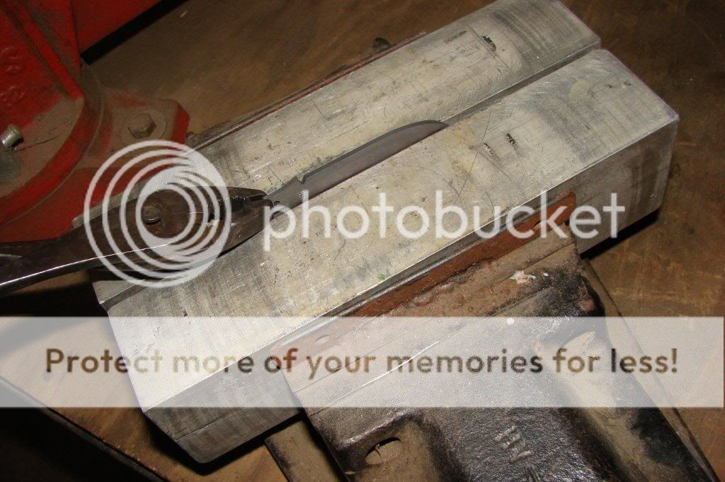

Rick sent me some more WIP pictures of various knives.
Cutting a nail nick in a modified wharncliffe also known as the Zulu.
This is how it looks after cutting.

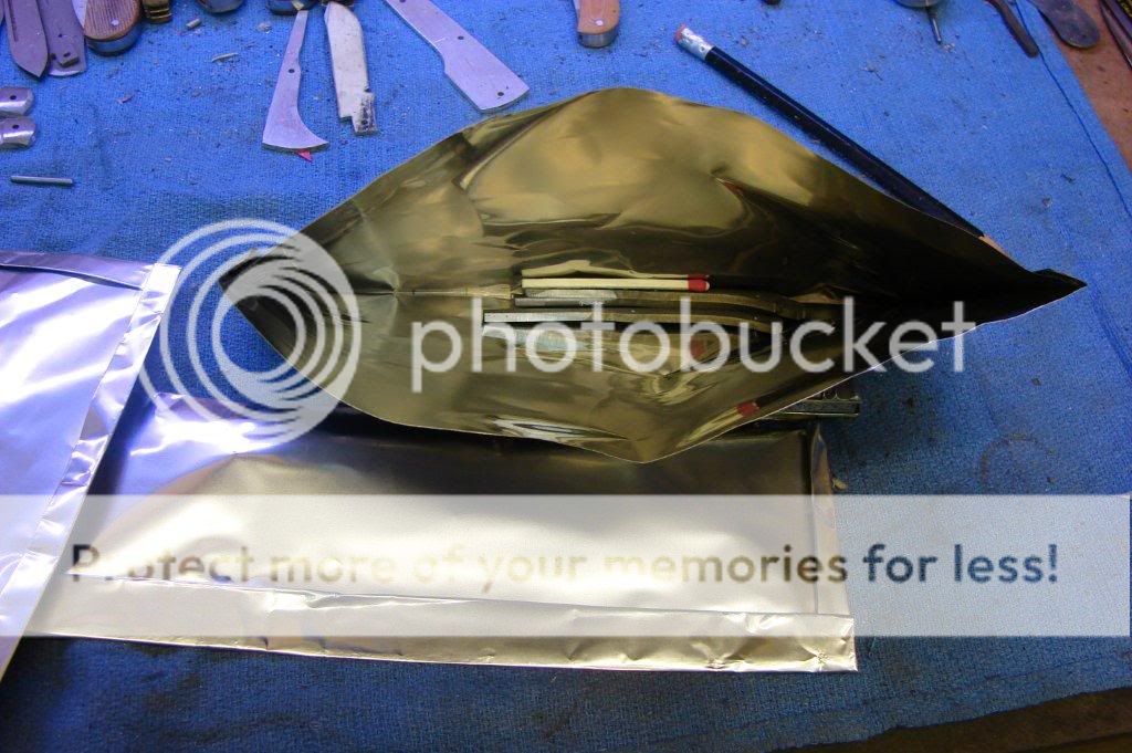

Wrapping with stainless tool wrap before heat treat. Keeps O2 out so you won't get as much carburezation on surface of the steel.

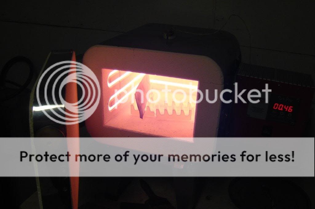

Heat treat brought it up to 1250 degree for stress relieve then to 1950 for 30 minutes.

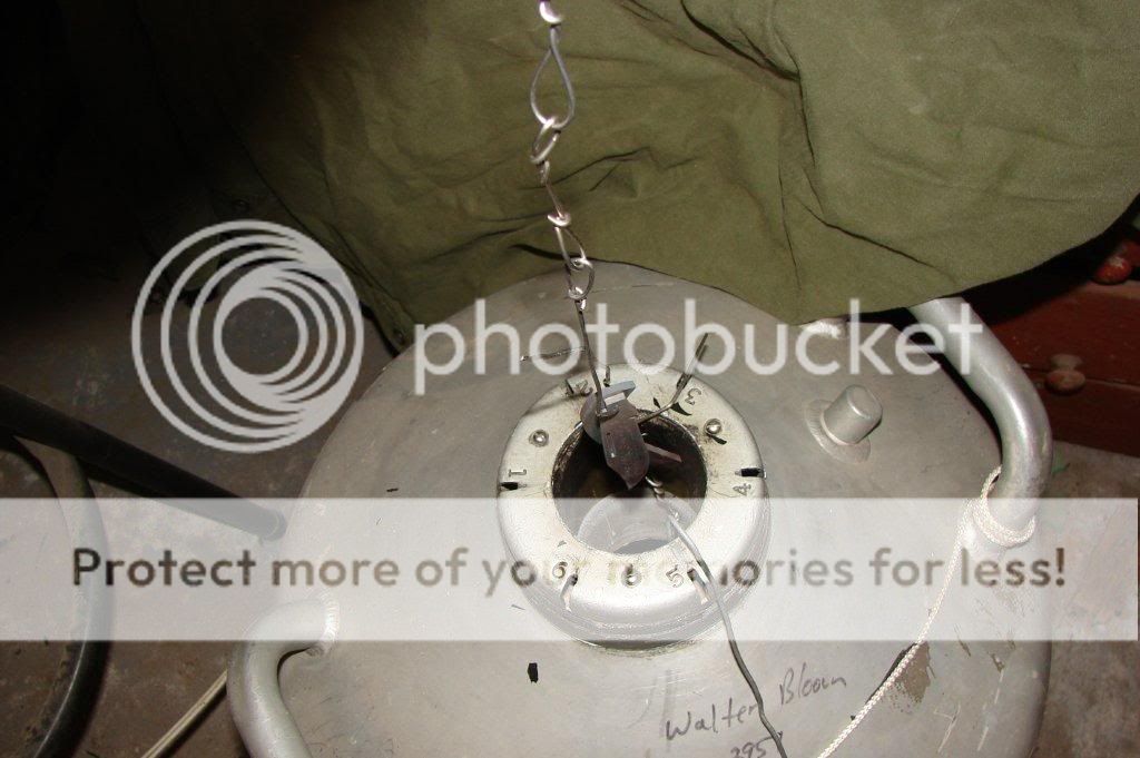

Going into liquid nitrogen for 6 hours.
