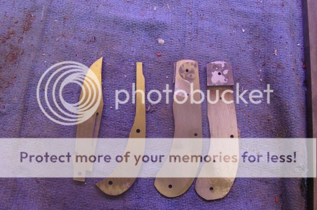

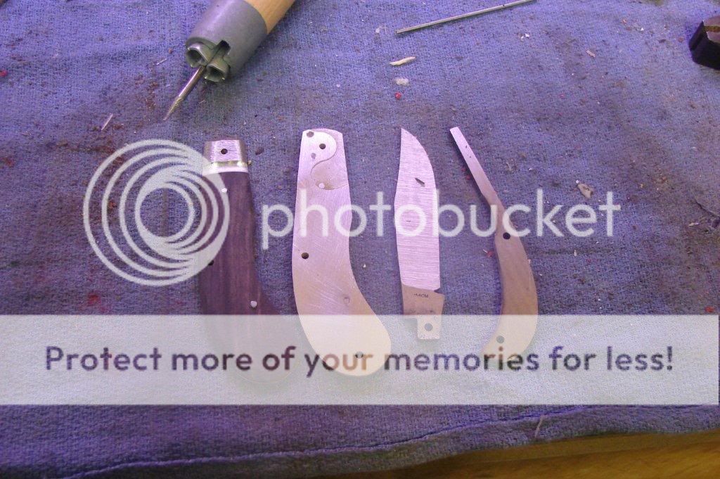

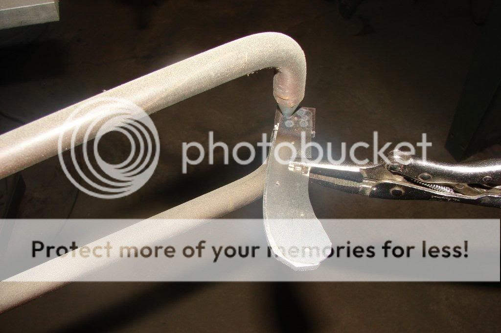

Spotwelding the bolsters
Relieving the liners
Ready to flute the bolsters and put handle on

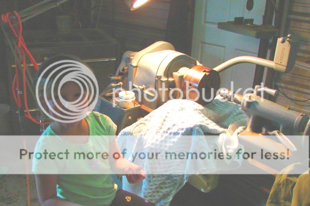

Both of Rick's little girls help in the shop. When they were small they slept in a play-pen. Here's Rick's youngest is inspecting bushings for shadow patterns.

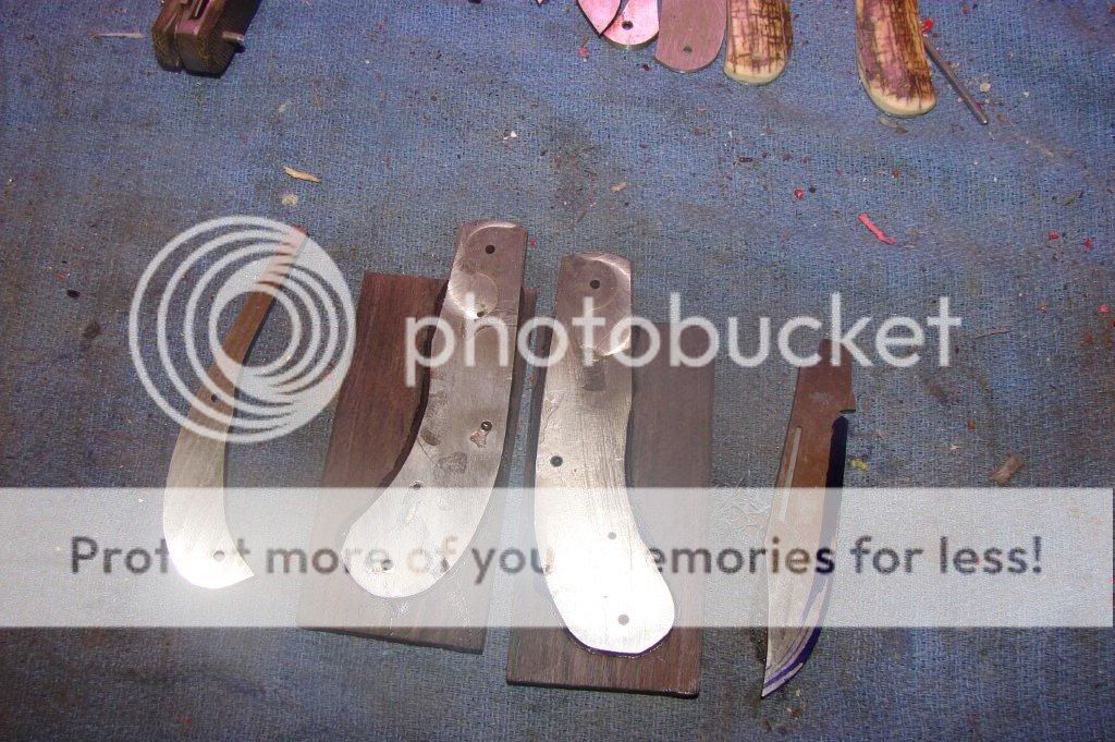

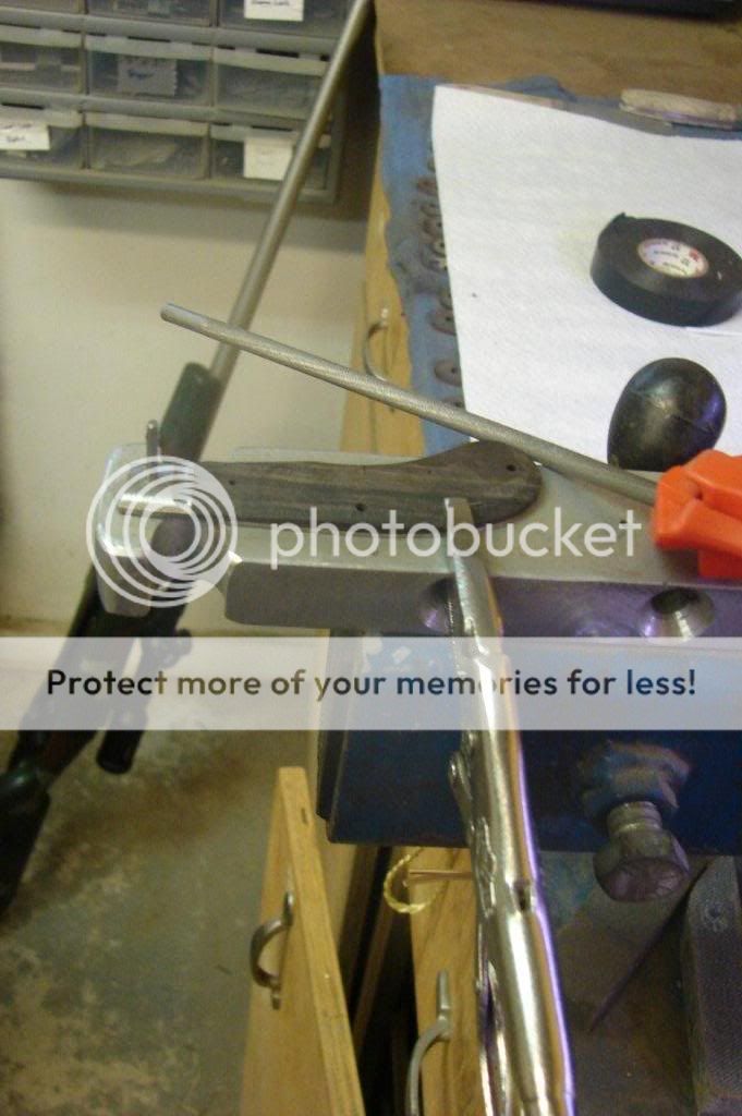

The African blackwood scales put on.
Marking the center line on the blade to be ground while waiting for the glue to dry.
Fluting the bolsters.

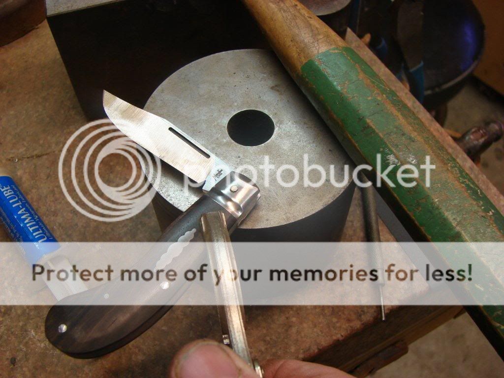

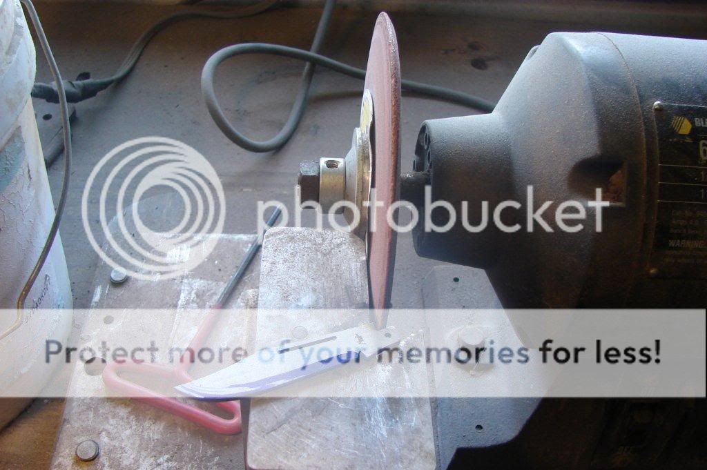

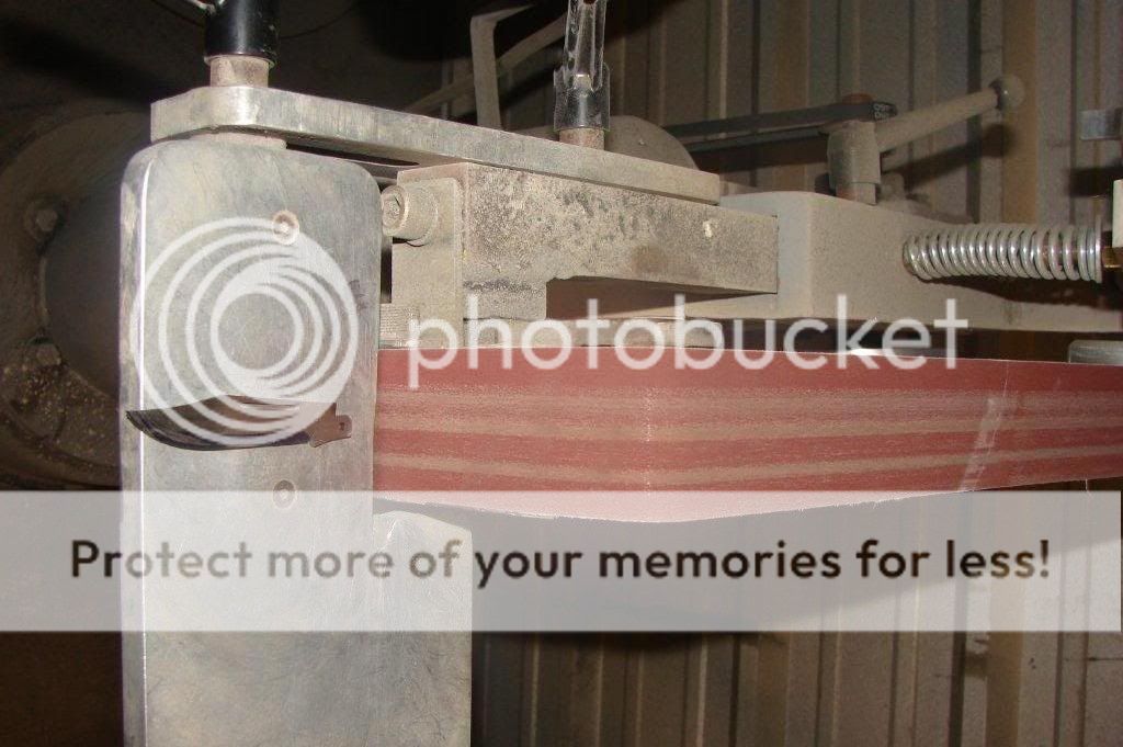

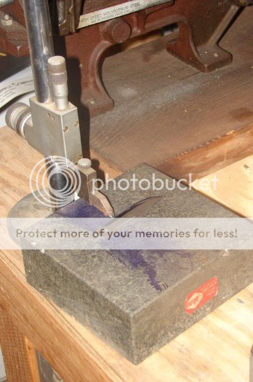

Rough grinding the blade. The most important part of the whole process. From edge to spine the blade has to have a smooth taper. Most knives cut; however, to get true cutters they have to be ground thin and tapered properly.

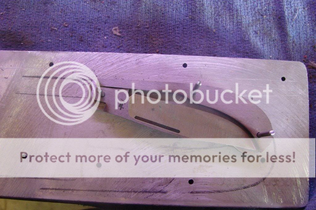

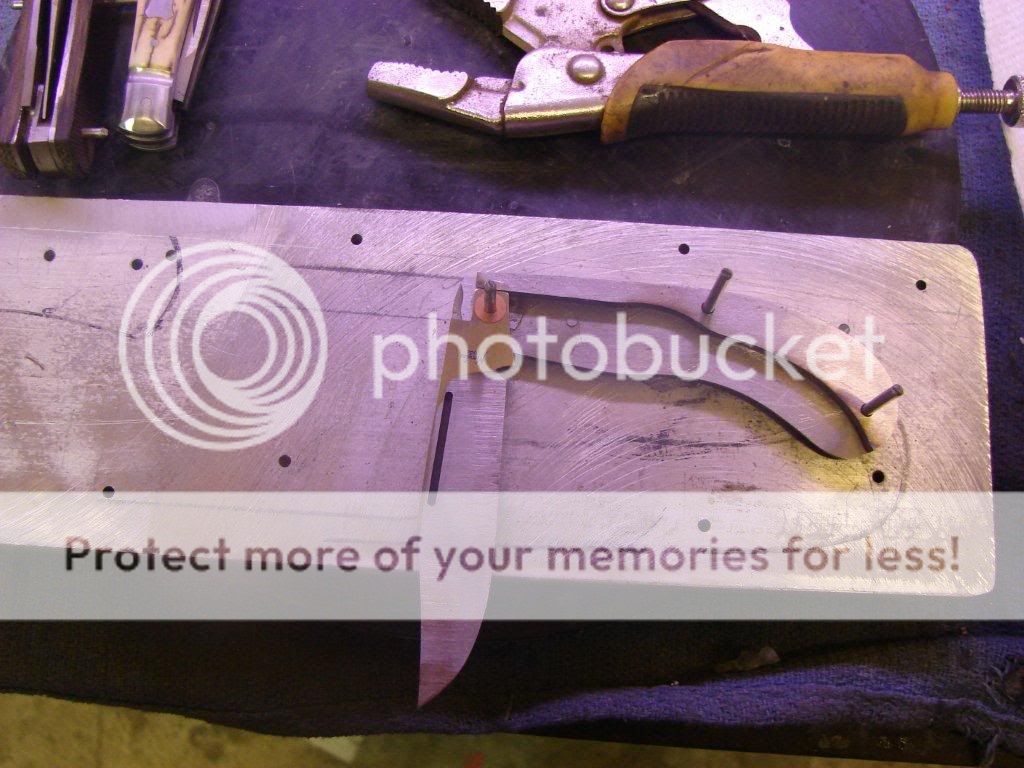

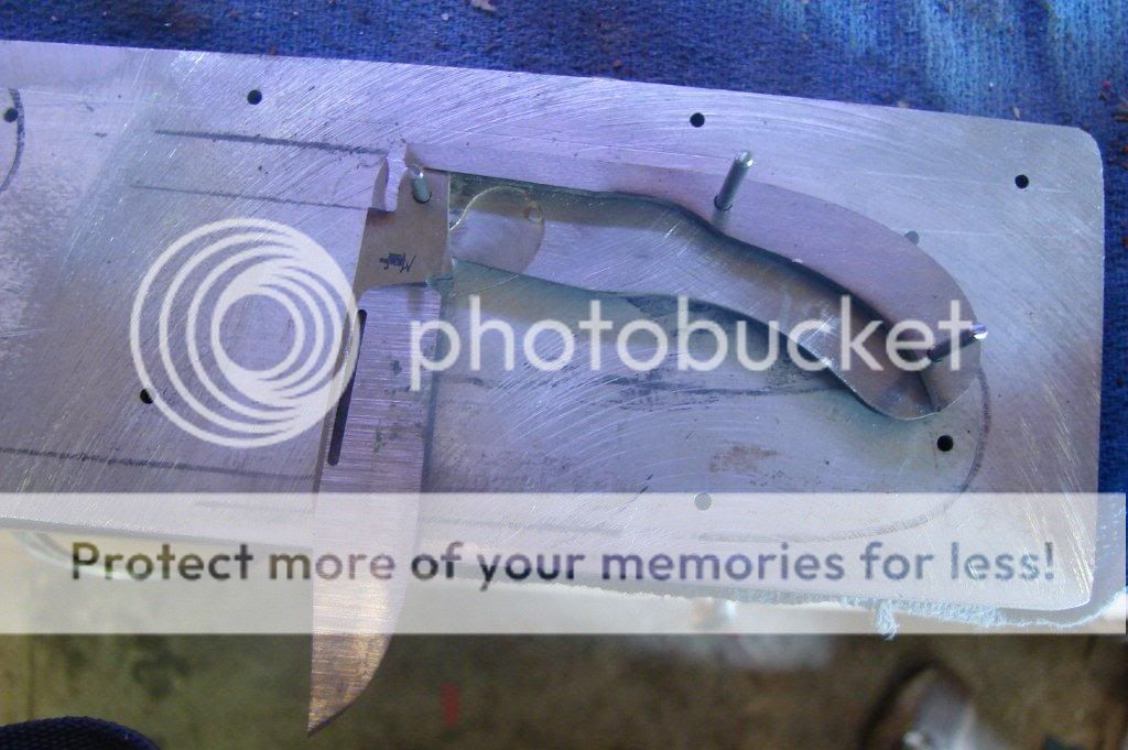

Setting up on bench block, set tension and all postions are flush.
Next set.
Taking a little off the back.
Taking a little off the kick.
Everything is timed properly. Putting pins in handle a fixing to cut the shield.

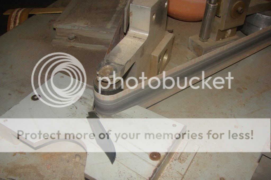

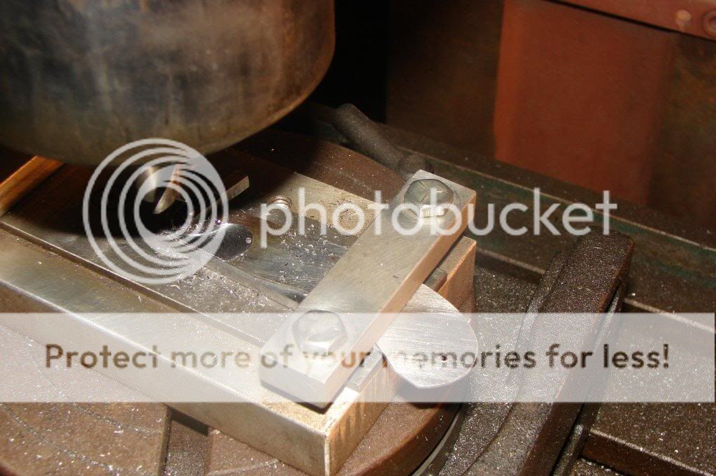

Getting ready to cut a shield out of .100 ss. Rick made this machine out of three milling machines just for shield inlay.
Milling shield cavity .100 down snap fit.

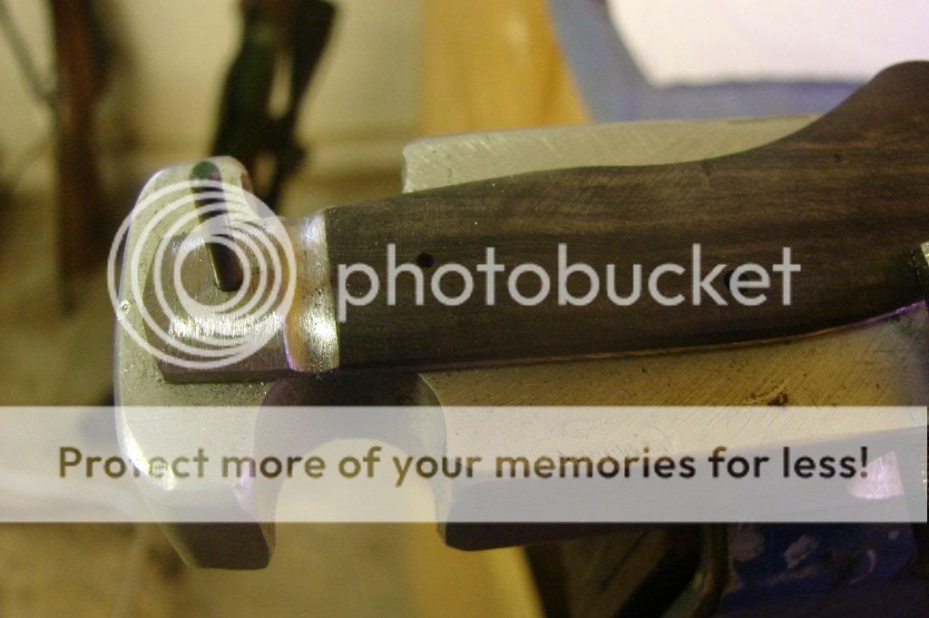

Rick finishes the inside of the knive then he puts it together. Then he finishes the grinds and the outside of the knife. This is backwords from most of the other makers but this is what works for Rick. He use .005 phos. bronze bushings on both sides of the knife. This is how it looks before he beats it together.

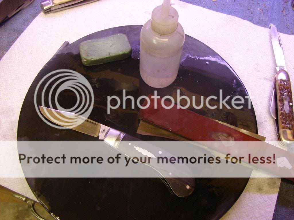

Rick sands the handle from 360 grit all the way to 5000 grit.
