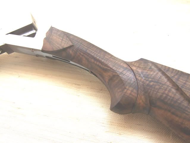

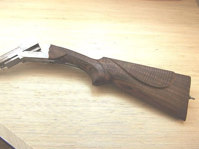

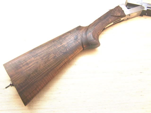

Well, Been busy on my rifle since Blade show. I "stole" a few days after the show...feel guilty as hell, but a guys go to have a little fun.
The stock is sanded to 220 grit with a couple of coats of linseed oil. It will require MANY more hours of finish work, not to mention checkering. The wood to metal fit has a couple of spots I can't make perfect, but the are very small and will fill with epoxy bedding. I may glue some slivers of walnut in and refit those areas though. The drawbolt sticking out th eback will be recessed, just not sure as to what style of butt I want. I LOVE skeleton plates, and will more than likely go with that. I didn't want to drill too large a hole, or find that I need to remove more wood to balance the gun so I will wait until I have the action shaped and the barrel/forend completed.
It fits me perfectly, the styling turned out better than I thought it would look, and the wood looks incredible. I am a happy camper so far. Let me know what you think!!
