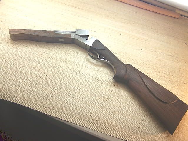

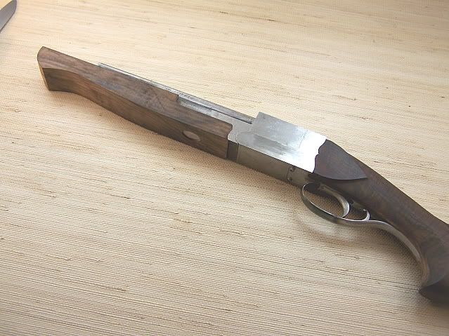

OK, here are a couple more pics. I have the forend wood mated to the forend iron, am working on the Anson latch to hold the forearm on, installed the trigger guard and have the extractor in, but not quite fitted enough to close the action with it in place. It REALLY is time to order the barrel now :-)

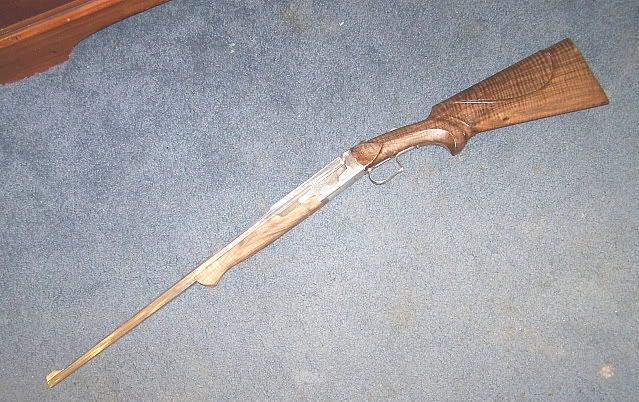

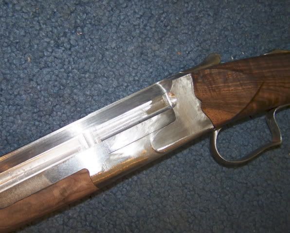

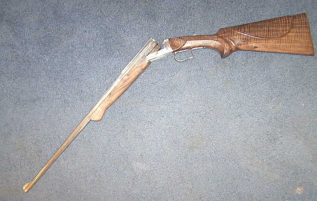

I had a local machine shop thread my monoblock and barrel. They did a very good job as the faces meet tight enough to hide the seam ( 1" 20 threads if you were wondering) I spent the weekend machining the barrel from the 1.25" unturned blank....A LOT OF MACHINING) and fitting the Anson latch block on the bottom of the barrel. The forearm fits nice and snug and there is no wobble at the hinge when the action is open. It isn't too tight either, the barrel gently falls open when the top lever is released. Now all of the mechanical functions are complete with exception of refitting the extractor where the barrel comes through to the breach. I do need stronger springs for the locking slide, but that is an easy adjustment. The barrel needs to be crowned and the chamber reamed and it is ready to test.
These pictures aren't too great, will shoot more quality shots when the action is polished more.
