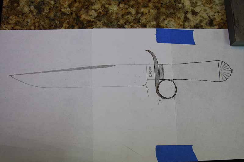

Here is the sketch of the knife I'm going to make. It will have a 9" Four Bar Explosion Damascus blade. Premium Blue Mammoth Ivory Handle with Explosion Damascus fittings. It will have Stainless Steel liners with Vine and Thorn file-work. The ring guard will also have clam shells. This knife will be my first take down and will have a regular clam shell you can interchange with the ring guard clam shell. This will also be the first clam shell I've made.

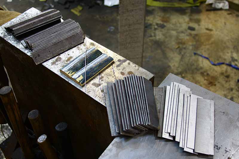

Here are the materials to make this knife.

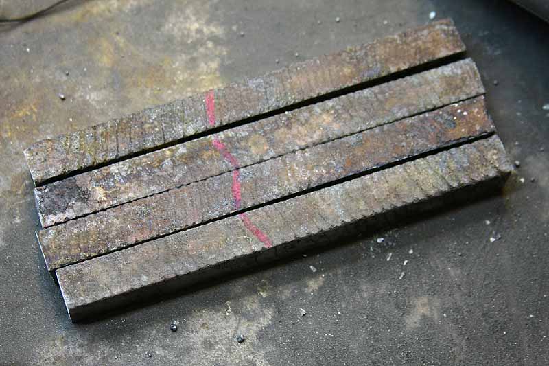

Here is the 1080 with the scale removed.

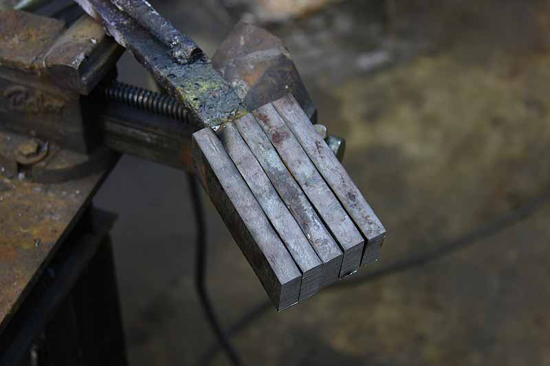

I have the billet ready to tack weld here.

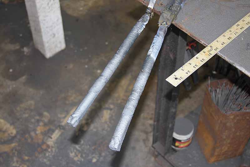

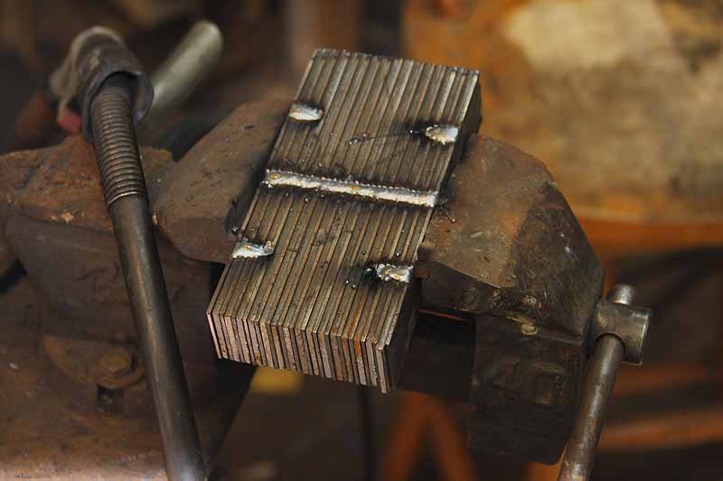

Here I've tack welded the end of the billet.
Tack welded the side.

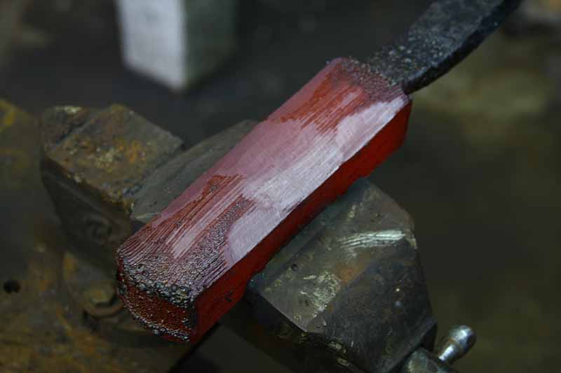

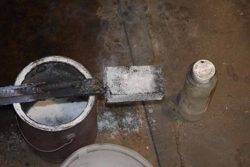

Here I've put kerosene on the billet and sprinkled borax on it. It is ready for the forge.

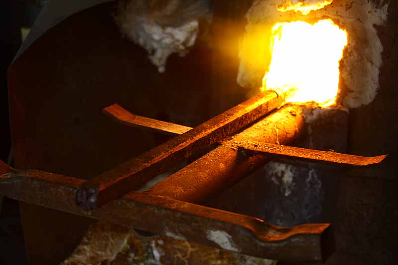

Here I have forge welded the billet and have ground off the tack welds that held the billet together so they won't get in the billet and in the finished knife blade. I will now forge the billet out with the edges running up and down like in this picture to form "W"s in the billet.

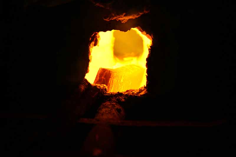

This is the billet in the forge.

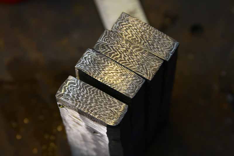

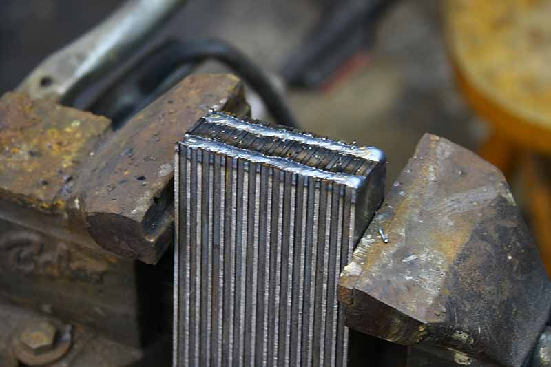

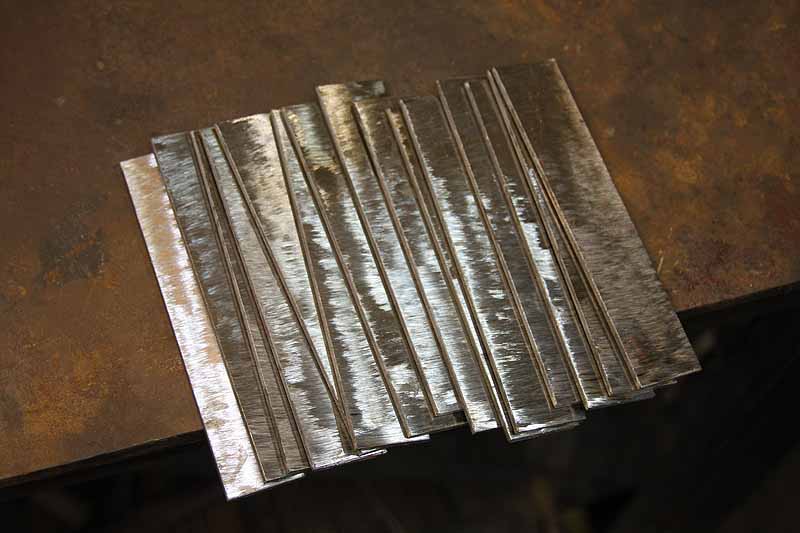

Here the billet is cleaned, cut and etched a little on the end so you can see the "W"s.

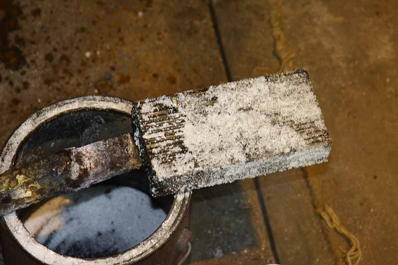

Tack welded together and ready for borax and forge.
Kerosene and borax.

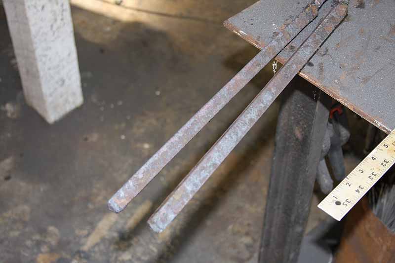

I have forged the billet into a 3/4" square bar with the edges bevelled a little and am heating half the billet to twist right. After I twist half the billet right I'll twist the other half left.
Twisting the billet.
The two twisted halves ready to be forged back square.
The twisted bars forged square.

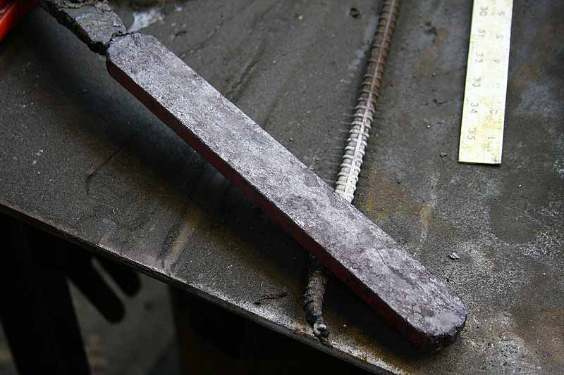

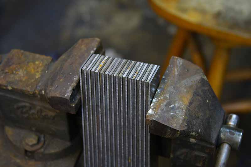

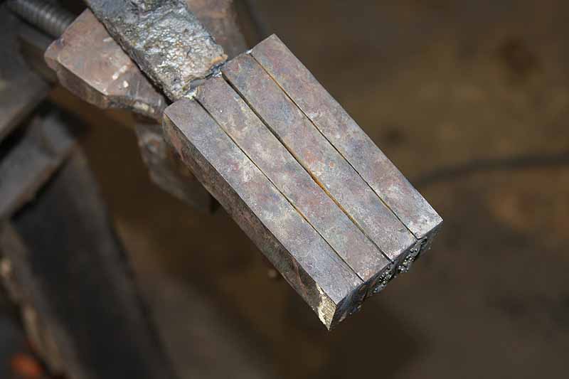

Here the two twisted bars have been cut in half to make four pieces. I have cleaned the scale off the top and bottom of the pieces and alternately stacked them left, right, left, right. Now I'll tack weld them together and forge weld.

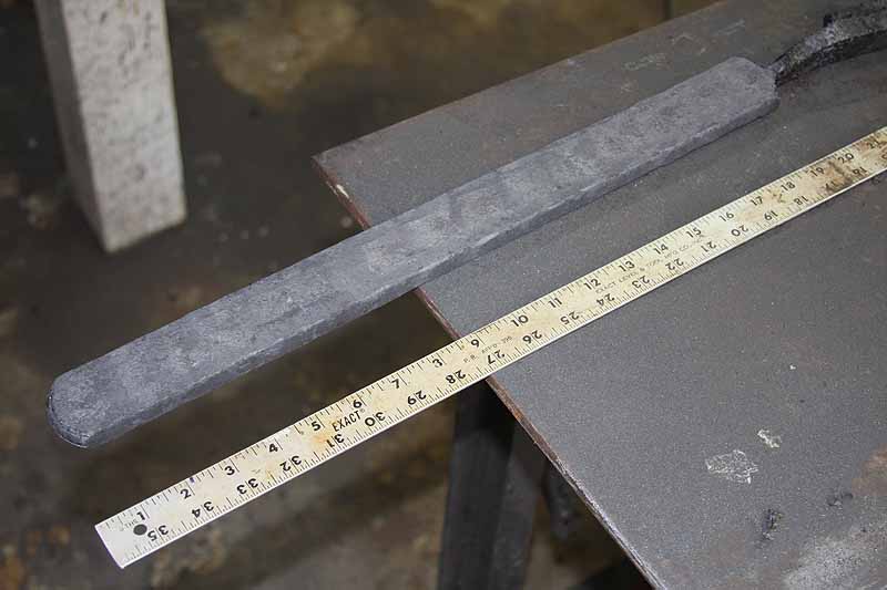

Here the twisted bars have been forge welded and drawn out.
