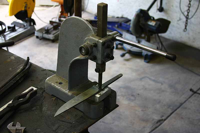

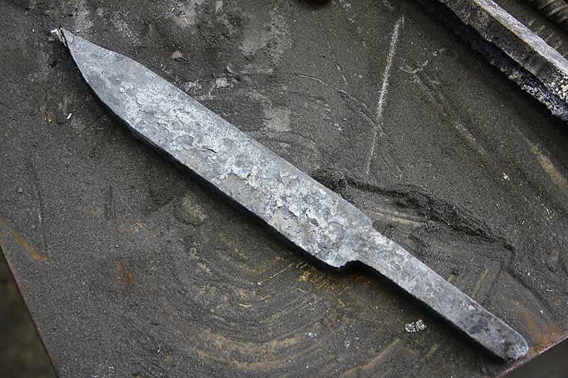

Here I have cut the end of the billet with a band-saw and I will now forge it up and around so the damascus pattern will follow the blade edge.

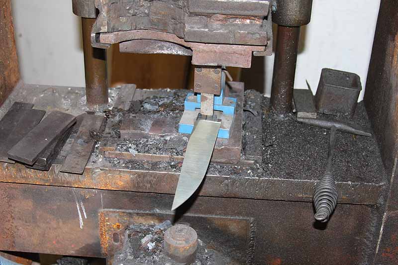

Now I've forged the tip and tang of the blade. This is as much forging as I want to do on this knife, any more and it could start to distort the damascus pattern. Notice the blade is 3/4" thick, the reason for this is so I can grind 1/4" off each side to get to the inside of the billet were all the cool "W"s are seen instead of the outside that would look like a bunch of straight lines.

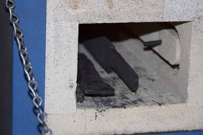

Now I have put the blade into my Paragon heat treating oven to normalize the steel by heating it to 1500 degrees Fahrenheit and letting it cool at a rate of 150 degrees an hour.

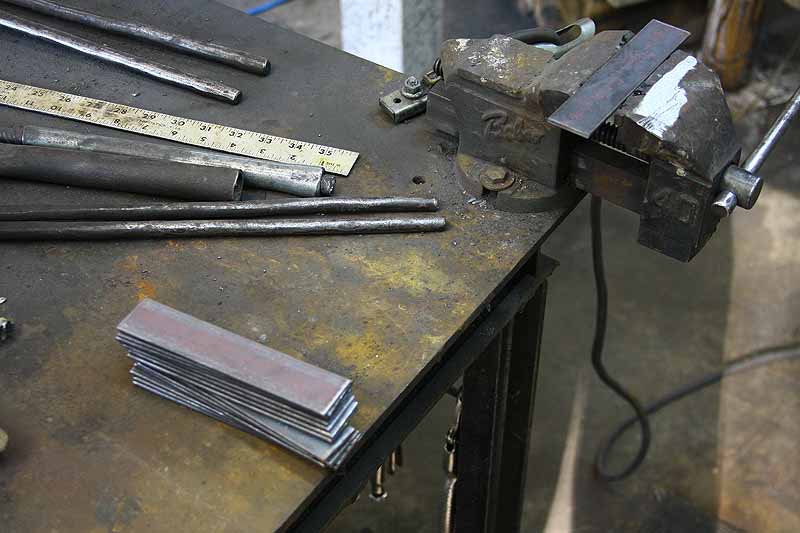

While the blade is normalizing I will grind the scale off the 1080 for the damascus fittings.

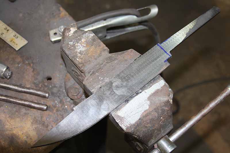

I have taken the blade out of the heat treating oven after the normalization proses and gone over it with the surface grinder to clean the scale off.

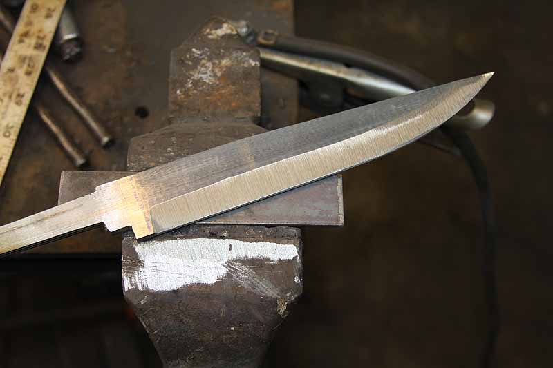

Here I have started grinding in the edge bevels.

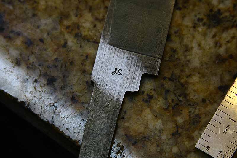

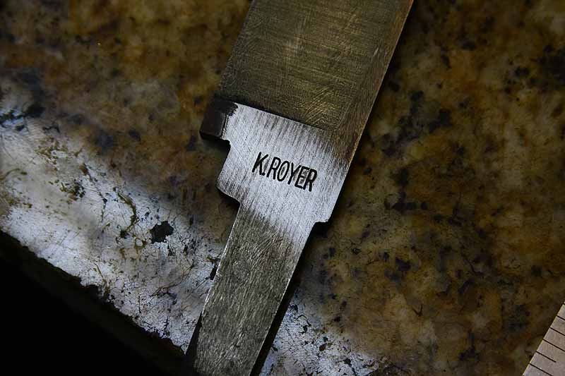

Now I've ground in the edge bevels and am stamping my mark in the ricasso, K.ROYER
Here I am stamping my J.S. stamp in the other side of the ricasso.
This will look more refined after I hand sand.

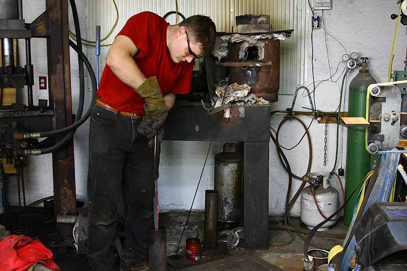

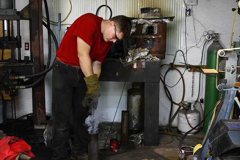

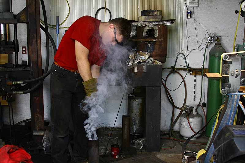

I have heated the blade to 1500 degrees Farenheit and am quenching the blade in oil, for the next three pictures.
In this picture it looks like I'm breathing the smoke off the oil but my head if off to the side and I have a vent fan pulling the smoke away from me.

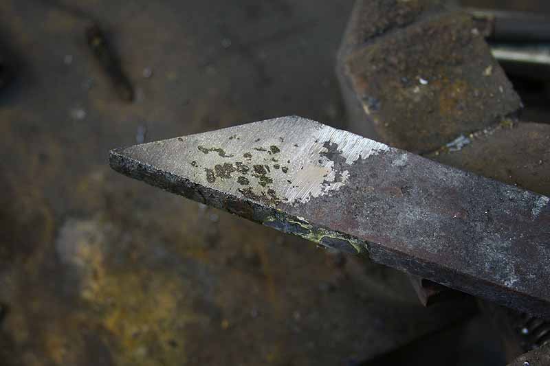

Here I'm inspecting the blade after heat treating to see if it warped. It did warp a little, about 1/16" which will be easily fixed when grinding.

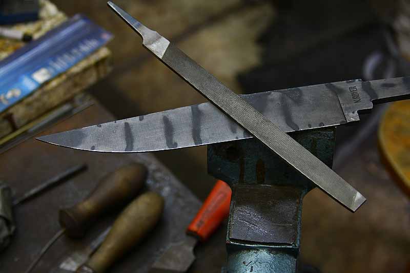

Here I have used a new file to see if the blade is hard and it is very hard.

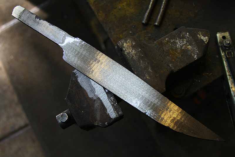

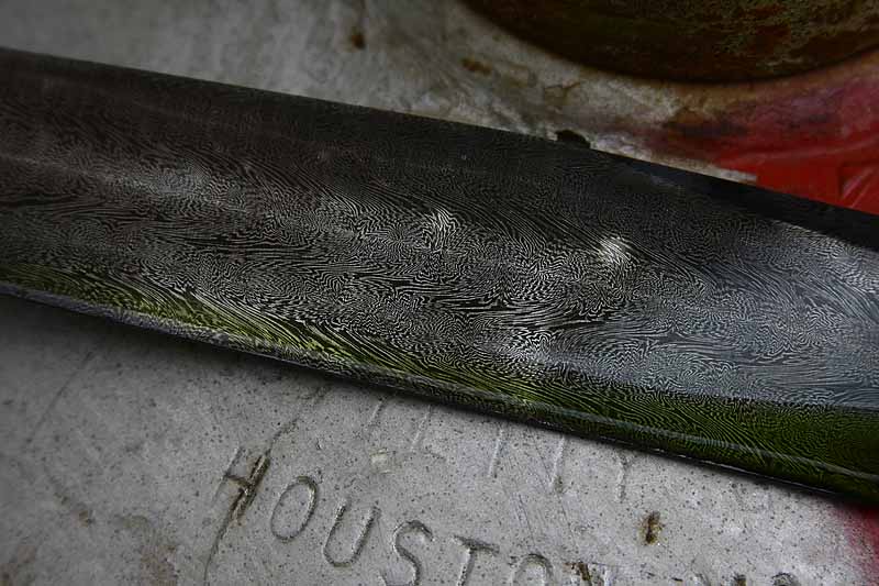

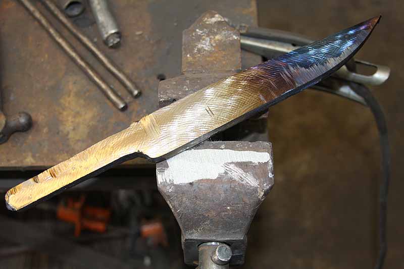

Here is a picture of the blade after heat treating. the damascus pattern came out great! I will now put it in my heat treating oven at 410 degrees Fahrenheit for two cycles of two hours each.

I'm telling your mom that you're a smoke breather!!! :eek:

It looks like you're using your forge for austenitizing rather than your Paragon. If that's the case, why not use the digitally controlled furnace?

Actually I was using my Paragon on this blade. I stopped using the forge about four months ago and would not go back. Except for on my clay hardened blades. I have all the control and an exact temperature reading with the Paragon.
Thanks,
Kyle
