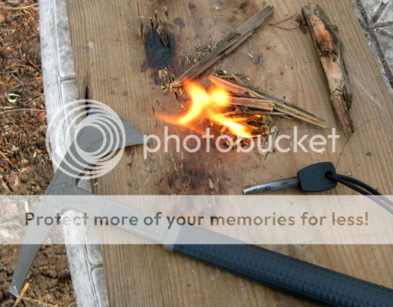

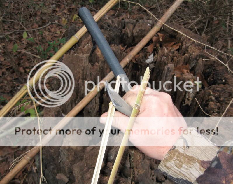

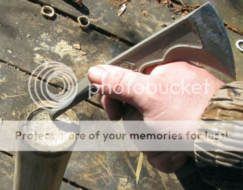

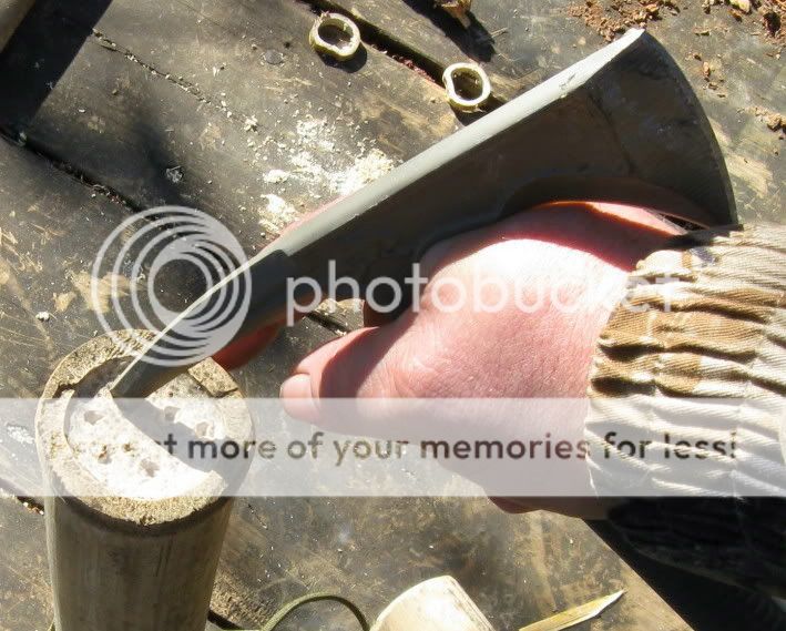

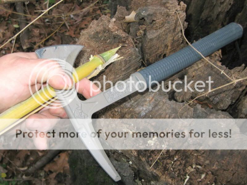

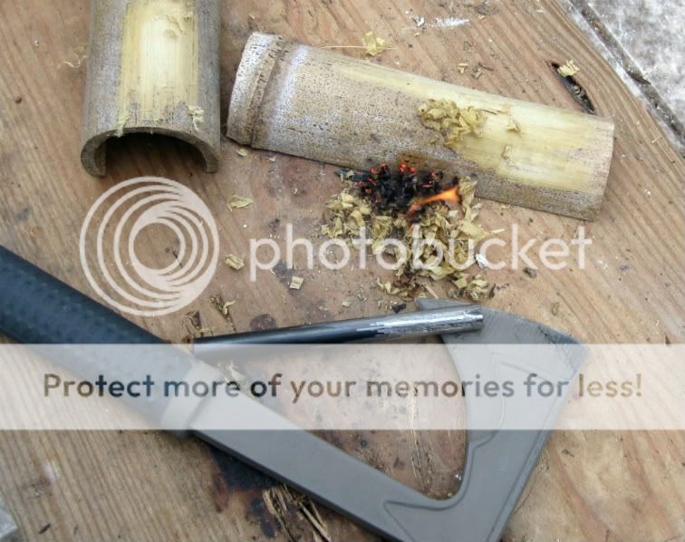

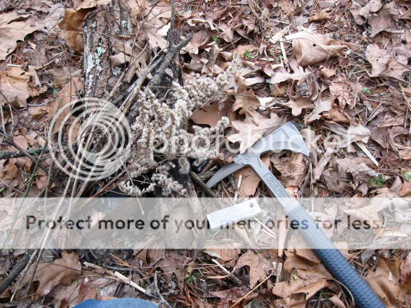

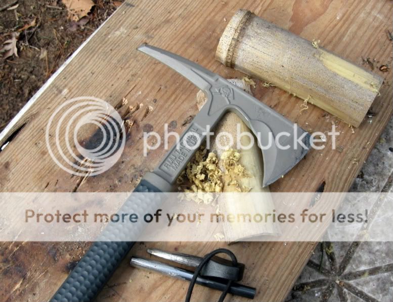

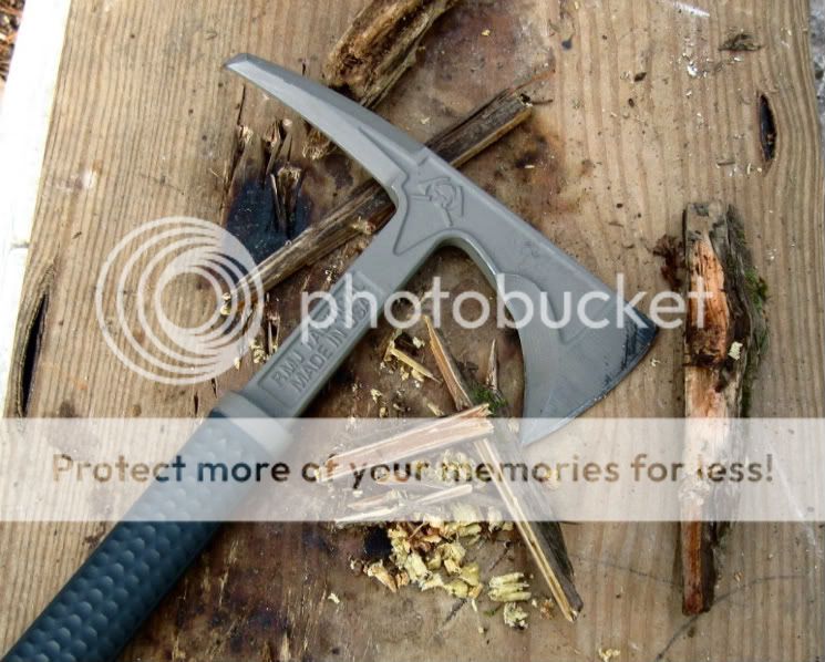

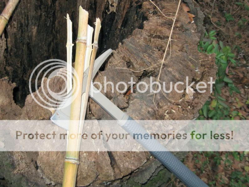

Over the last little while I have used the Shrike and a magnesium fire starter and firesteel to ignite several tinder piles, and start several fires. Following are some of the pictures and videos taken.

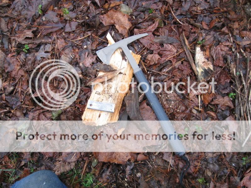

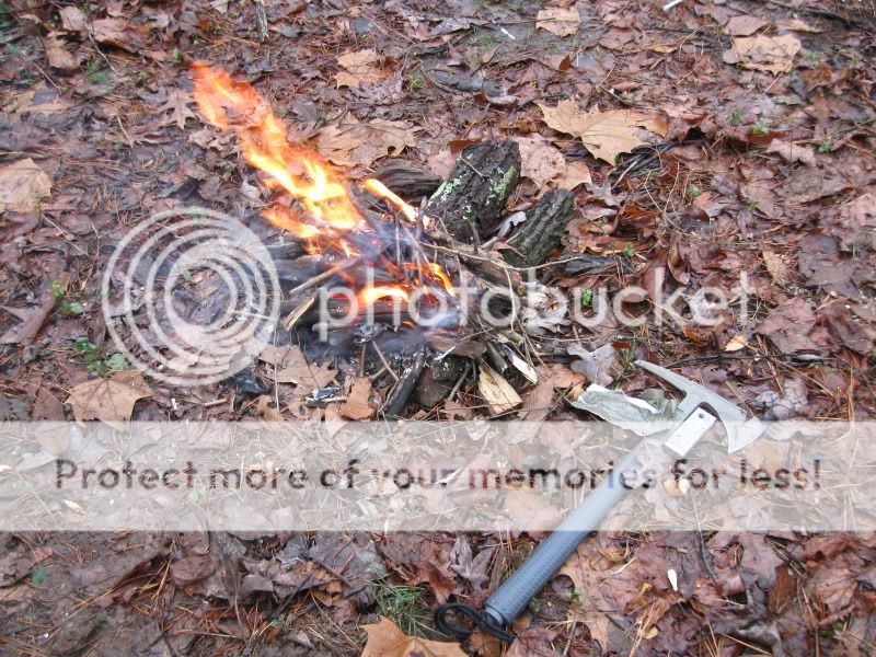

This picture…..
… was taken right before this video
[youtube]1Bd9EAv3HYo[/youtube]

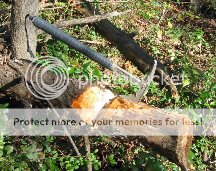

And this picture…
…was taken right after this one.
[youtube]8XYe66MHkx8[/youtube]
