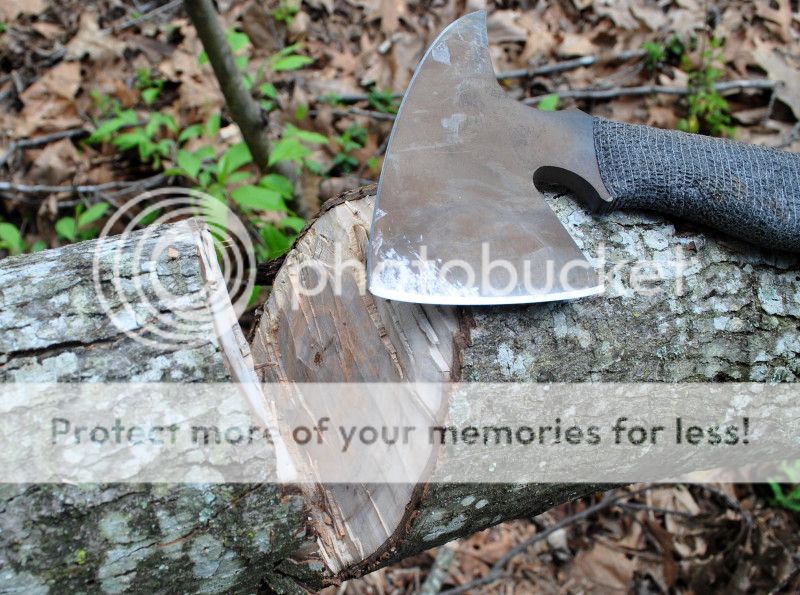

Thank you, I'm glad you enjoyed the post. The Shrike models (large and small) were designed for breaching and extraction with steeper grinds and insulated handles. I have had a chance to try a few of the other models out in bushcraft and the new design Talon, Kestrel, and Hammer Poll all have a much better grind for cutting, chopping, and whittling but would be a bit more fragile versus masonry and metal. I needed to know what all I could do with it in the bush and I wasn't disappointed.

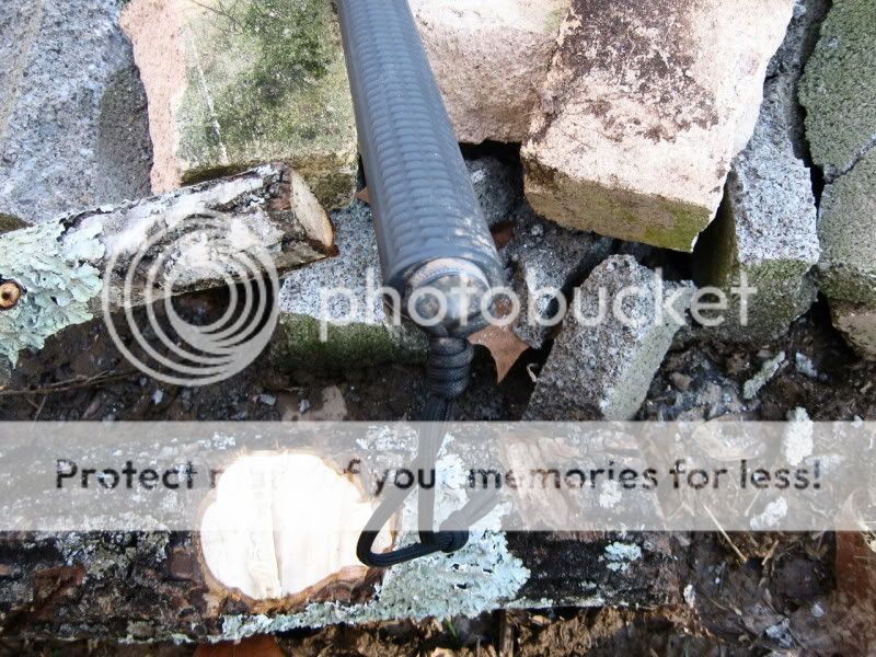

Some weeks back, while seeking help on a project I am working on, I was fortunate enough to have my friend and neighbor introduce me to a man named Ryan Johnson. I have been familiar with his work for years and some of you may also be. You may have seen his demonstration of the Eagle Talon, his first production tactical tomahawk, on YouTube, or you may have seen him on the History Channel’s “Modern Marvels” going into the current production process of the newer Shrike. For any of you not familiar with any of this Ryan owns a company called RMJ Tactical which produces the best tactical tomahawks I have ever had the privilege of working with. I know some of you are probably wondering what a tactical weapon has got to do with Wilderness & Survival Skills but there is a tie in. After talking to Ryan I found myself working on a project for him, and this has given me a chance to really get to know the tools on a more intimate level. In working with them and looking back through the photos I thought there were some good things to share here and some lessons that could be passed on to any who may find themselves in possession of one of these tomahawks. I asked Ryan if he minded if I posted these and he said I could so here goes.

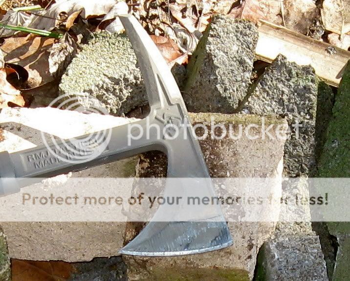

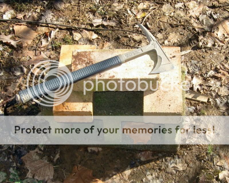

This is the current production Shrike Tomahawk. It is 15.5 inches long and handle and head is a one-piece full tang design that is hammer forged of 4140 Chrome Molly steel. The head has different edge geometries and grinds to perform different tasks. The primary edge is a flat ground radius, the spike is a flat ground tanto tip, (both of those for strength), and the beard has a hollow ground edge for better cutting capabilities. The handle is injection over-molded DuPont ST801 Super Tuff Nylon which has an electrical insulation rating of 500 volts per 0.001 or 1/1000 of an inch of material. This handle is rated to 3000 volts insulation. The Shrike is designed as a close quarter combat weapon and as a breaching tool for ripping through metal and chopping and breaking through walls for evasion or extrication, it stands up to impacts with masonry very well.
It comes with a bottom eject kydex scabbard, and has a cylindrical ceramic sharpening stone in the handle under the “skull crusher” butt cap.

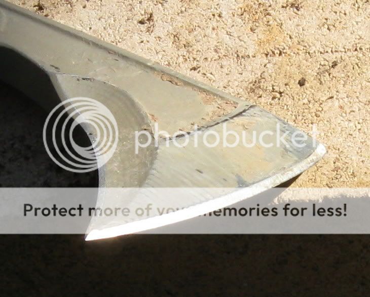

You can see how the primary edge is not ground at a very acute angle so that it can take such abuse with minimal damage to the forward edge.

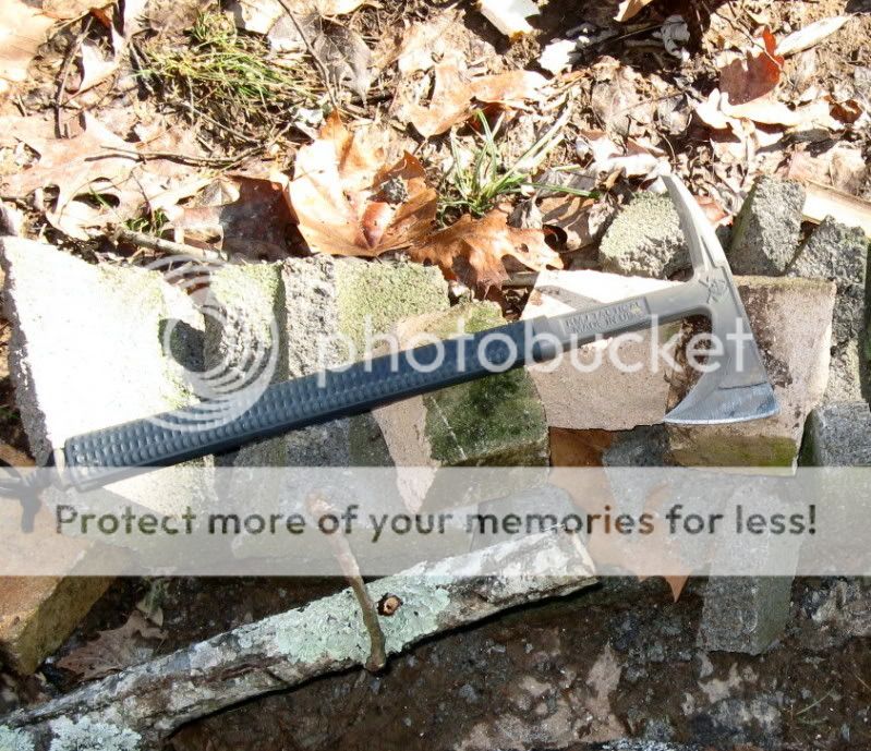

Here is a short video of chopping the brick and block.
