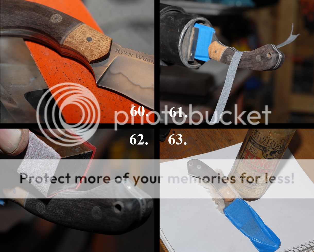

60. After the Epoxy cures for 24 Hrs. I pull the clamps off and carefully square all the flats and around the tang on the Grinder. I then use the 10" and 4" Wheels to shape and contour the handle scales how i want them. Paying close attention to make both sides symmetrical.
61. After I have the rough shape where I want it I take Sandpaper on a roll and cut them into thin strips so that I can hold an end in each hand and round the edges using an up and down motion.
62. I then work the entire handle with a fiber backed micarta sanding block. I start with 150 Grit, then 320 Grit making sure to sand with the grain of the wood.
63. after I have a nice clean 320 Grit finish I take out the tung oil and apply it liberally and let sit for 20 Minutes. Then Sand with 600 Grit, Apply Tung oil again and let sit. and so on up through the grits until I have a finish I like.

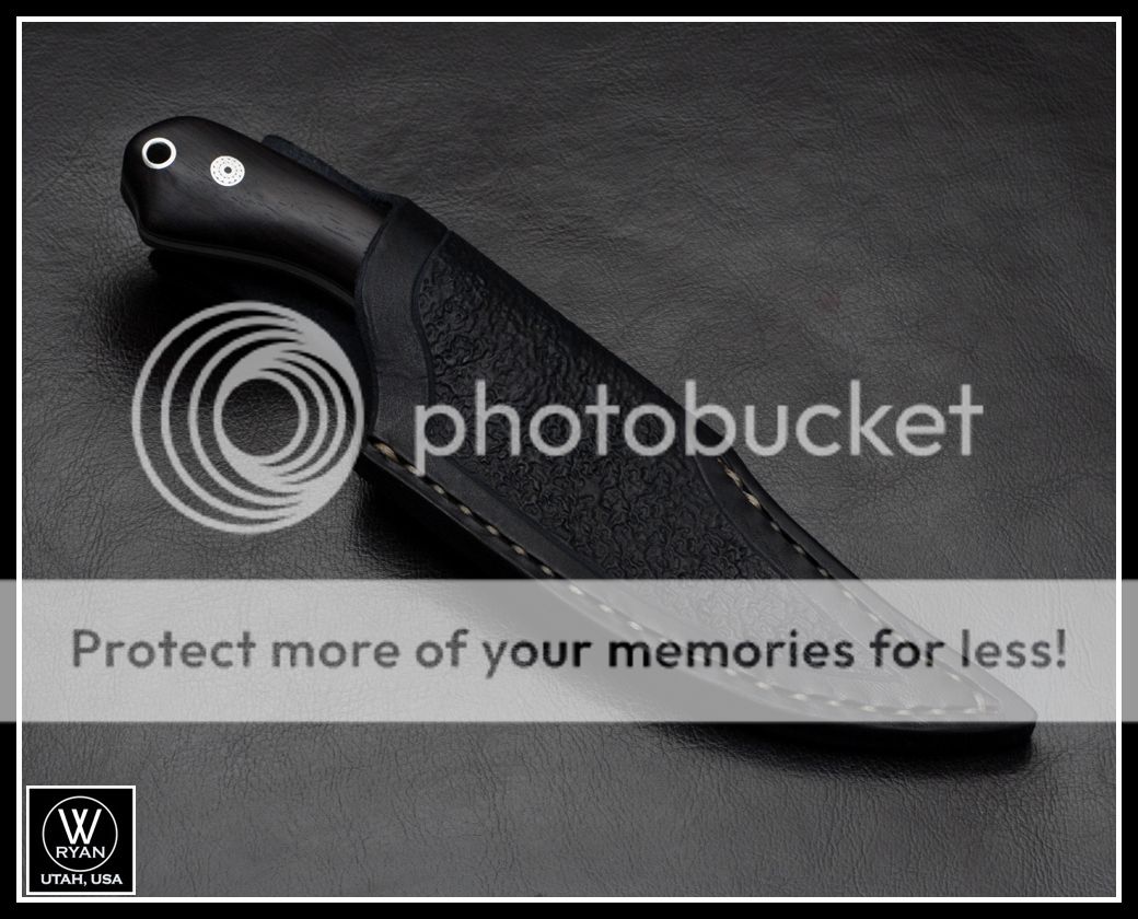

I Finished the sheath up as well today, I did not take photos of that process!

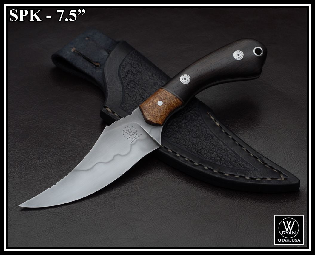

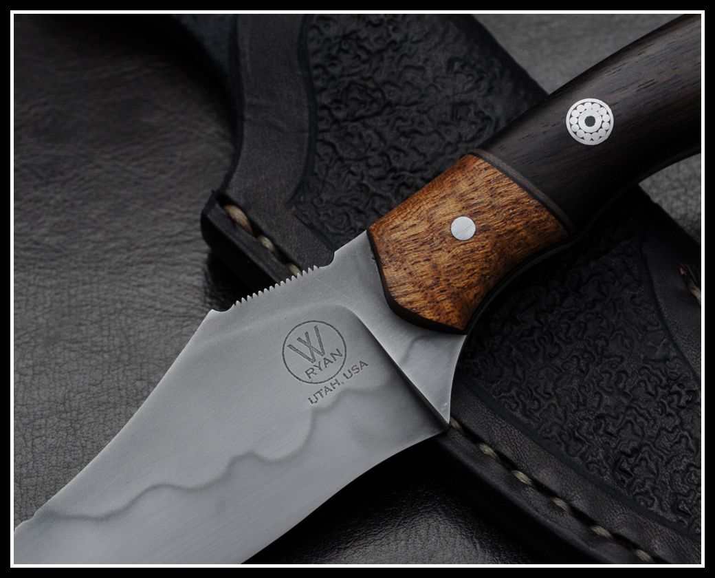

The Finished Knife and sheath...
That Curly Mahogony is Beautiful Stuff!

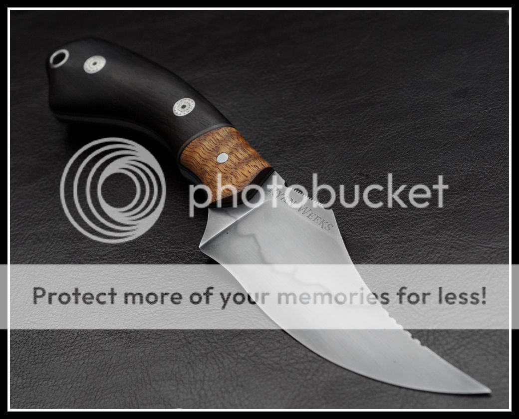

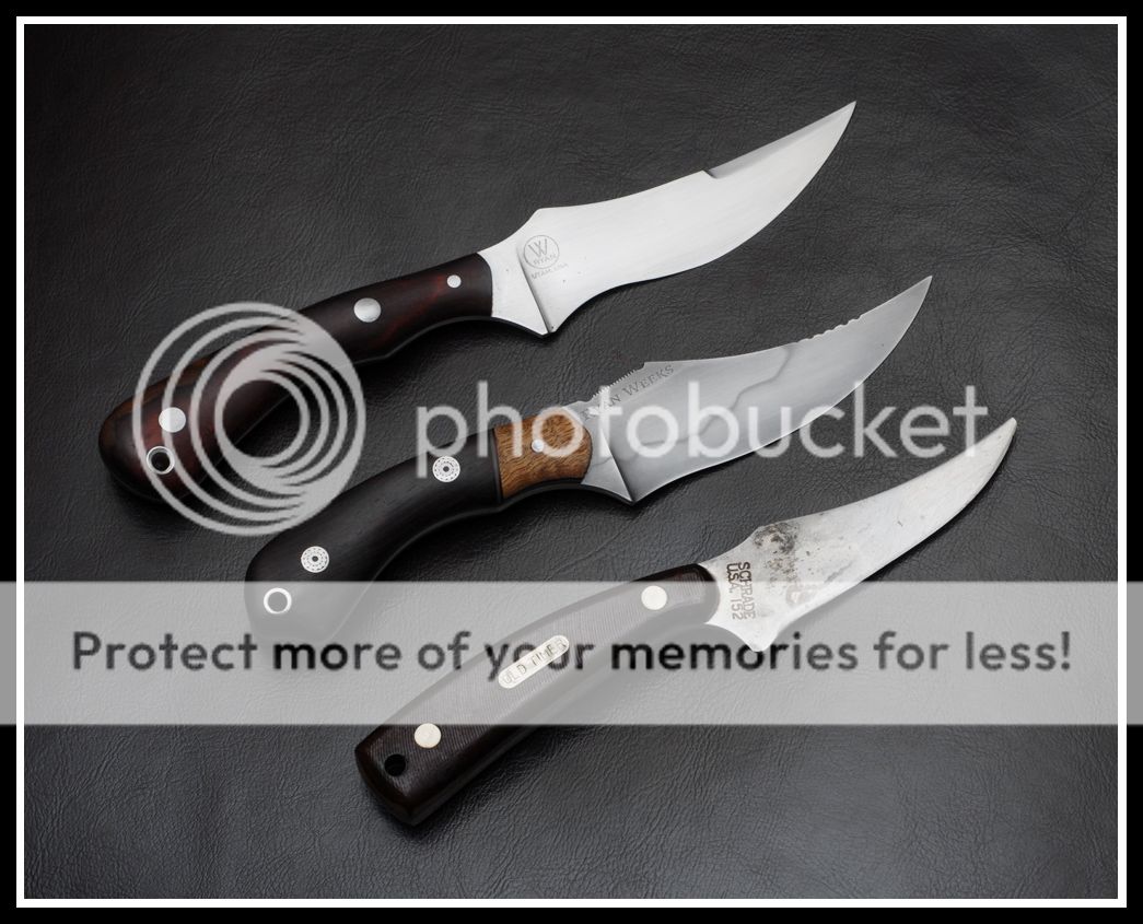

And here we have my larger SPK, Along with the original Sharpfinger for comparison.
Thanks for following this, we are not quite finished. I will put a final edge on it tomorrow, which will be a little different than I usually do it. If Codger is around I would love if he could explain the Sharpfinger "ACA" Edge.

Good Heavens that's georgous!!! I usually don't think a perfect design of anything can be improved on, but I was wrong. Very nice!
I am liking this one a lot! Excellent choices in the handle materials too! While the knife's lineage is unmistakable to anyone familiar with Henry Baer's Sharpfinger, no one will mistake this custom for one. It is definately a RW creation.
The ACA edge is simply a toothed final bevel grind. One might call it "micro-serrations". Some people like this type edge and some don't. I find that it cuts better for me than a really smooth polished edge. And is easily restored if you use a coarse enough stone or diamond hone with a very light touch and finish with a stropping to knock off any tiny burrs. For years I had noticed Sears brochures and blade etches extolling the "A.C.A. Edge", but never could nail down the definition, or if it was even a real feature. They stated that it was an anacronym for "Amazing Cutting Action", which may or may not have been the true source of ACA. Recently a former Schrade employee filled us in on the facts behind the hype. The final edge was applied with a coarse wheel (appx. 80) then final finish with a cloth wheel. He stated that it took a talented individual to do it right. Too much wheel and excess metal was removed changing the edge profile. Too much cloth buff and the effect of the microserrations was lost. I suppose we'll see how well received this type edge is by the knife's testers.

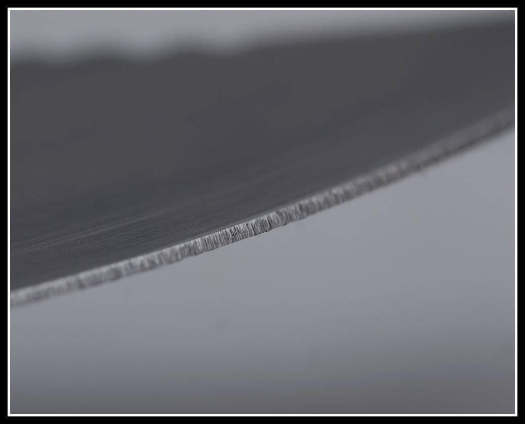

Just wanted to give a quick update... the SPK has a nice cutting edge on it.
On Codgers advice I thought I would try a rough grit cutting edge. Schrade called it the "ACA" as explained in Post #48 of this thread. I am calling it "Micro-Serrations" I put the cutting edge on with a 120 Grit belt (Didn't dare go with 80 Grit) then knocked off the Burr with a cloth wheel and stropped it with a Leather Strop.
Here is a close up of the cutting edge, very toothy and cuts extremely well with a slicing motion.
A friend of mine has the same Schrade... I don't think it ever had a tip! His is just as bad as yours, but it holds an edge hella well. Also, VERY nice revamps!!
I believe you nailed the final edge I described. It looks much like the factory edge, though I don't have a closeup picture of one to show here. We'll see how well the testers like it. I know that some prefer a polished edge on their knives.
