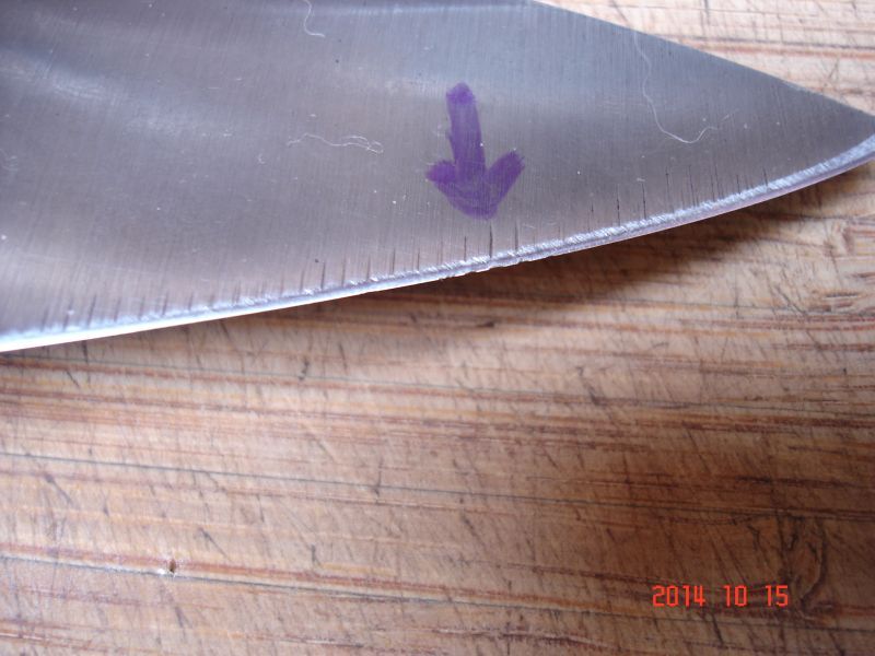

This is a 3V knife blade with chipping along the edges. I partially removed the chips with a WorkSharp. I believe the chips — which occurred while using the 12-inch blade as a machete in heavy brush (no rocks) — happened because of deep grind lines left behind by the maker. The chips line up with the deep grooves. The heat treat was by Peters at 59-60 Rc.
It will take a long time to get rid of the grind lines, but I’d guess that the chipping would stop once I do. But since I’m using this knife as a machete, I’m not concerned.
For me, the lesson is that chips can result from a number of factors: the steel, the heat treat, the use, and the grinding.
If the edge were finished the lines left from the grinding shouldn't matter, though they can result in other issues. I'd really like to look at one of these blades with chips in 3V. As I've said, I've never seen that happen and I'd like to examine the exact nature of the deformations. In any case, this absolutely should not happen with 3V and in fact I'd be surprised if they happened in a decent stainless with a properly shaped and finished edge without hitting something a lot harder than "heavy brush". Twindog, would you be interested in sending me that knife for a free sharpening?
Sure, Jerry. You can test out the edge with heavy chopping, too, if you like. I did remove most of the chips, which were not that deep. The ones left were deeper.
If you send me your address, I'll get it in the mail tomorrow.
