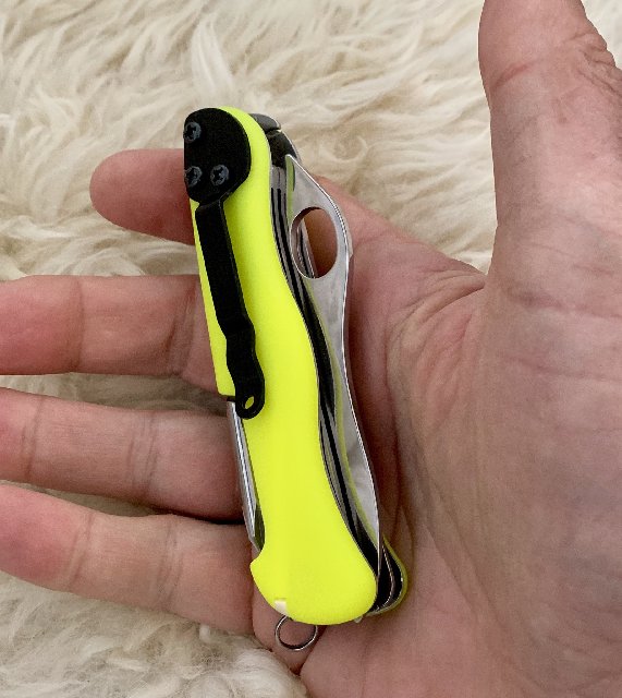

here’s the mock up for the awl..
That looks pretty cool! What does it look like when closed? The stock on the awl looks slightly thicker than the nail file. Does it create a bigger gap between the blade and the scales on the backside?
You saved me from taking the knife apart. Do the blades pivot on a threaded screw? Thanks!
Yup! Here’s the direct quote from the SAK mod master:
“It was serendipitous when I realized the OD of 0-80 thread was 1/16 inch, the pivot size for 58mm tools. I would not have tools pivot on threaded pivots normally, but on these tiny guys it really isnt an issue. I did tests and they work just perfect.”
Having a blade swing on a threaded stainless screw would be at least as good as an unthreaded brass rod.
