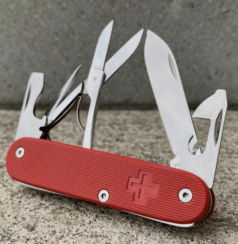

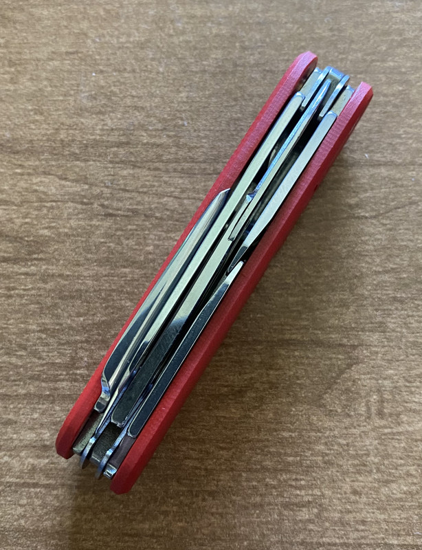

84mm scales and scissors… what’s cooking?All 84sAll in great shape, gotta clean and replace springs
Looks to me as if Spikediesel is working on the Cadet Pluses he hoped to have finished this month.84mm scales and scissors… what’s cooking?![]()
