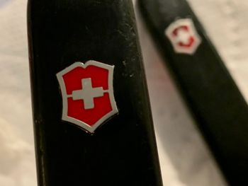

That's way better than anything I could do.
They both look nice but I think the bottom one turned out the best.
Yes I agree, the shield on the top got a bit battered after I removed it and reattached it after I sanded down the scales. But from a technical perspective it works really well (if you want surface treatment anyway).
@kamakiri.knives With your experience of vintage models with visible pins, could you tell me if they are peened against the scale or if there is some sort of bushing between the liner and the scale? I am wondering if the scale is strong enough to peen against without weakening the material or making the tools wobbly?
I will do some experiment with heat… With my basic tools I can’t do a cutout that satisfies my OCD 😉
It’s not easy to cut out like a traditional inlay. The shield and cross together make it a lot of work. Separating the cross from the perimeter shield makes it a bit easier. The original cross a shield were 2-piece from about 1909 to (I think) the late ‘30s (1937) when cellidor was first used. Like the one on the left:

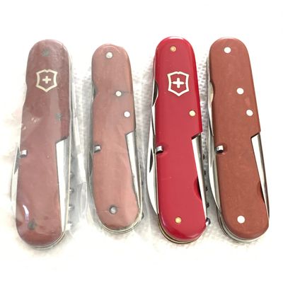

One other way that I’ve done is to make the cut for only the outer edge and inlay the shield and cross with its cellidor back as a single inlay. I’ve done that to inlay say a red shield into a black scale. One is red and the other Ruby Translucent:

Everything was built that way until 1957, regardless of the scale material used. The rivet head actually spreads pretty far down in cellidor. So the head really isn’t far from the liner underneath. But it is why many old knives wobble after the scales shrink, wear or crack. I have to cut pretty deep to release a vintage scale without damaging or removing any material. And resin based scales seem to take to peening just fine, as you know. Cellidor isn’t much softer in that regard, I think.
A couple reused/reset inlays in cellidor:
rs=w:400,h:400

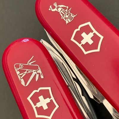

Hello, I recently picked these up at a yard sale "as is".
A Spartan (circa 1999 as it has a "Straight spring") and a Huntsman from 1999-2005.
(I think I mixed up which scales go with which knife though.)
I would like to know if I can get these fixed or repaired?
I've reached out to Victorinox here in Australia, but as yet no reply.
The Spartan's can opener has a slight twist in the screwdriver tip and one brass bush looks to be missing.
As for the Huntsman, all the tools are really hard to open but looks in good shape.
I've thought about doing a full rebuild with custom scales, but to be honest I feel this is beyond my talents.
Any and all help with these is very much appreciated.
I think you have the right scales with the respective knives and that the Huntsman’s were replaced (scales date ‘85/‘86) with glue attachment.
I think I can see an ‘01 date code in the Spartan front scale and can’t read the back scale. The ‘straight’ lug spring I have as a ‘00 change which coincides with the caplifter locking nub.
But I think you might have trouble getting either warrantee repaired. The Spartan because it’s parted out…and maybe the Huntsman, if they take issues with the glued in scales. Maybe they won’t have a problem with that.

Just give the Huntsman a good cleaning and put the scales back. Done 😉
Since you already took the Spartan apart, look for a donor knife and take the can opener from that and put it back together. Vicorinox would surely have given you a new Spartan if it was in one piece…
