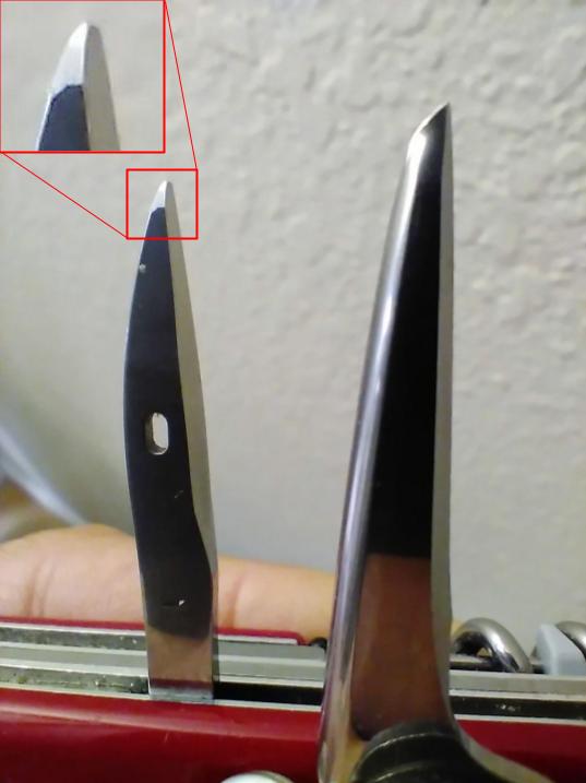

I tried out the reamer on my Camper on a scrap piece of pine yesterday. It worked, but it also split the wood. Today I took a look at the reamer of my Farmer and noticed the tip had a nice taper to it. I started wondering if I could do the same to the Camper's awl.
You can see, I did not remove a lot of material. I didn't want to risk weakening the tip too much. I can always remove more steel later if I want, but this seemed to make a difference. It feels pointier to the touch, and I was able to make a couple of holes without splitting my stick.
