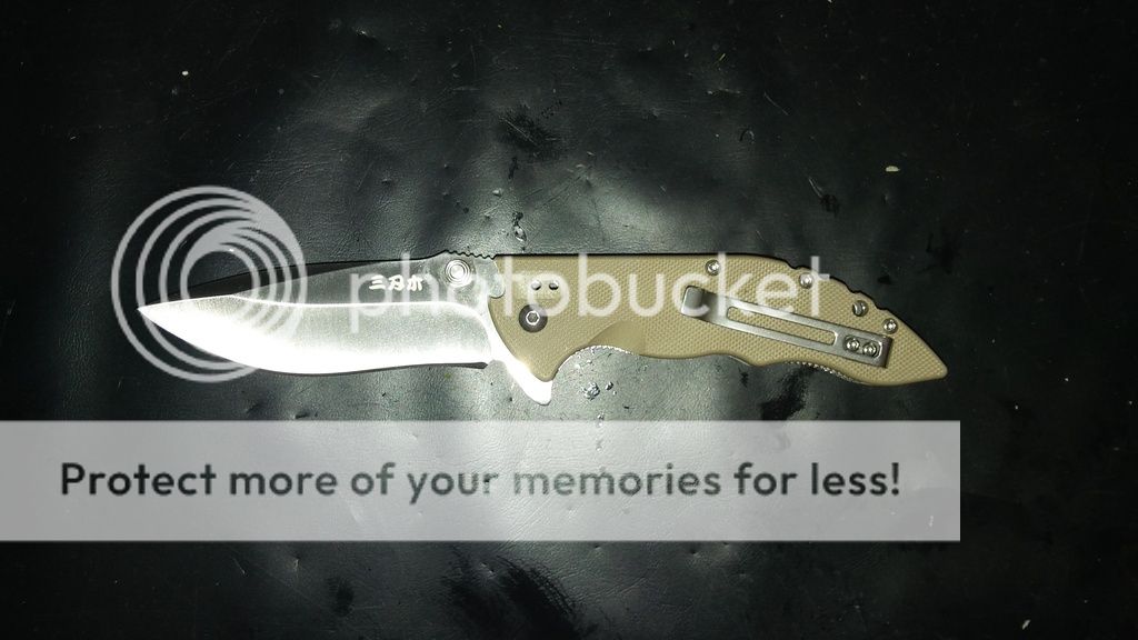

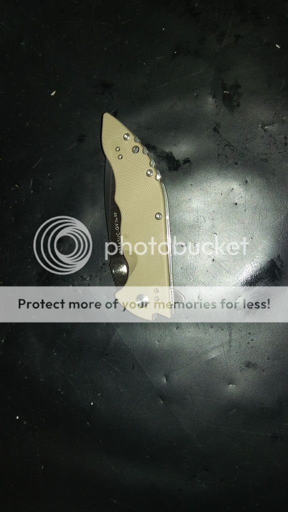

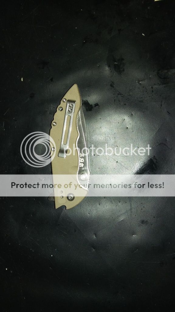

Hey guys, just going to do a little post about my Sanrenmu i just got, i got it for 11 dollars form gearbest :D its a slipjoint flipper (i know right :D:D:D:D) so basicaly it has a flipper action but no frame of linerlock, it only has two little balls in the frame that lock the blade when you open it, i really like it, it has a really nice G10 handels that are rounded of at the edges, for 11 dollars, the fit and finish is soooooo nice, i love the feel of it, and it has a four way pocket clip, its 8cr13mov blade steel and its totaly fine, it holds a decent edge when you strap it, it has a nice size for a edc knife, really smooth action, oh and it has a semi polished edge :D:D

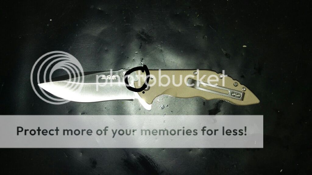

Aside from making the ergonomics uncomfortable and having a detrimental effect, what is the use of this circled spot?
Furthermore, the angle of the clip will put the point on the butt of the handle further out into the pocket and not ride tight against the seam, causing it to ride wider in the pocket than need be. In addition to the added width, it now has a sharp point in the middle of your pocket which can get in the way of movement while also making your pocket a nightmare to reach into.
- This is considering that most would have the pocket clip vertical.
On top of all of this, there is a recurve in the blade which will make many shy away from it due to not wanting to or knowing how to sharpen it correctly, regardless of how "easy" it is to sharpen.
- Evidenced by the fact that even the company couldn't sharpen it correctly. Look how the bevel widens at the rear most point of the heel, but it is shallow throughout the recurve.
