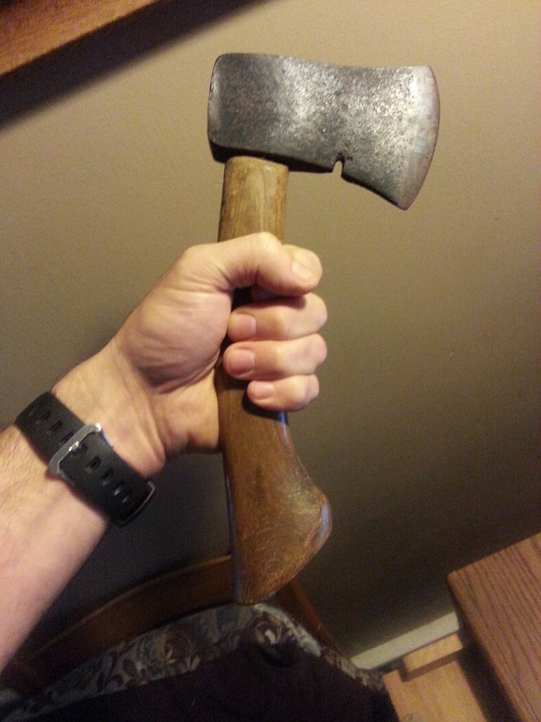

Well, I stared at the Merit's original haft for too long. After giving it a few BLO coats, and thinking it over, I pulled the head off the new handle and put it back on the original (I think) haft. It's now back to it's original 1930s (I believe) goodness. It's a gorgeous old haft and feels great. It turned out pretty well, I think! Unfortunately, I couldn't fix the damage on the swell, so the other side has a bit of a chunk missing, but it's not noticeable in use, so it's only an aesthetic issue.
