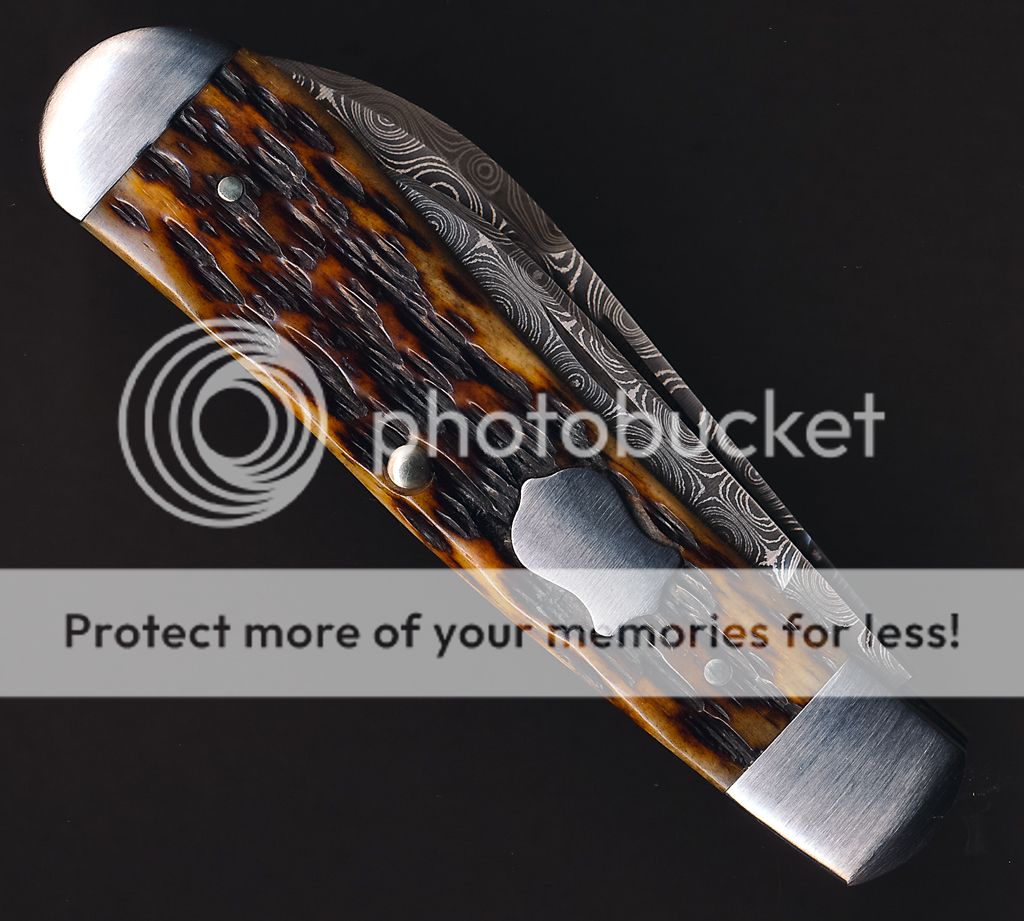

I made some scans of some of my knives a few years ago. You can really get some high detail, and I really like that there is no distortion due to the angle of the picture since there id no angle.

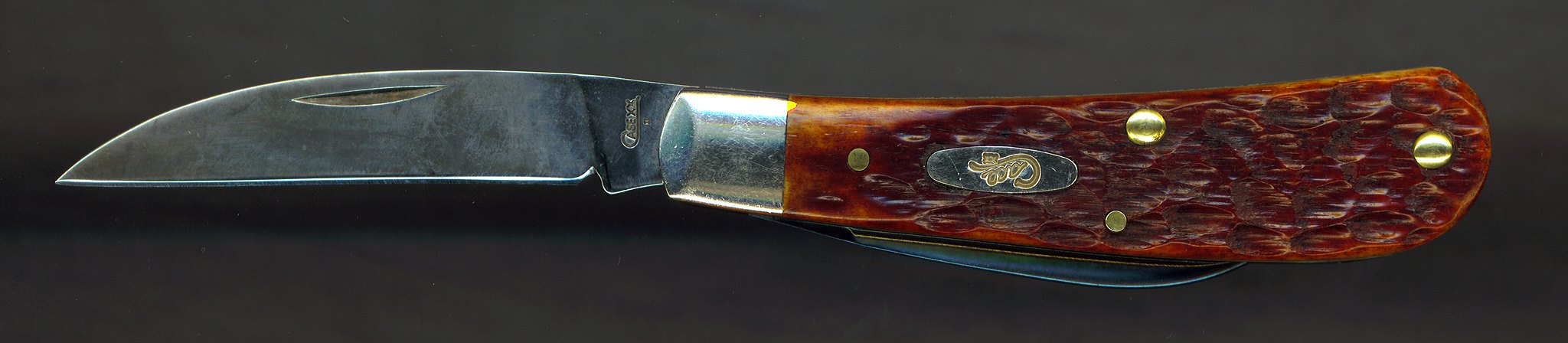

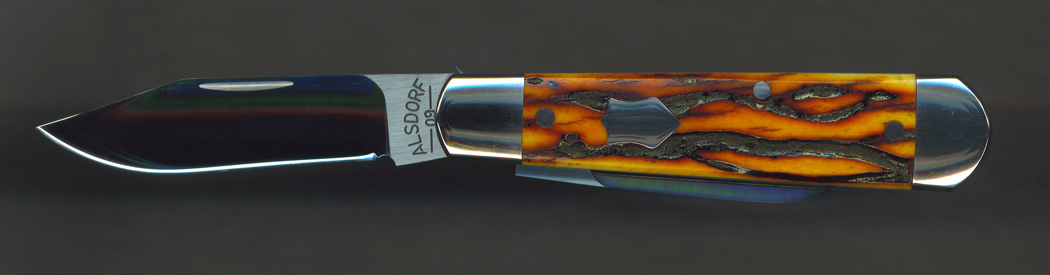

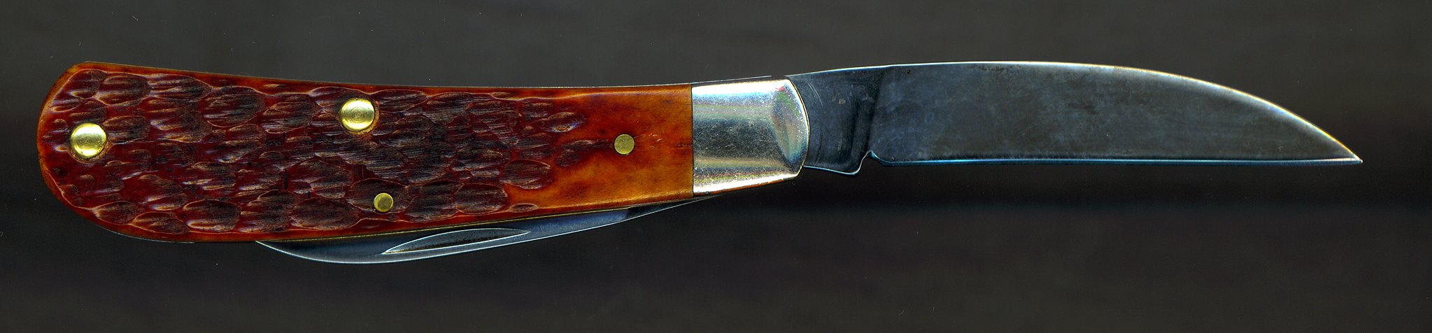

In these last two I wanted to show the effect of horizontal vs vertical positioning in the scanner. Look how flat the bolster looks when the knife was turned 90 degrees from "East/West" orientation to "North/South". Also the color is not as true to life either. Not sure why this is, or if this is universal to scanners, but something to watch for. Even turning the knife at a 45 degree angle to horizontal will have an effect.
Wow, this is awsome. Got to try and hook my printer/scanner up now. Thanks guys, some real beauties
Doug,
Scanners have very shallow depth of field, so all I did was take a cardboard puzzle box top and sit it over the knife. It is about 3" deep and grey in color. I am going to try putting different color paper inside the box to see what happens. Thanks to Stu for the tip on adjusting the knife, I just sat it however. Thanks to Jake and other's that have done this for years that gave me the inspiration to try it. It sure shows detail.
Stu, I found I could get the color CLOSE adjusting white balance, but these PDF files are not RAW :)

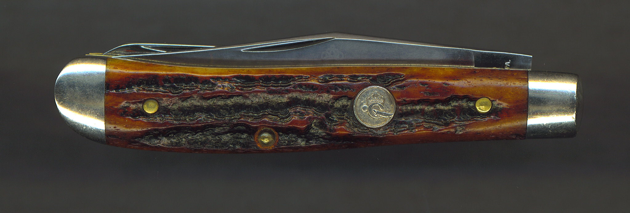

Attempt 2
Stu,
I don't know if you missed it but you can get the color very accurate adjusting exposure and white balance.
Kevin
Try 3
I am done playing for now :)
It really is interesting to see how many scratches are on a new in tube GEC :eek:
