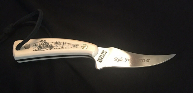

Schrade 152OT Sharpfinger
Here is another SFO Scrimshaw on which I lack much information at all. The etch, "Ride Free Forever" is the copyrighted title to a Harley Davidson motorcycle collector's guide published in 1998. But who had them made, exactly when and the quantity eludes me. So far I have only found a mention of the issue in this forum a decade or so ago with no added information.
This is a three piece cased set for U.S. Tobacco, one of four variants produced to promote their outdoor sports programs. This one, UST95BR, is etched, "Bandit Racing". Others were "Outdoors" (UST95CSO), "Pulling Circuit" (UST95PC) and Pro Rodeo" (UST95PR). Each of the knives wore birdseye maple handles, brass bolsters, pins and coined cutler shields. Of the four variants combined there were 944 sets produced so today full unbroken sets are seldom seen.

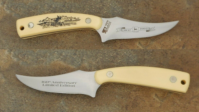

In 1997, Schrade produced a limited edition five piece set (SC5LTDJD) for John Deere farm equipment celebrating their 160th anniversary. This is a Sharpfinger from a set. I don't have the five piece set, just the Sharpfinger from a broken up set. I don't know yet how many sets were produced.
ETA: From a 2007 post here, 1,000 of the five piece sets made.

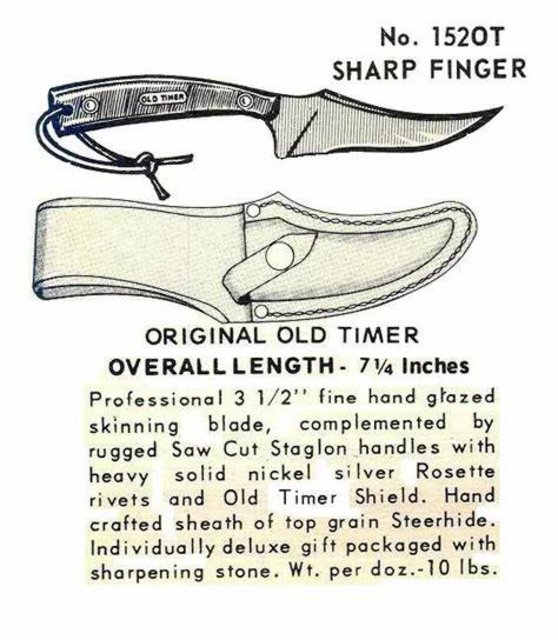

I just found a factory fresh Sharpfinger sheath that is very scarce in this condition. It is the very first design, ca 1973-74. It has white stitching and a pointed retainer strap tab. Usually these have handling or shelf wear even if unused. And the pointed tab end curls and frays. This one is appropriate for the very earliest production and came in a deluxe slip-top box as mentioned in first ad art.
