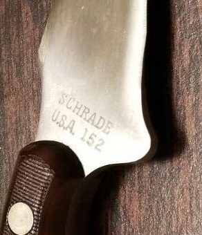

A pair of early Sharpfingers found this week. First, the earliest circa 1973 slip top box. It is missing a few components which need to be replaced to complete. The polybagged gray square stone and the sheath polybag as well as the vinyl blade sleeve. It did include the correct insert paper. The surprise is that the tang stamp is not a stamp but rather an etch!

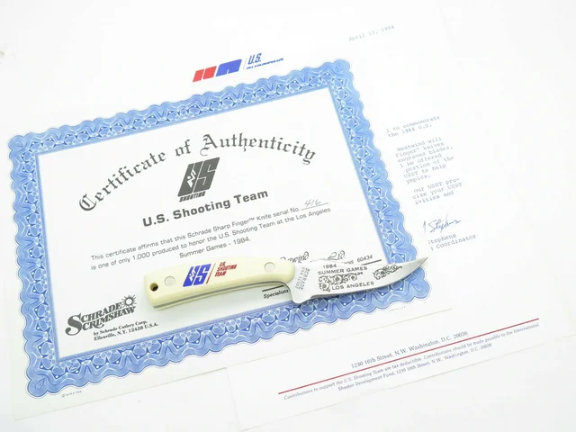

The U.S. Olympic Shooting Team knife was limited to a quantity of 1,000, an additional 250 which were 24K gold filled and supplied in a walnut presentation case.
These special presentation knives were offered complementary to certain dignitaries in the shooting industry, with the balance offered for sale only on the site of the shooting competition in L.A. at a price of $149.95. The knives in the cardboard gift boxes with standard etch were priced $69.95 plus $2.50 shipping and handling

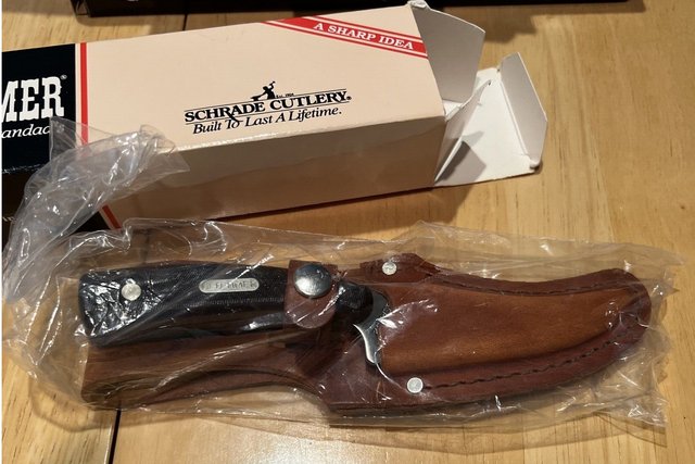

My latest find, another Sharpfinger still new in the box from the 1990's. They are still out there at reasonable prices.
Roughly dating this knife is fairly straightforward using the printed slogans and address on the packaging. The address of "Route 209 N., Ellenville" first appeared in catalogs and ads in 1986 – 1993. The "Built To Last A Lifetime" slogan was first seen in the 1990 flyer SC90-002 and in catalogs 1991 - 1995. So no older than 1991 and no newer than 1993. This also confirms the sans-serif tangstamp was in use at this time.
