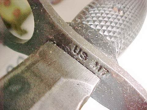

Intriguing question. I have a couple of G.I. M-7 bayonets by other makers that are marked on the guard, yours is marked on the tang, does that have something to do with it? Is this knife not government issue? If it is G.I., was it issued after we pulled out of Vietnam and therefore never saw service in the war? I give up.

Please don't be pissed... the knife is a fake. These come up every once in a while. I see 'Cheaper than Dirt' has some sawbacks on their site right now for M1 Carbines... falsely advertised as 'issued' or words to that effect to lead one to think these are 'official' US forces bayonets.

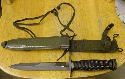

These were made commercially by couple of firms. This particular one looks to be handcrafted out of an M7S and parts from a standard M7 bayonet. The end/pommel where it attaches to the rifle has been welded, rather than peened over. Guard is blued. If I had photographed this next to a regular M7S sheath, you probably would have caught on. Doesn't the issued bayonet sheath just make your mind think 'real military'?

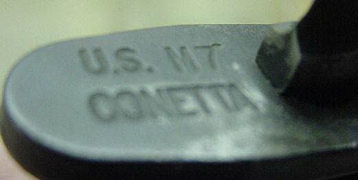

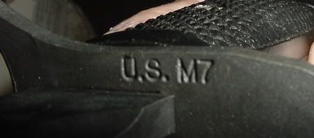

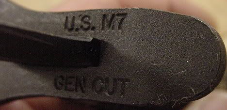

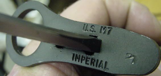

My hunch about the tang marking seems to be correct. This is a pic of a government issue Imperial M7 bayonet and it's marked on the guard not the tang:
G.I. M7's by other makers are also marked on the guard, not the tang:
