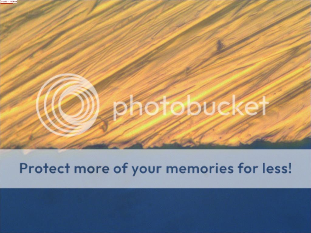

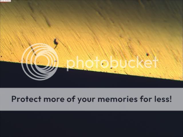

These are a couple of images from a straight razor finished edge-leading on a DMT 325 with water. I don't see teeth, and it's not obvious to me that the direction of the scratches would affect the cutting performance.
Todd, cool SEM pics! Looking at your angle, I agree with your assessment.
From my view - I see a few things: undulating apex (z-teeth); ridges teeth face; a lot of burnishes - probably from flat-top diamonds. Also razor steels usually quite ductile. If you like to look at something a little harder and more alloy. I can send you a paring 52100 63+rc and a tiny D2 blades.
In the pics it looks to me like the crossing effect is diminishing the amount of tooth. As the finish becomes finer the effect would expect to decrease somewhat, at least on most materials/cut tests. The scales for these are in the upper left by the red bar.

OK, I can see a more tooth-like structure when the scratches are parallel. What is the hone in those images?
