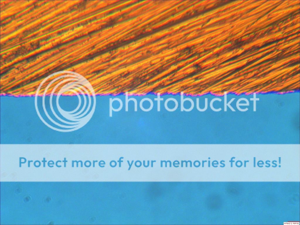

OK, I can see a more tooth-like structure when the scratches are parallel. What is the hone in those images?
The first image is 800 grit 3M wet/dry over a Washboard - 420HC, second is 320 grit Gator wet/dry over Washboard - Aus 8. Third image is off of a fine Crystalon and steeled with a smooth meatpacker's steel - that's how it has the heavily burnished features along the edge - not sure what steel, maybe Sandvik 12c27. The last image is off of a fine Spyderco ceramic and stropped on plain leather - maybe stropped with Flexcut Gold first but I don't think so - 1095.

It appears from my perspective that the "toothy" edge is there (and has been, but being hidden by other factors), and it is becoming more evident as your strokes and resultant scratch pattern are evolving into more parallel strokes/pattern.
After your first images I was thinking the non-parallel stroke/scratch was really interrupting an even edge pattern. Others I think also picked up on this.
When the strokes pattern changes is when the wavy edge fallout is happening (from my experience, this I'd what I am seeing as the photos are evolving through this thread). The photos in this thread appear to confirm this and are similar to my experiences.
Additionally, as the pattern is becoming more consistent (in recent posts) it appears other things are showing themselves (that were also contributors to earlier photos of uneven wavey edge).
Appears either the stone(s) have differential grit size or metal swarth buildup is causing irregular scratch depth & pattern. Possibly your stone(s) need surfacing (or evening - typical on my DMT's and especially my last Tan 8k DTM that took surfacibg & few sharpening to finally calm down & smooth out).

I'd say those qualify as toothy. As you continue to go up in polish the edge will become more uniform, not just along the edge as viewed from the side, but also as viewed from above.

I would have thought so also, HOWEVER, these are SEM micrographs of a DMT 325 edge:
This might touch on what Jason mentioned earlier, in that knives & razors may not take the same edge on a given hone, maybe(?) due to vast differences in edge geometry/thickness and how they're sharpened (angle & use of pressure, maybe direction of stroke as well). Might be an apples vs. oranges sort of thing.
Are the images from edge-leading* passes, or edge-trailing? I could see, if trailing passes were used at very low angle (as for razors), the depth of cut could be much more shallow, more or less 'skimming' over the diamond. I'd think edge-leading passes on a coarse DMT might wreck such a thin edge on a razor, especially if sharpened in a manner similar to a more typical knife edge, at higher angle and edge-leading.

These are all edge leading strokes with light pressure.
The only effect I observed with increasing pressure was the production of a few chips. The edge between the chips seems not to affected by the increased pressure.
This is an edge view after the DMT 600 (25 micron) with two chips and a 25 micron circle for scale:

Razor edges and knife edges are not the same. The added hardness of the razor steel will greatly affect the fineness of the edge. Along with that not needing to hold any angle part.

Thank-you for those images Jason, they are quite helpful to me.
I wasn't aware that there is much difference in the hardness of razors vs quality knives, I thought razors are usually in the 58-62 HRC range. ?
Certainly the lower angle results in a more flexible apex region.
As to pressure, razors usually have much narrower bevels than knives, so much less force is required to achieve the same pressure.
