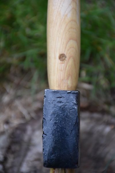

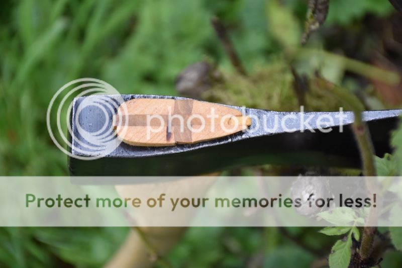

I hung this beautiful old Walters axe head on a 28-inch House Handle haft. The single cross wedge looks beautiful, but it also looks like it can create enough stress to crack the haft, if not done correctly — a theory that quickly proved accurate. I eventually want to use a double cross wedge to reduce stress on the haft, but I started with a single cross wedge as a learning process.

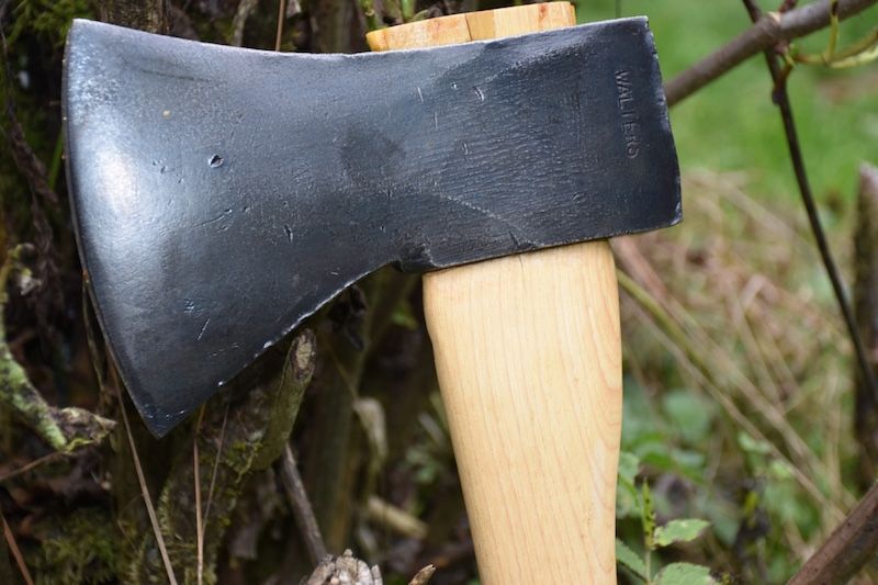

But first, the axe. The Walters cleaned up really nicely. A cupped wire brush took off all the rust and left about half of the patina. I blued the head after that, then oiled and sharpened at 40 degrees inclusive.
The haft grain is not perfect. The butt grain looks good, but there is runout at the top of the haft.
Yes, my sander left a burn mark taking off the varnish.
Then I put in the cross wedge. I didn’t really know what I was doing, but the haft didn’t fill in the front of the eye and the cross wedge filled that gap nicely. Then I split the cross wedge with a chisel and drove in the long wedge. It went in hard. It broke it into three pieces. Must have the wrong technique (smooth-faced finishing hammer).

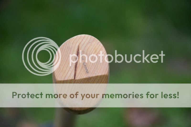

The cross wedge went in easily and filled the eye, but it was too thick and it cracked the haft.
It’s a little hard to see, but you can see that the crack lines up with the cross wedge. Given the grain runout, it seemed a serious defect, not to mention embarrassing.

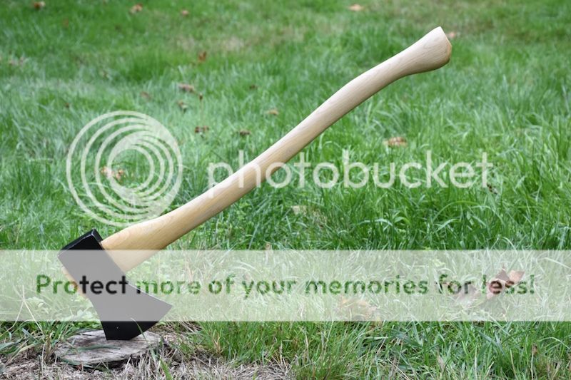

So at this point, I knew I’d have to rehang it. As an idea, I drilled a quarter inch hole through the haft, parallel to the head, and glued in a dowel. My thinking was that the dowel would block the weakness of the grain runout and prevent the crack from spreading. Unfortunately, the dowel was partly rotten and broke off before it could go all the way through.

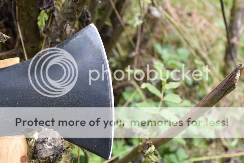

The edge turned out pretty well. I used a belt sander, with a 40-degree inclusive guide. That angle is a more acute then the original grind, but it should be fine.
Also have to give credit to my helper:
So, yeah, I screwed it up. One big issue is the kerf. I used a Japanese pull saw to make the kerfs. It’s pretty thin (0.018 inches). I tried a hand saw with a larger kerf, but the wood is too thin for a slow blade. Hickory likes to splinter. I’m guessing that a power-driven blade with a larger kerf would be perfect, but I don’t have anything appropriate. I tried a chop saw, but couldn’t keep the haft perfectly lined up without my eyeball being an inch from the blade.
I’m also thinking that the cross wedges should be two separate wedges (four with the double cross wedge). I don’t know how to pound all those wedges in (3 for the single cross wedge and 5 for the double cross wedge).
And it seems like the bottom of the kerf could use some help to keep it from splitting — maybe some glue at the bottom of the kerf, maybe an eighth-inch hole with glued in dowel.
Advice is welcome. Insults don’t bother me, unless they are about my helper.
Looks fine to me! I've got a Walters similar to that, and for a thick axe it chops darn well. It looks like you had more room to slide the head down the haft?
The head is fine, but the haft is cracked, and the crack is in the grain runout. I don't think I could have slide the head down much farther. I sanded the haft pretty good. As it was, I had to extend the manufactured kerf by about an inch.

That cross wedge, which I put i first, really tightened things up, making the long vertical wedge difficult to drive in.
On the plus side, the portion of the haft above the eye mushroomed quite a bit. I don't see it coming loose. Ever.
The point of this hang for me was to do it correctly, not just get an axe up and running. I wanted to see if I could pull it off. I'll get it eventually, but I'm not going to use a cracked haft.

Run what ya brung! You did a nice job on this. Either the crack resulted from a less than snug fit of the back of the head against the shoulder of the haft, or the wedge was driven in too far. This has happened to me on occasion and the resulting hang survived plenty long enough to succumb to some other problem (typically poor grain orientation or grain runout) before the crack ever did anything. Next time, instead of installing a dowel, clamp the handle firmly over the crack and install a wood screw to keep the split from wanting to creep along any further.

I pounded in the cross wedge first. It went in easily, with just a couple taps. But it was a little wide. I split it with a chisel so I could drive in the main wedge. But because the cross wedge was too wide, it created pressure on the middle of the main wedge. The small face of my hammer, as I moved it, broke the wedge because the cross wedge was acting like a fulcrum.
When I rehang this axe, I'll try to pound in the wedges more evenly. But with a five-wedge system, it may be tricky.
Were you using a sharp rip saw? I'm not sure what you mean by "the haft splits would splinter".
The saw was sharp, but more of a cross-cut saw. The grain orientation was mostly vertical. The split part of the haft that slips into the eye has two splits, one on the right and one on the left. At the front of the eye, these splits come to a convex point, and that part of the haft is very vulnerable to splitting off splinters. In my case, I lost a pretty good chunk at the from of the left split. But even when I was crosscutting the kerf for the cross wedge, it was hard to avoid splintering the wood. Only very fine teeth allowed me to make the cut. Maybe the hickory was too dried out. I don't normally work with hickory.

I'm pretty sure I can get the haft to the point where the crack won't spread. I could redress the dowel hole and glue in a fresh dowel. I didn't want to use screws because it would give the axe a cobbled together look. But it is still a cracked haft, and a sure sign that the hanger didn't have all his ducks in a row.
