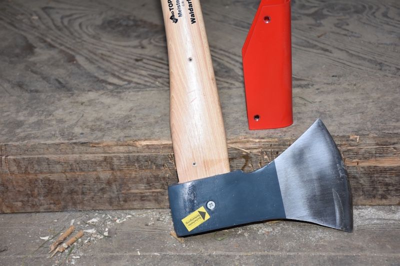

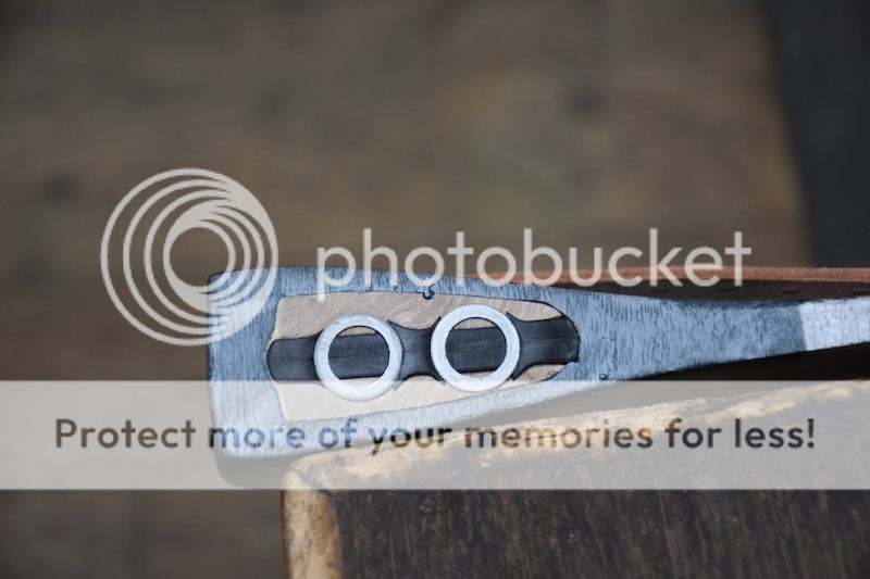

To illustrate the metal vs fitted wood wedging systems, here’s a Helko Topline axe that is an absolute beast.
You can see a massive plastic wedge (I presume kerfed), with two giant circular metal wedges. There is more wedging hardware on the top of that haft than there is wood.
And that’s not all.
There is also a screw that on the side of the head that further attaches the head to the haft.
You’ll also see an overstike plate that I have removed for the photo. So the massive hickory haft has five screw holes, a giant plastic wedge and two large metal wedges.

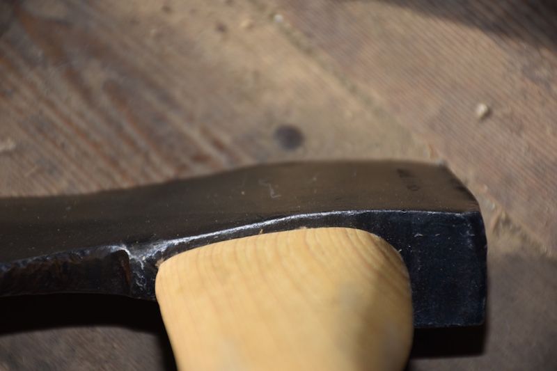

But now look at the fit of the head:
Helko needs all that hardware because the haft is not well fitted.

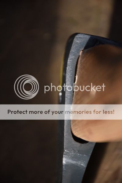

Compare that to my fitting:
I don’t need all that metal hardware because the haft is well fitted. Of course, Helko has to compete in a commercial market, so adding metal hardware versus laborious, careful fitting keeps its axes competitively priced.

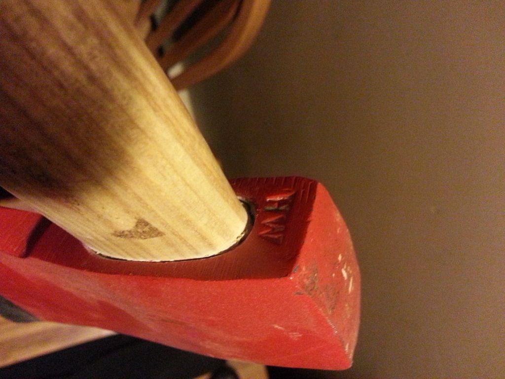

Shocking! Ah, Helko...lol. :thumbdn: Not the first time. Here is mine that they tried to cover with filler that fell out after the first use.
Yes, my Helko has some kind of filler at the poll end of the eye where the fit is poor. There is no filler on the other three sides because those sides are covered up by the over-strike plate.
