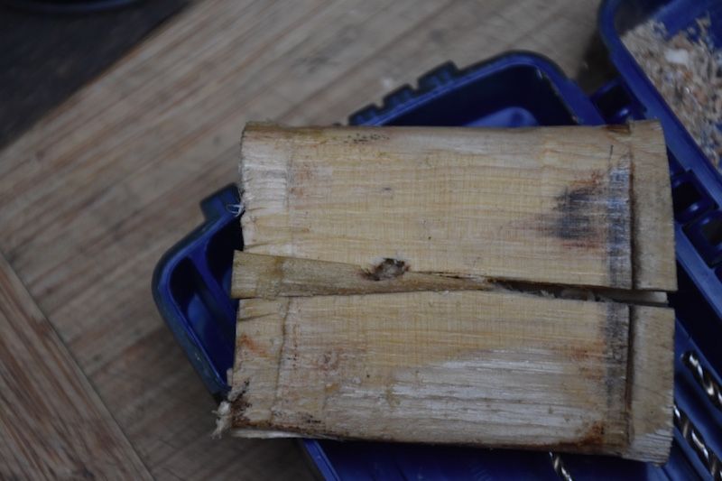

I took the head off the haft of my failed first attempt. The cross wedge did split the haft, as I suspected, largely because I was trying to move too much wood too far, especially with a short kerf.

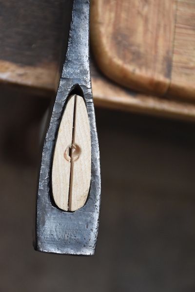

Then I rehafted the head on the house-axe sized handle, using a double cross wedge. It didn’t go well, except for the basic fitting.
Even without a wedge, the head was on very tight, and the lower haft-eye boundary was completely filled. The top of the eye was quite loose, but that’s because the eye is wider at the top.
The side-to-side gap can easily be taken up by the main wedge, but there is quite a bit of space at the front of the eye. It is this space that the cross wedges are designed to fill in.
But it didn’t work.
I didn’t make the cross kerfs wide enough. I cut them with a Japanese pull saw, which leaves a very thin kerf. By the time I drove in the main wedge to about a eight of an inch proud, with just a bit more to be pounded tight and flush, I could not drive any of the cross wedges into their kerfs. And the pressure from the main wedge effectively blocked the cross wedges from penetration. Even when I tried to drive in a screwdriver to widen the tops of the kerfs enough to get a wedge started, I could not do it. Nothing would move because the main wedge held everything so tight.
The space at the front of the eye is mostly filled by the wedge, but that doesn’t strike me as a good solution. It’s just filler with no holding power.
This picture speaks a thousand words! Stay clear of cross wedges unless a kerf has been cut to fully accommodate them, and make darn sure the wood fit at the back of the head is as tight as possible, or even slightly compressed, already before wedging.

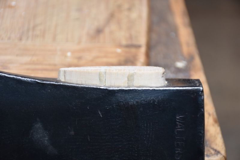

I cracked my first haft because I had to move a lot of wood in the haft a long way. This time, I didn't have a defective factory kerf and the fit was nearly perfect.

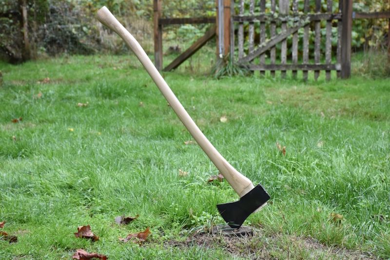

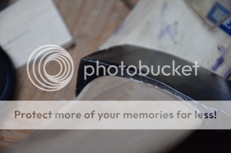

Not perfect, but success (before sanding and oiling)
And a pretty tight fit
I hung it on a 36-inch House Handle haft. The grain is horizontal, and there is some runout. I have some ideas about how to mitigate for a less-than-perfect haft — probably drilling cross grain and gluing in some oak dowels. I’ll probably need a drill press to do it accurately.
And I still have to sand everything and soak it in boiled linseed oil.
I’m thinking about staining the wedges before oiling so they contrast with the haft. I’ll need a fine watercolor paintbrush to pull it off.

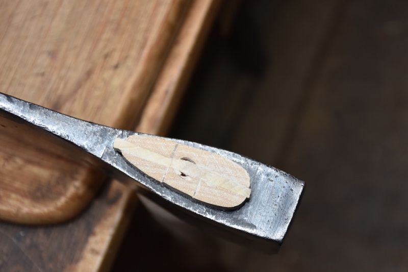

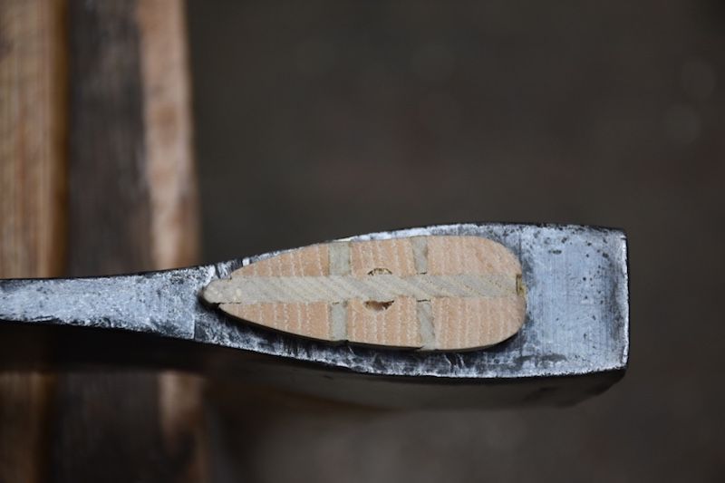

I ended up going with a full main wedge, mostly because my initial fit was so good and because physics seem to dictate that the main north-south wedge needs to be intact for a tight fit. For the cross kerfs, I used a chop saw. I double-wrap taped the haft tight with masking tape to avoid chipping. The cross wedges are each separate wedges fitted for their individual slots. The wide kerfs on the cross wedges really made this easy. I left the main kerf narrow, as it was from the factory.
I did some test chopping, with swings as hard as I could manage. Nothing moved.
I appreciate the help I got in this thread.
I’m pretty sure that the main wedge is not going to move. I finished hammering it in with a four-pound sledge hammer. The cross wedges further jammed everything together.

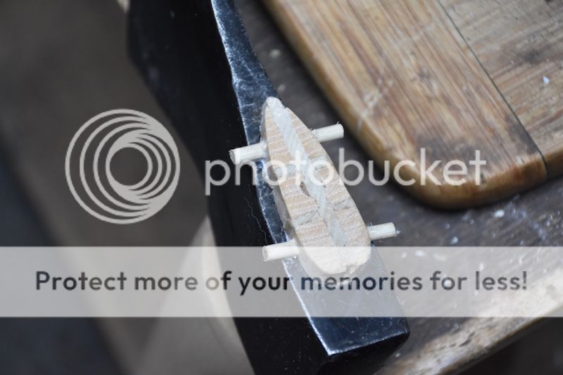

But because I’m trying out ideas, I drilled a couple 3/16th inch holes through the haft just above the eye and through the main wedge, then glued in a couple oak dowels. When the waterproof glue dries, I’ll cut the dowels flush and sand everything. Then I’ll soak in BLO to further tighten everything up.
Man, that head us on for the duration! Of course you'll never reuse that haft even if you wanted to. Nice recover.

I think you're right on the main wedge. My initial theory was that the cross wedges would add some clamping pressure in the north-south direction, but once the main wedge is driven in, not much else is going to move.
If you drive the cross wedges in first, they'll go deeper and move some wood, but then they limit how far you can drive in the main wedge.
I've come to doubt that the cross wedge, as I did it, adds much utility for head security over just a single main wedge. With the elongated shape of the typical eye, all the clamping work is done in an east-west direction. On my double cross, the cross wedges mostly just fill in the crosscut kerfs.
Where a cross wedge would have a lot of utility is in axes with round eyes or square eyes.
