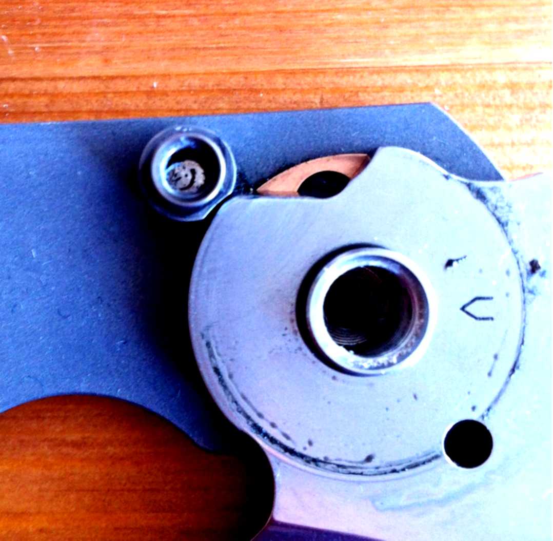

Hi guys,
so he is the deal - I attach the picture to illustrate it.
On the picture you can see that a stop pin has some kind of notch that allows the blade to move without touching it.
First question - why to do these complexities when good old round stop pin has worked excellent? Doesn't Sebenza wasn't always a synonym of simplicity in a knife world?
Second question and the main reason for this thread - it is happening that during use this stop pin turns a bit, and then things become really ugly, blade starts hitting it during open/closing operations and you hear cracking sounds. And there is no solution for holding this stop pin still.
After seeing this I must say that this knife is a real disappointment for me.
What do you think about it?

A question is that you don't see the issue yet and what warranties that it won't show up in the future. Have you taken your knife apart? How the stop pin is made, does if press fit and stuck dead in a scale or could it be taken out?
The original ones were press fit in, the newer version has a screw on each side. Look around the CRK forum a little bit and you will see many threads on the variances from when it was released to what is offered now. The differences are very slight.
So the one I am talking about has screws on each side. So it is natural that pin can spin a bit and bacause that tolerances are so high it causes problems right away. Looks like a construction flaw to me then.

My 18 Jun 2013 25 stop pin can spin but I am not sure if this is a defect. It does make cleaning a little more challenging.
It jammed on me when I put it back after taking it apart. The stop pin has turned a little when I put it back. It did give me a shock when I can't open the blade. I only noticed this design after I took it apart again to investigate the issue. However, it has not move since I put everything back.

My pin moves after I put it back. I think it moves together with he screws. This whole unit of screws+pin is turning around after playing with a knife for a while.
If it is still turning after you tightened the screw, you should send it in.

I have both the press fit pin, and the version with screws on both sides. I haven't taken down the two screw version yet but if yours is hitting it needs to be sent in for repair.

That does seem like an odd design choice, I can't see any reason the first arc of the the blade tang itself that needs to pass the stop pin flat could not be reduced by what 0.1" at most to clear it without having to notch the pin, except it looks like the detent might ride very close to the edge there. The ceramic ball lock bar certainly isn't using that bottom 0.1" of tang for lock up. If a notched pin had to be used I'd think ideal solution would be to notch the pin/handle interface as well so that the pin cannot spin in the handle, even if a screw should loosen, but I'm not a knife maker and it would probably increase costs and time in manufacturing. Plus if yours is loose even with the screws tight well that's a double whammy.
It reminds me of the "multi-flats" stop pin BM tried on the 760 where guys were rotating it to change the lockup and some rotated on their own, but I've seen more than one of them where that pin had rotated and screwed up the lockup or disabled the knife. Any non-round stop pin seems to cause more problems than they are worth, Murphy seems to enjoy messing with them.
On the plus side there's no doubt that CRK will fix the problem for you, and while every company at every price point has problems I'd have to say that for $450+ I'd hope a rotating stop pin would not disable my knife. I'm not sure how much it would cost in manufacturing to either allow the use of a round pin or ensure the notched one cannot move but I'd think at that price point owners would pay a bit more for the peace of mind.
