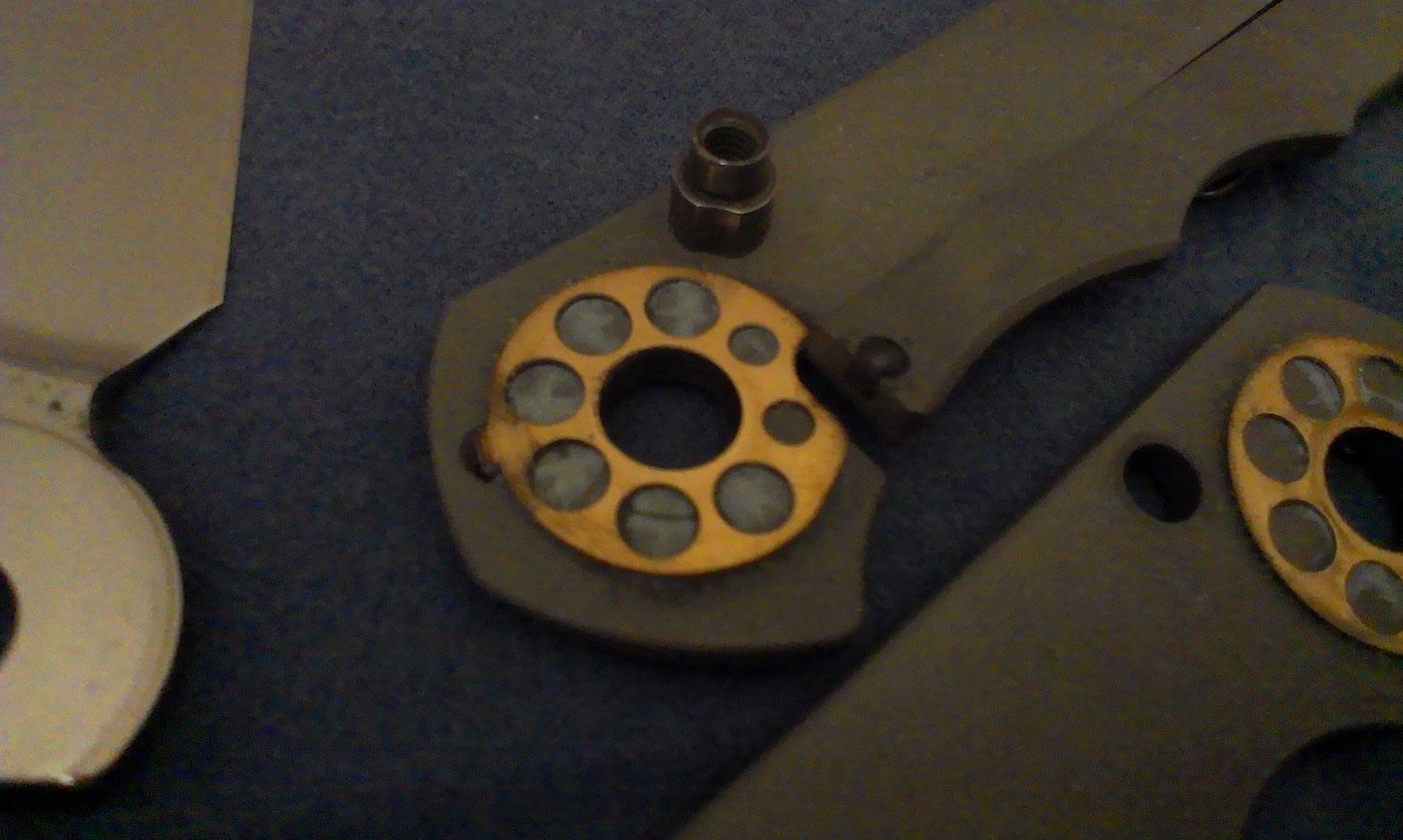

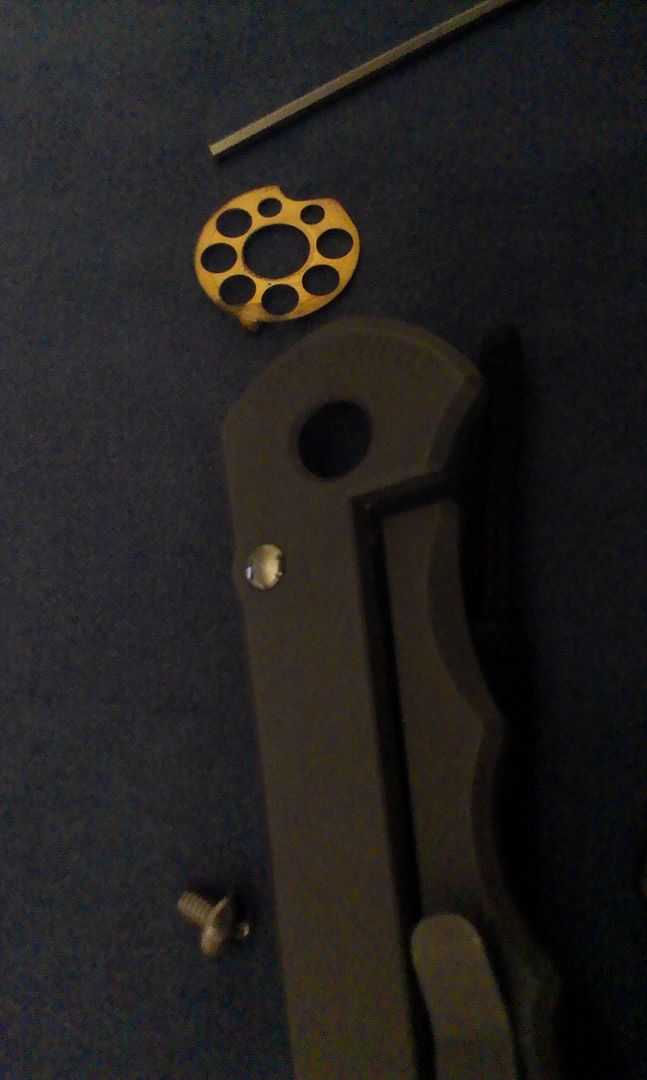

So I was looking at my knife and I realized that I didn't understand the op's initial complaint.
This is the inside of mine. Sorry the quality is crappy, bad light because the baby was sleeping.
I thought the notch was for the tang to settle against when open. When I looked at my pin the notch didn't seem to line up with the open tang so I had to look at the initial post again. Why is the notch there? As explained it sounds like it's a clearance notch? That makes more sense in my mind for why it's there to begin with, but I guess it doesn't change the fact that it spinning causes an issue.
The pin looks like this on one side of my knife.
