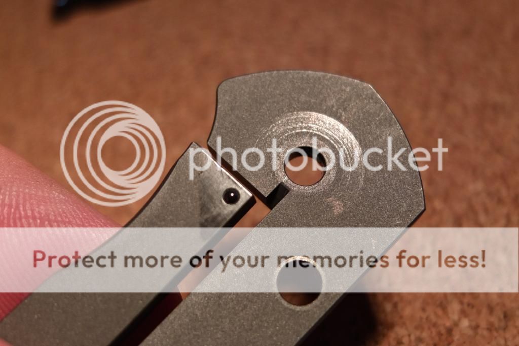

Ceremic detents? I thought the little corner of the lock bar was just heat treated differently than the rest of the titanium giving it that "darker" color you notice? But hell what do I know..
Ceramic detent
stainless detent
notice how one is dark and one is not dark. first picture is of a CRK of some type. the bottom picture is just some random one.
the reason im asking is because the ceramic detent glides better on the blade. if you cant flick the knife out your blade or detent might be dirty and may require some heavy duty cleaning. just a possibility, not sure if thats the exact problem, i asked because im not sure if they are stainless or not in the knives people are having issues with.
stainless = not flickable as much as ceramic
ceramic = should be more flickable.
but what do i know?

Awesome post man, sadly enough it sounds like most of the people on the thread aren't with us on this one.

There is a documentary on youtube which is like one and a half hours long and it explains all the details of the Sebenza, including heat treated lock bar and ceramic detent ball.

Y'all are 100% correct, yeah, detent ball not lock face treatment.
See, this it what happens when you get old, sometimes you need a visual to understand :eek:
It's funny if you actually open your blade to about a 45 degree angle you can see the little hole in which the detent ball rest in..not sure why I didn't put two and two together before lol.

Only the Umnumzaan, Sebenza 25 and Inkosi have the ceramic detent balls.
The Sebenza 21 has never had a ceramic detent ball.
This is incorrect and has been for roughly 15-20 years. A few years ago I mailed in a 1995 or 1996 Sebenza that needed work and one of the things that CRK told me the "had to do" was replaced the steel detent ball with ceramic. I was surprised and asked when they'd changed. I don't remember the exact answer but it was within a few years of Y2K one way or the other, IIRC.
I still have a couple of steel detent Sebenzas from the 1990s and I wouldn't say they're any more or less flickable than ceramic detents, but each knife is sort of its own case, so it's hard to say.
The difference between the Sebenza and the Umnu, 25 and Inkosi is the spherical ceramic lock interface.

The ceramic detent ball, which is a feature of all Sebenza 21s, it a big part of the CRK reputation for smoothness. Ceramic glides much easier over steel, than steel on steel. Steel grips steel under pressure (think railway locomotive), but ceramic has much less friction.
It's a popular misconception that the Umnumzaan or Sebenza 25 introduced the ceramic ball to CRK, but that is completely wrong. Those knives were the first to use the ceramic ball as BOTH detent, AND lockface, but the ceramic detent ball pre-dates both those models, and was a feature of all 21s to the best of my knowledge.

Maybe that's what I was thinking of the 25 and Umnum have a ceremic lockface.
IMO, all 21s should break in with use and proper cleaning and maintenance, and should eventually be flickable and even free dropping. It's a testimony to Crk's design (ceramic detent ball) and tolerances.
If your 21 isn't flickable and it's your edc, it likely needs cleaning and degreased.
