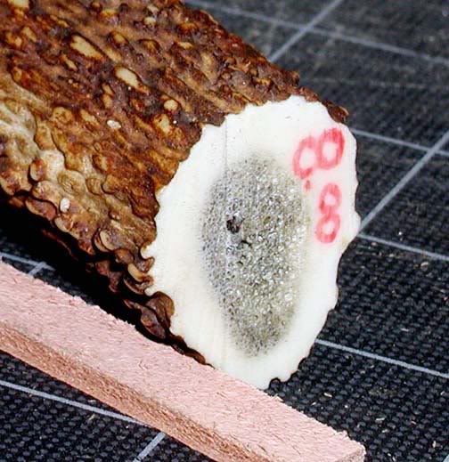

They are closely related.
Rusa smaller beast but has large antlers.
They are very solid with a pithy soft core.
A good sized piece can be split by sawing.
I go slow with a hack saw.
One disadvantage is the brow tine. It kind if gets in the way of the crown if using as a feature.Unlike Red deer the antlers dont seem to grow new point each season. They get to 3 and just get bigger.

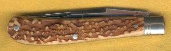

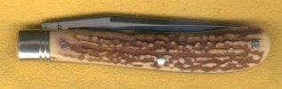

Yeah I remember that photoOne of our fellow knife people, currently MIA, sent me some spikes of Red Deer antlers from NZ, several years ago. I had a respected knife artisan/mechanic put some on this Diamond Jack back then.
No names are mentioned because I am unsure of the allowability of all this. The antlers were not treated with Potassium Permanganate (PP), nor were they flame treated, but I treated them with methyl alcohol, to protect our environment.
The Red Deer is the fourth largest deer worldwide, behind the Moose, Elk and Sambar, and are very plentiful in NZ. They were introduced several generations ago, along with several other species. The samples I got, along with several other examples I have seen, have a lot of "popcorn"-like feature to them.
I conFess I have seen pictures of the stash these handles came from, and it looks like an old Sheffield cutlery "Stag Room!!I wonder how they would look if treated with PP??
