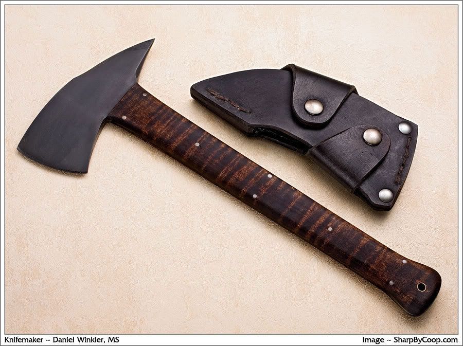

Recently this changed with a special project I took on. As many of you know I am making a Breaching Axe for the US Navy Special Development Group. In order to be able to outfit the entire Team in a reasonable amount of time at an affordable price I contracted out a few operations. I have the profile of these axes water jet cut and some milling done on the handles and the head. To designate these as "mid-tech" I use a special touch mark, WINKLER II rather than my usual DW or DWinkler. This is a very limited and specialized project but I am considering expanding this line with other knives and axes not for the military.

Here is a picture of the Navy Axe: S-7 steel, full tang, 13" overall length
Daniel that is an awesome looking axe, will that be an offering by request as well?
