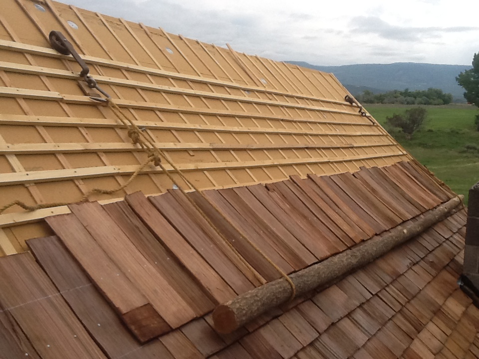

Hi Parker, a trip to the international airport has kept me away and off the roof for a few days and among other interventions brought progress to a temporary halt. One of those relates to a forced improvisation because the roof covering I'm working on isn't so conventional and I end up having to manufacture my own components with some inhearant constraints as a result of my peculiar situation here. Well, it all comes down to an increasing anxiety about getting the roof closed up before it snows. Still, I'm on the road to progress, the alternative axe being a definite improvement.

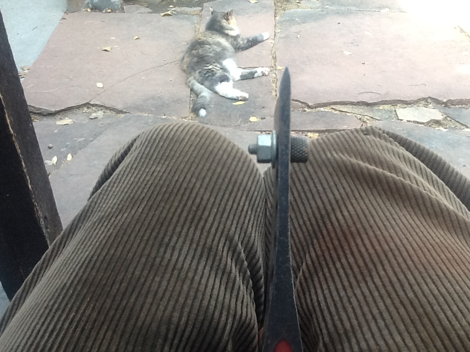

Here I was on the verge of a crucial insight concerning Plumb's axe but it came to late and I've lost the gage pin's nut now rendering the axe incomplete like 90 in 100 of the ones I'd seen.
For further reference the gage pin should only be inserted in its slots at the time of making measurements. It shouldn't even be there for use while hammering and definitely trimming, which I do do, trim that is.
I think I’ve got a couple Estwing gauge nuts, if that would make it functional again. Or I could turn you one if I knew the pitch.
I don’t think it’s realistic to expect roofers to constantly remove and re-attach their gauges, but I’ve seen several on the job held on by wing nuts.
Parker
You know vvould be a neat resolution, maybe, is if the pin were loaded with a spring. I mean it's either constant removal or constant attention and resetting as it works itself loose and my simple mind is occupied enough making sure I keep the offsets and overlap sufficient. It could be me and my technique though. On top of it all, with the pin in like that it's having a bad effect on the hatchet function to the point of rendering it nonfunctional in practicle terms. Maybe improvisation is the only alternative, it's just that I absolutely dispise improvisation, almost as much as, what do you call them, oh yeah, tape measures.

So with the gauge pin installation somewhat satisfactorily resolved the contradiction of the hatchet function returns. Which begs the question of the origins of the conflict. Is the primary function of this design gauging the exposure or trimming the shingle? I come back to the practice of only temporarily engaging the gauge pin.
