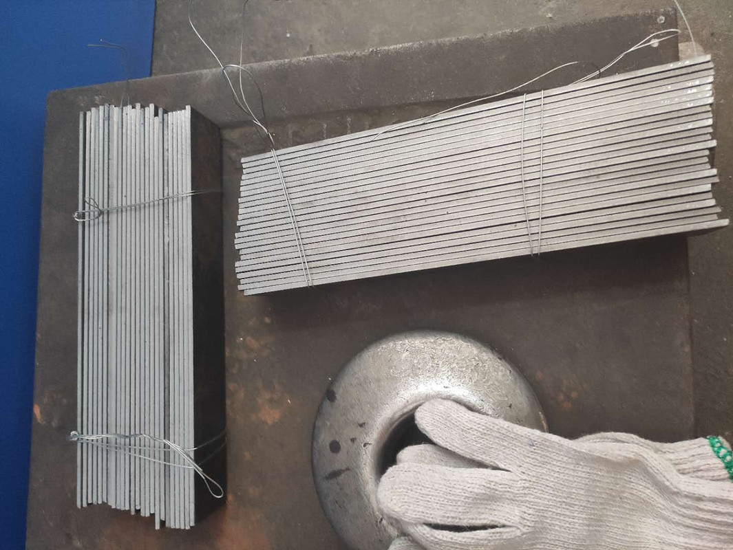

With this in mind I started looking for a supplyer, and that turned out to be alot of "rejections". As the chinese are super polite, they don't wanna say no and turn you down.
On the other hands, I was not looking to buy ton's of steel. But a "sample" around 25 lbs, and it took me some time to find dealers who where willing to deal in that small amounts and had the right alloys.
Finaly I found one, that had 1084 and was okay with the small amount.
The second I mentioned I was gonna make knifes, she showed me pictures of billets they already made for another customer. Bingo!
Now I had to ask if they could sell me some 15N20 as well, but to my surprice that was not an option.
From that I concluded that they where not just gonna sell me something, labled as something else and went on with ordering the 1084.
There's still a chance it's no good, that it got odd inclusions and what other issues I have read about it.
But I think for learning, it's not gonna be a total waste. Either way, I will be all honest about it.

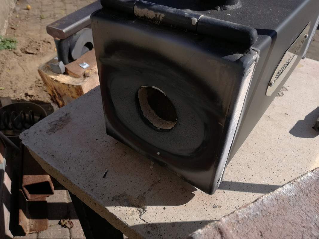

Canister cracked in the middle tho
I didn't notic untill I saw something odd n liquidy in the bottom of my forge.
My guess is I got it hot enough
Looks like the 440C powder, maybe melted and some ran out the crack.
Not sure, I know next to nothing about metallurgi.
Im gonna try an weld it up and hammer on it some more!

I would suggest you learn a lot more before proceeding any further.
You aren't likely to have any success filling a can with 440C powder and ball bearings and hand forging it .
440C melts a around 2700F and won't flow until probably 2800F. That isn't likely melted metal. Maybe it is melted refractory or flux? Did you coat the wool with satanite yet? If not, that is melted mineral glass.
Thanks for your reply
Yes the forge have been coated with refactory cement a few weeks ago, then did a short test burn yesterday.
Haven't taken any pic's of the cementing, as I figured everyone have seen that a hundred times before.
What ever melted into the firebrick, seems to have come from the canister.
There is a small "squirt" on the side wall where the refactory cement, have been hit and it have melted/burnt a hole.
No flow pattern from that, to the large puddle on the firebrick.
I didn't add any flux, only ball bearings and the powder.
Had a brick blocking the back hole in the forge, not sure if that was a good idea or not.
