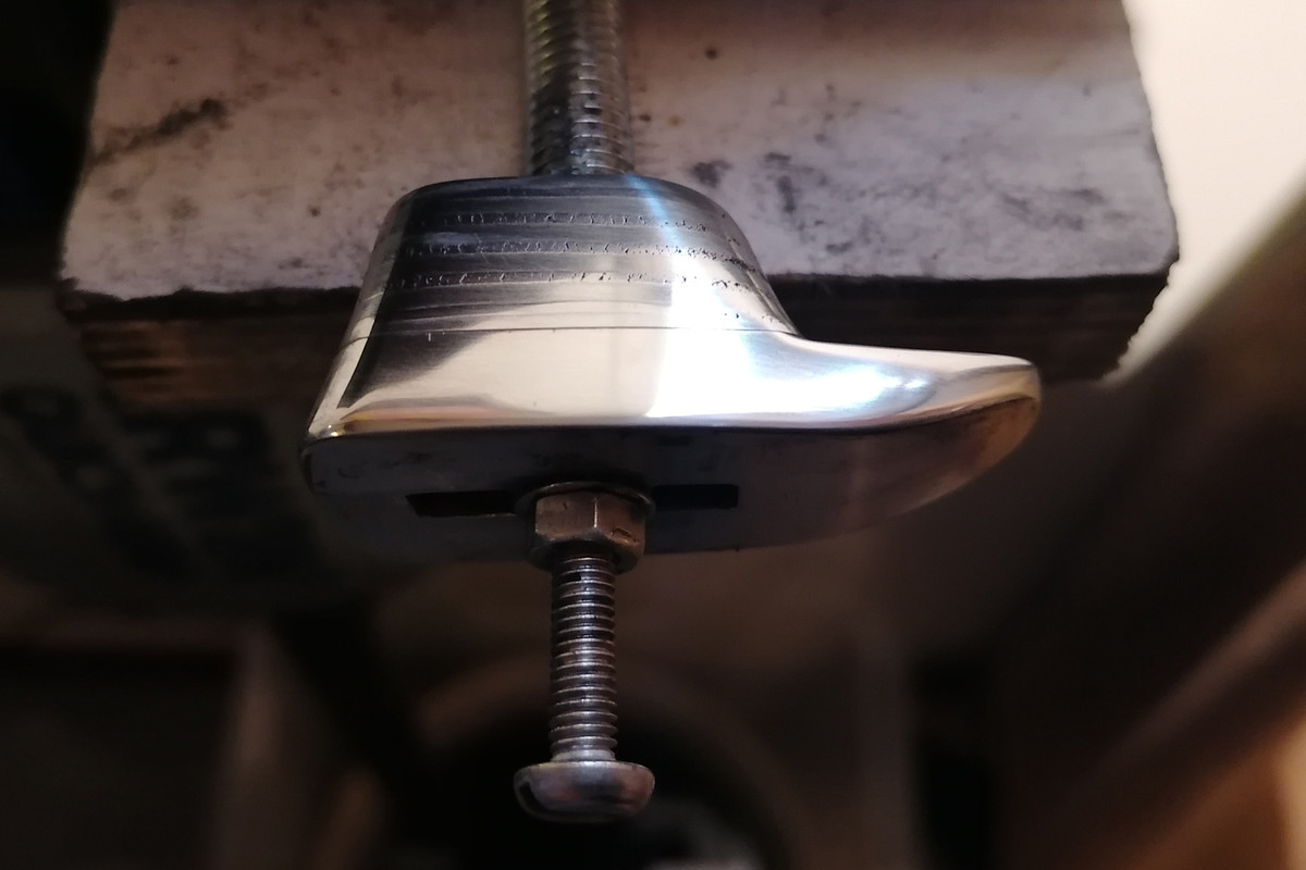

The guard/bolster is slowly getting there, done with the 800 grit and ready to dip in ferric chloride.
Gave it 10 minutes in the acid, as I did with the blade.

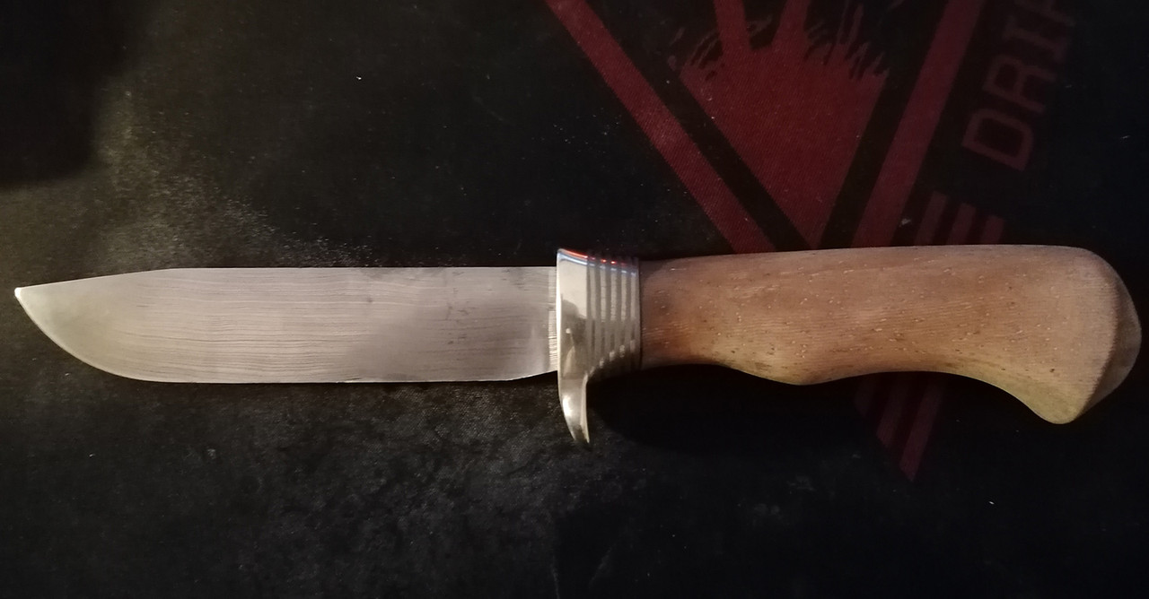

Still not happy with the handle end, so I will try to "flatten" the butt a little more.
Then I guess it will be time to give the handle some oil, let the blade and bolster sit in coffee.
Put everything together, give it a polish and put an edge on it.

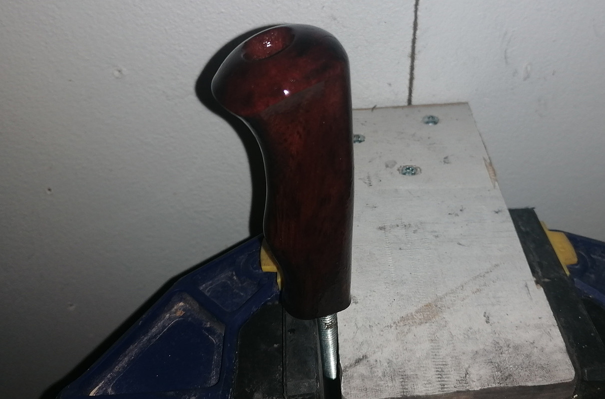

Final coat of oil, it's been soaking in a primer oil for a few days as I don't have a vacuum setup.
Air dried for 24 hours, now the final top coat will harden.
Giving the handle a strong and long lasting finish, that will repell water and protect the wood.
Im using a two part marine hardwood oil, that I have had good succes using on my boat.
I wasn't happy with the final coating, so ended up redoing the final coating.
Im used to work with this oil in the summer, and then it's not an issue but in the garage in November.
It makes a great deal, preheating the final oil layer so it only make a thin film layer. First try looked and felt more like a bad epoxy coating, and that was a shame.
I could have polished it, but the natural feeling of the woodgrain was totaly gone.

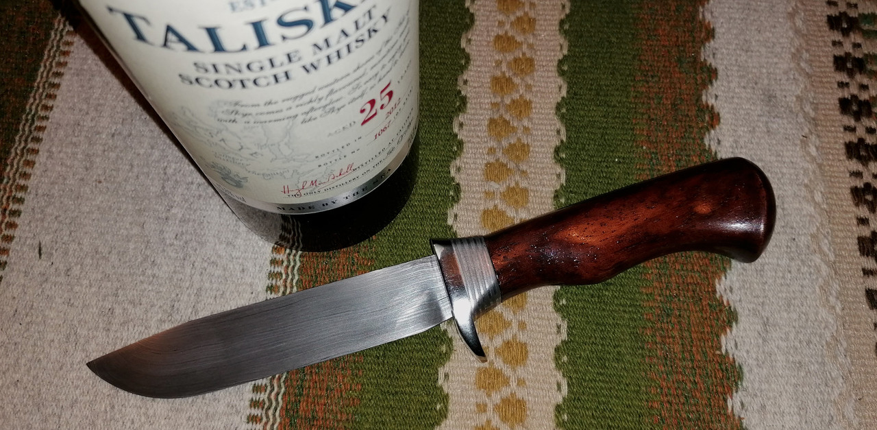

For my 3rd knife and first damascus blade, im pretty happy with the turnout of this project.
Id like to say thank you to everyone here, who have been helping me out along this knife build. You all ROCK, thanks for being you!
