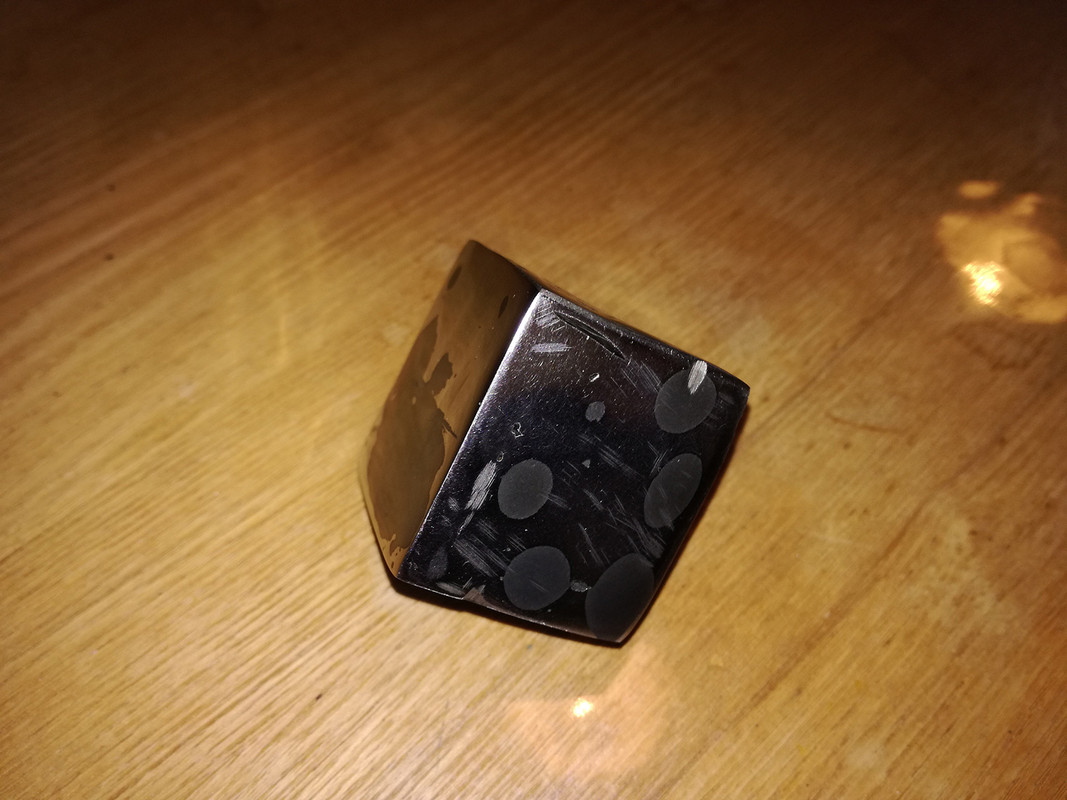

The puddle looks and feels like metal, looks very much like the suface of the 440C bits that fell out of the billet. And when it happend, it looked very much like it came out of the cracked billet.
Im thinking maybe there's some flux material in the 440C powder, if it's even 440C powder and not some weird china alloy.
I have not seen anything like this online, but it don't look glassy at all.

Hmmm, I can't say that I ever tried, but I seriously suspect that you won't melt 440C in a canister and have it flow out like that. If the 440C melted the ball bearings would have melted as well. Generally you need an induction furnace and gas shielding to melt/cast stainless steel. IIRC, it melts around 1400-1500°C 2600-2750°F). A really good forge will run at that temp, but it will also eat up the refractory fast.
The sooth shiny puddle looks like brass or some lower melting metal like pewter? If you take a sharp pointed tool (chisel or graver) and push it into the puddle does it make a mark or dig in? If you peel the puddle off the tile, can you bend it easily?
I know this sounds silly, but are you sure the can of powder wasn't 440°C (825°F) powdered solder or something?

The powder was from a company selling atomized steel powder, for induction furnace smelting and injection molding.
I have looked over the order and conversations, what I ordered and what is talked about is 440C Stainless tool steel.
If there is something else in there, I have no way to tell. But it's deffently not soft, it won't dent, bent of even scratch very easy.
A small piece from inside the billet, have been stuck between the canister and some ball bearings.
Next to the puddle on the firebrick
Took a file to it, to grind down into it and get a flat surface.
After a good while I took the angle grinder to it, as my old file wasn't doing much to it.
Then gave it a little sanding on some 400 grid I think, the writing on the back was pretty faint.
Now a quick rub on the puddle revealed, I have made Damascus Firebrick :confused:
Not seen anyone do that before, so im pretty proud about that ..(Happy Viking Dance).. not sure if it will make a good blade tho.

Don t blame ball bearings :D
Here's what happened...........I think :) It is much easier to melt powder steel then solid steel....and you prove that :D 440 C powder steel get to temperature much faster then balls from solid steel .Your forge run very HOT and simple melted 440 powder before balls get to same temperature .Next time try to slowly heat canister so everything inside can get to same temperature ....
