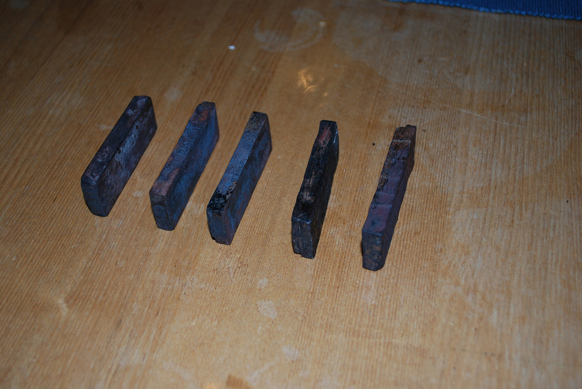

Moved the 40 layer block out, after removing two weldbeads from the handle.
Folded the "mini" billet a final time, hitting the 80 layers, forgewelded it and moved it out.
Now im taking a break, not sure I will get back at it today.
But now I just need to make another 4 of thouse for my project
Been folding metal for the last few days, deffently feeling it in my lower back.
Left lower arm and wrist, from gripping the tong as well.
Better take a rest a day or two, before I continue with the last two mini billets.

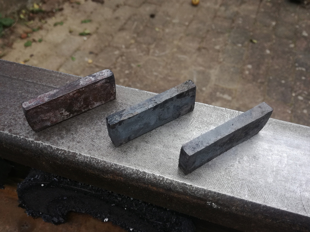

3x 80 layer 1084 and 15N20
Two more to go

Not sure the last two mini billets turned out as well as the first ones, but I still don't know as I only just got done folding them tonight.
It feels good to be "done", tho I still got a fair bit of forging to do. My forarms and left wrist is deffently not feeling as great, as the rest of me thats for sure.

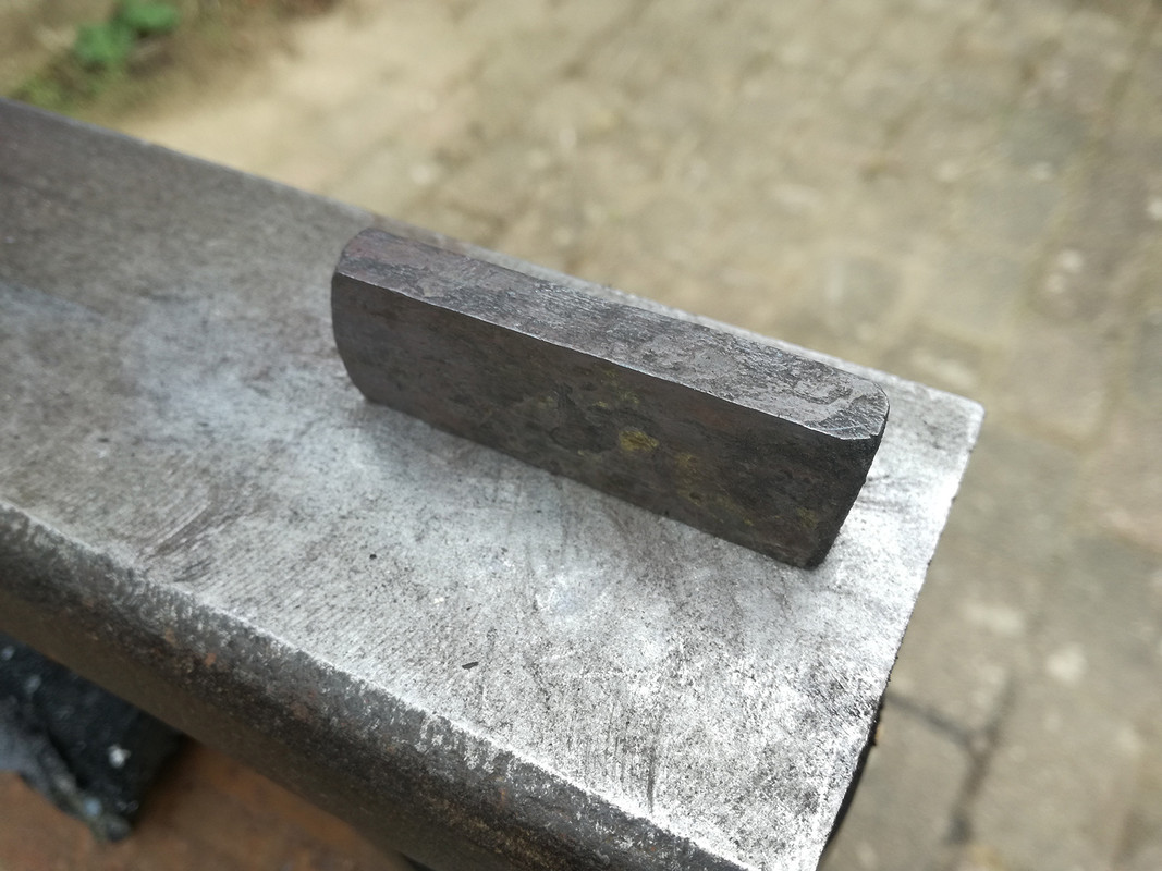

Cleaned them up a bit, just gonna toss them in a cup of coffee to see the pattern before I smack em together.
A few small cracks in the end, but haven't noticed anything on the sides.
Nothing that look like it's gonna be a issue, but what do I know this might still fail with glory.
Id clean up the surfaces to be welded with an angle grinder or your belt grinder first.
The cleaner your weld surfaces, the more likely you are to not have inclusions and gaps.
