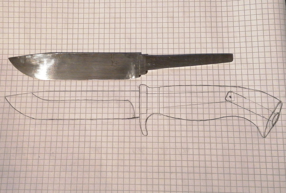

I still need to shape everything, but here is my idea for the handle.

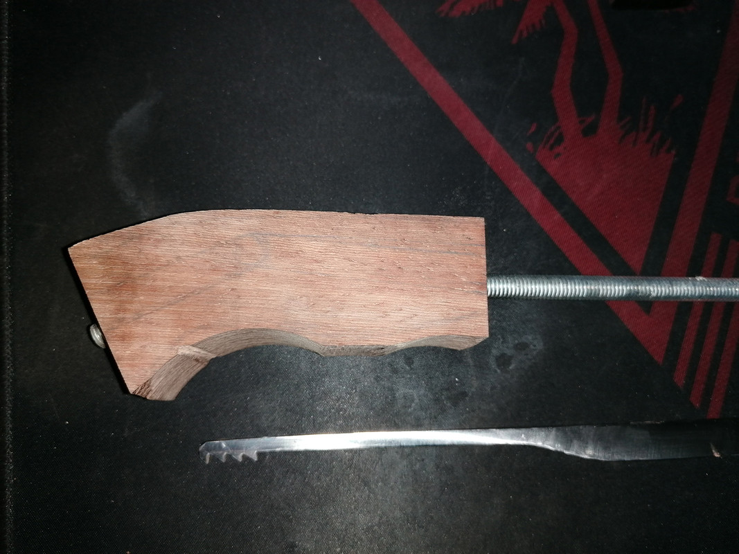

Before you make that extension i suggest you to check if it would work .Make tang and extension attached from some thin piece of plastic, steel whatever you have around and check if it can pass in that angle .I guess it will not work .You have narrow angle and long straight extension
Thank you Natlek, thats good advice.
My plan is to drill a 8 mm hole down the handle, and a 10 mm hole from the end.
Scrape out a channel for the tang, and try my best to round the bend that the M8 extension will pass thru.
I also have the option to use M6, but thinking that will give me a lot less work space.
It looks like your handle is much larger than the blade. I think it will overpower the look and feel of the blade. I like the look of the handle, it just appears to be too large.
Hmmm not sure how to scale it down, as I kinda traced it of one of my knifes that I feel I have a good grip on.
It might be a little big bigger, then what I drew it after but not much.
The handle end is a little bigger and wider, but I really like that down curved swell end. (That don't sound right at all hehehe , sorry for my lag of better terms)
So I drew that on, after I traced the handle to my best abilitys.

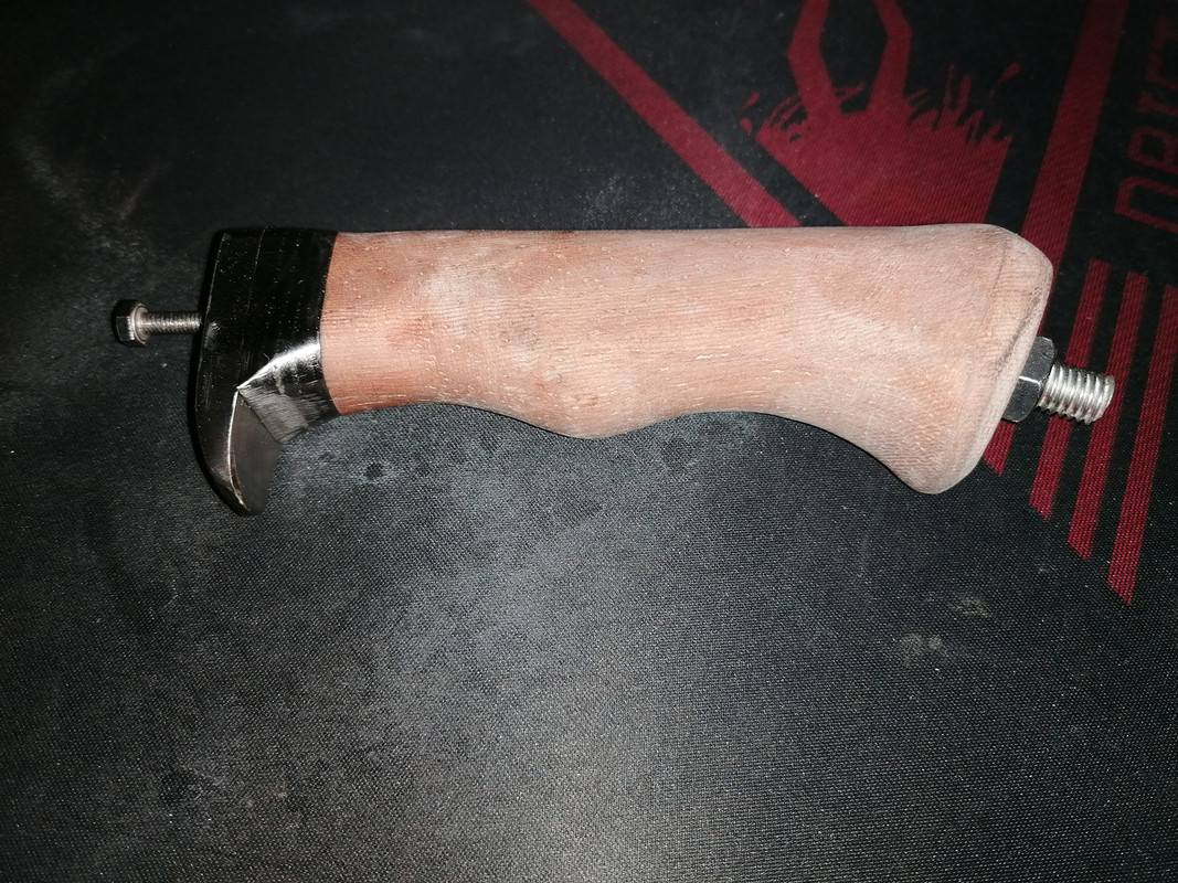

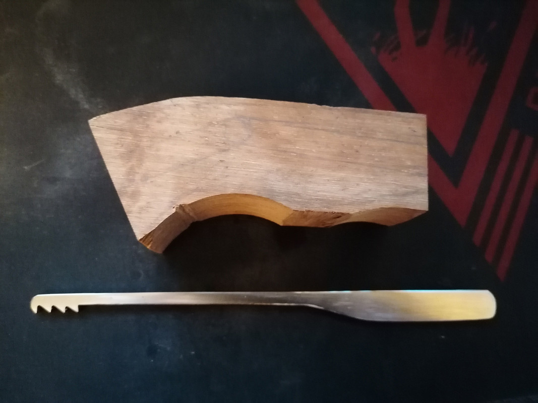

Got the handle roughly cut out, and made my first broach today.
Turned out all right, hardend the tip maybe a inch down the spine. Not sure if I should have hardend more of it, but I guess I will find out if it bends.
Also it's not as wide/thik as my tang, maybe .5mm thinner but I figure it's gonna be hard to hold it 100% straight.
Never used a tool like this, im guessing if I angle it I can widen the channel as well. Any tips, hint or links to videos on how to use it.
I've seen them in use, also seen them made. But not seen any detailed tutorial videos, so im guessing it's as straight forward as it looks.
It's deffently sharp, tested it on some of the cut-of from the hande. It dug right in and left a smooth channel, figure I might use that for a handle.

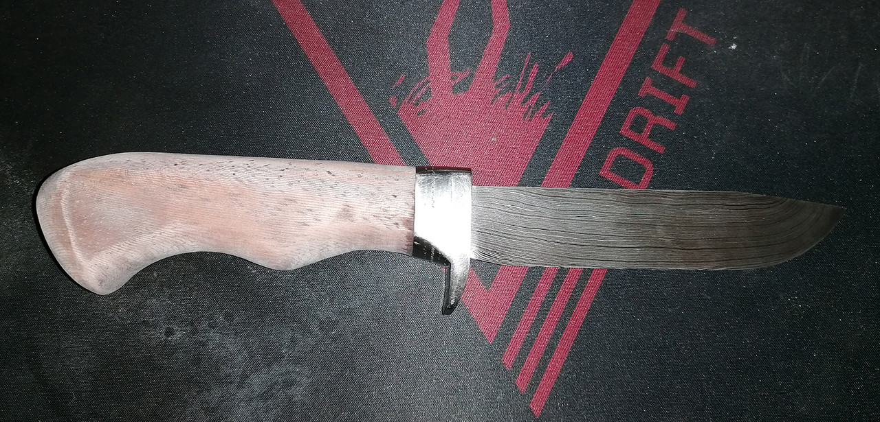

Still a bit to go, but over all happy with how the handle shape have turned out.
I need to shape the butt area a little more, but finaly working the emeril tape I have been waiting for.
It took a while to get here, and my budget didn't cover all the grits I would have liked to buy.
Still got a few grits to go thru, next up will be 240 grit and then 400 as I don't have any 320.

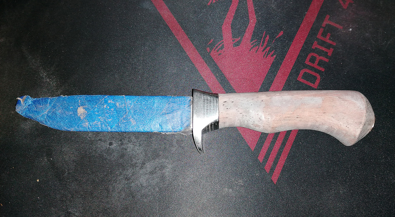

You did a good job. The following is not meant to diminish the good work you did.
Earlier I made a comment on the handle overpowering the blade. It looks like the blade is almost half the size it should be to match that big handle.
The spine should align with the top of the handle or at least be almost aligned. The handle extends far below the edge , and also, the handle is longer than the blade. A handle an be longer than the blade but it needs to be proportionate in shape and mass so as not to be overpowering .
With some more grinding and shaping you could shorten the handle and thin it out more (especially from the top).
I also feel the palm swell is far too large. It should only be a small and smooth increase, not a big projection. On that knife I think it would be best to grind the handle back with no palm swell.20201117_135909.jpg
No worries Sir, I much appreciate all the input im given by you and everyone else!
Someone pointed out to me aswell, that I need to aline the spine of the blade and top of the handle more.
So I will give that a try, and see how much I can or dare to remove.
The palm swell really feels right, when I grip the handle but it could feel/look totaly off when I change the hight.
As it looks now, it fit's my hand nicely and leave a little extra room for my fingers.
Im afraid if I shorten the handle, my pinky finger will feel the edge of the end.
