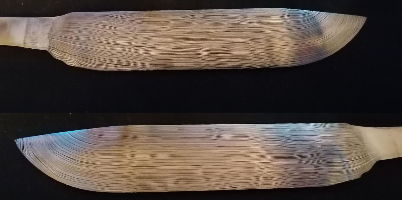

First etch, hand sanded to 1200 grit.
It's now getting a cup of coffee and I think, I will finish off with a light touch over with 1500 grit and then buffing.
Thank you for the positive feedback

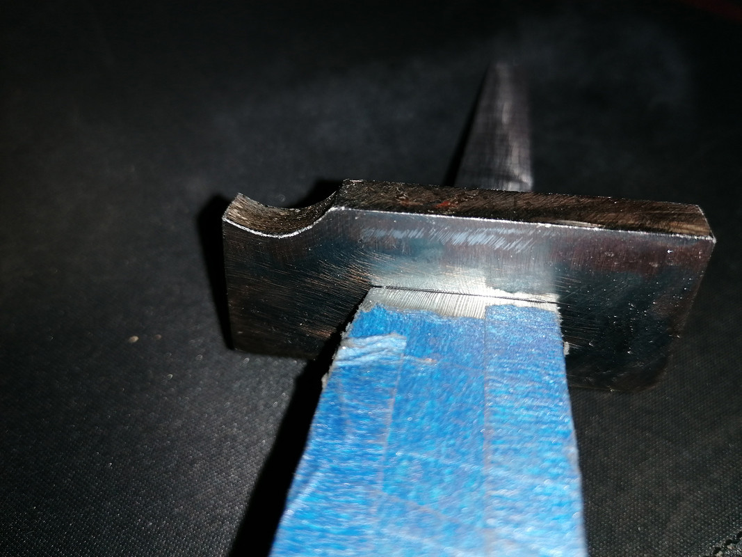

I have started to work on a guard, from some 8mm stainless scraps I found at the sailboat harbor where my boat is docked.
They have been doing a bunch of renovating, and learned by now it's not gonna be easy to forge.
My best guess is it's 316L or something in that range, as to my knowlage it's the most common used at sea around here.
Filing sure takes a bit of time, I haven't been able to find all the files I want/need.
Trying to my best, to get a good result with what I got.
Still got a bit of work left, on getting all the angles right.
The fit on the sides, I think turned out all right for my first try.
Might be easier to file and fit, picking something softer and thinner then 8mm Stainless.
But I figure I got that, it's free and again im learning. In this case maybe more like, refreshing old memorys from shop class.
There are tiny small gabs, but there is not a lot of light shining thru.
I can't wiggle it in any directing, and holds the blade in place so I think it will be all right.

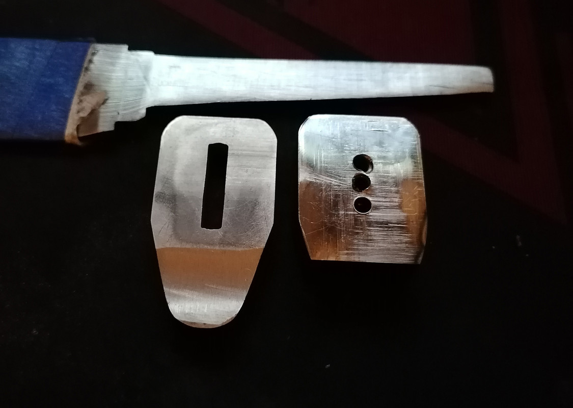

Working on the guard, I figured maybe I could use my 2nd failed attempt as a bolster.
After a lot of cutting and grinding, I think this could work out with a lot more cutting and grinding.
Coming along well.

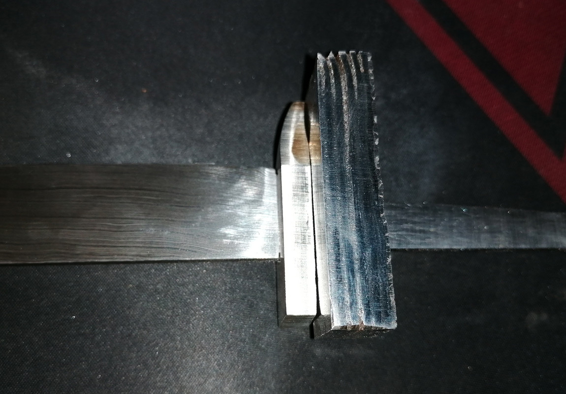

Be cautious of making the guard overpower the handle or blade. Petit and elegant wins most every time.
Also, I think you need to do something with that taper back at the ricasso. Maybe a smoothly sweeping choil?

Thank you Sir, I am slowly taking each step to make sure I get as good a result as im able to.
The guard have been trimmed down a fair bit, I wanted to make the slot fit before I did too much else. In case I made a big mess of it, it would be a waste of time shaping everything up.
Also I have experianced the 1084 and 440C stainless damascus, is next to impossible to drill as the 440C just burns up the drill bits.
I've tried with a diamond ball tip, and after a hour of drilling I got no where.
I can get thru the top layer of 1084, so the damascus spacer might be a pipe dream.
As I don't have the equipment, I can't controll the temps needed for annealing the 440C.

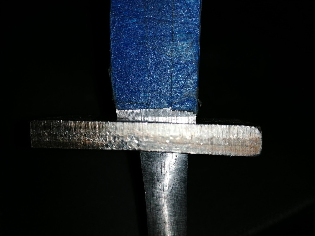

All right, holes have been drilled.
Only took about the whole day, but found a pack of masonry drills in the back of my cabinet.
That anyway wouldn't fit my drill hammer, so reprofiled them and got my way thru the damacus and every small masonry drill I had.
Still need to remove the side walls, but I am out of tools n drills small enough.
Will see what I can pick up tomorrow, tho the place I normaly would go to for drills are closed.

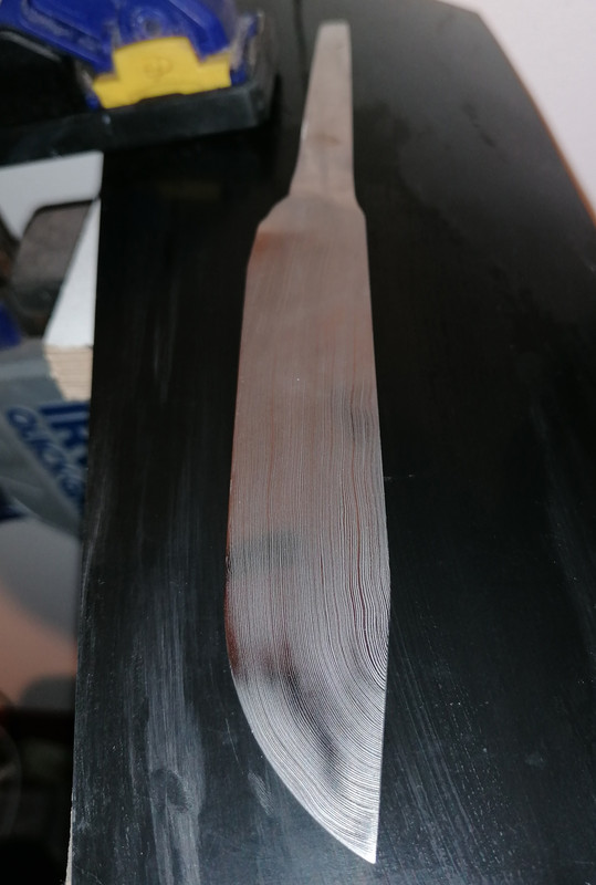

Got bored and started filing it a bit, while watching a movie last night.
So taking a relaxed sunday, maybe handfile a bit more on this a little later.
