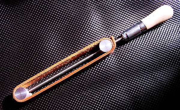

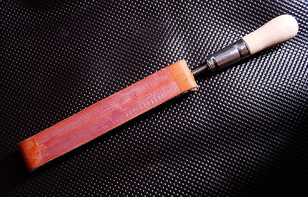

Busse needs to bring back their strop. :):):)
"THE BUSSE COMBAT "AIR BLEEDER" LEATHER STROP!
These are great for making your edge so sharp that the "Air Will Bleed" when your knife passes through it . . . .
One side is treated with a Coarse hand burnished compound and the other side is treated with a Fine hand burnished compound. The sides are marked "A" and "B"
The tension is adjustable so that it works just as well on a flat edge as it does on a convex edge.
The idea of an adjustable strop dates back to long before the 1800's and there have been many, many variations on the theme. There was a fella who made a hand-held adjustable strop back in the '80s with different materials that was very effective and served as the inspiration for this model.
Our adjustable strop is made with machined aluminum, vegetable tanned leather, and assorted American made hardware."

You may find it on the forums for sale once and awhile. Maybe skunk will get a few more in stock one day. It was made by busse and sold at the company store around Jan 2006.
oh man, i want one!! does anywhere sell this strop?
Interesting. I would like to obtain one as well. Anyone with more info, please post away! Thanks for posting clone7!
yea, that thing is cool. anyone know a link that shows how to make one? it looks very easy, i think ill try it. thanks again.
The Busse strop is basically a loom strop which is available in a range of prices and qualities. I find it useful for maintaining all edges. :thumbup:
