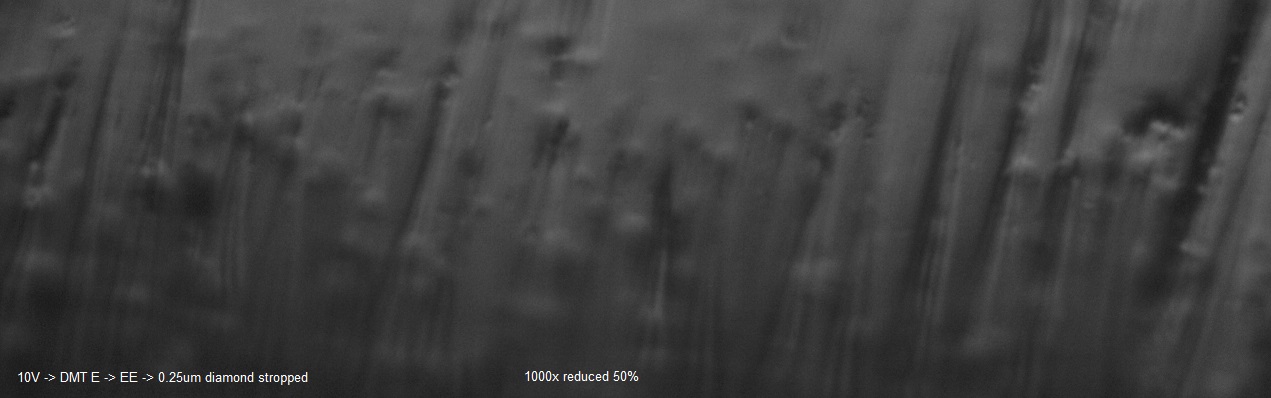

Here is 10V after 2 minutes edge trailing on 1K waterstone heavily doped with 1200 grit green SiC (hardest type of SiC)
Through the eyepiece - I can clearly see virtually zero carbide shaping (in other word, couldn't find any carbide with clean flat facet). Lumpy protruding objects are carbides - yep there are so many of them.
400x
I wasted a couple 800grit SiC belt in futile attempt to remove some 10V lower grit scratches - each belt belt lasted about 3 revolutions before glass smooth.

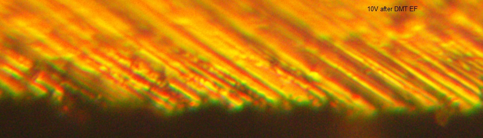

Edit to add: Edge after 1 minute sharpen on DMT EF. It looks like a clean abraded surface (a lot of plowing done)
400x
Smooth bumps are carbides - 1000x reduced 50%

That clump of carbides on first image, do they the one contribute to the edge wear retention? Makes me wanting BCMW 10V now :D
