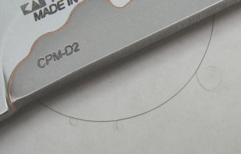

You may perticipate yourself as well as present company which NIB knife able to whittle hair (like Kershaw). I know Friction Forged knives able to do this, but do not have pictures - can someone help and send me one?
Thanks, Vassili.

You may send picture to me as an e-mail attachment and I'll post it.
Thanks, Vassili.

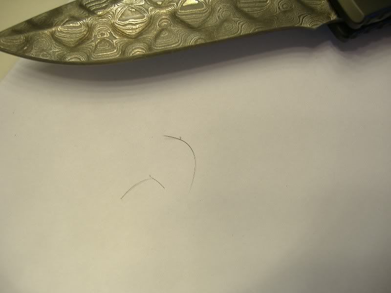

OK Vassili, this is not the best picture but I whittled these hairs a little with my Boker Leo II damascus knife. It has never been stropped so I guess I got lucky touching it up recently with the Sharpmaker. It came pretty sharp. There is no telling how sharp you could get it.
Thanks,
Keencutter
Thanks, I add your record and two more - I will upload it on my website Monday, may be. It is very excited - may be I'll visit office over weekend.
Thanks, Vassili.
