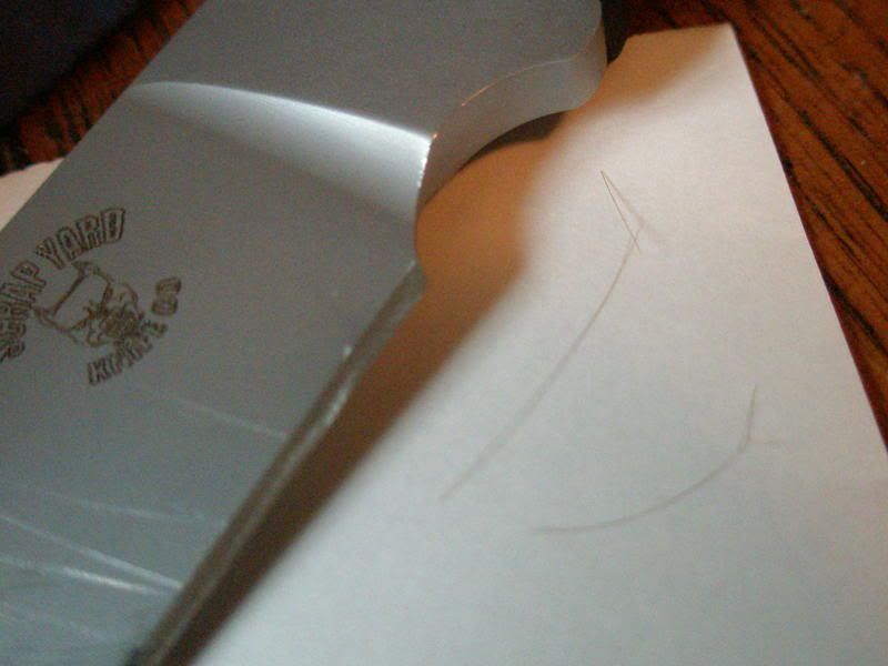

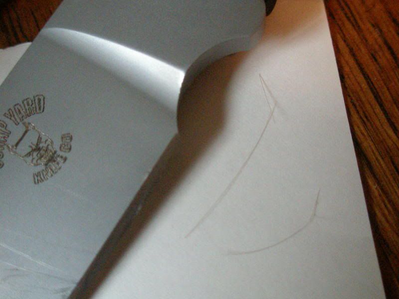

love to be on the page, I've gotten much better results with S30V and VG10 but I wanted to do a steel no one else in the thread did, so I started on a scrapyard.
results are not nearly as good as other knifes, but here they are (sorry for the bad pics)

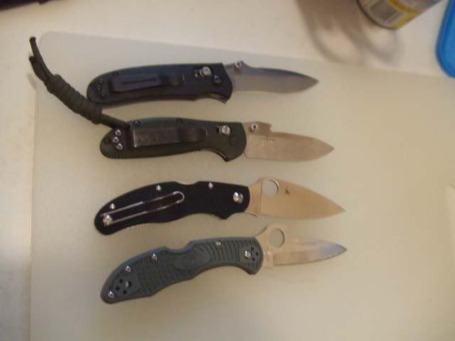

I got bored so here are my photos.
Caly3
Delica 4 wave in foliage green
Bm 558 "wave"
Hk 14210
All four knives I got around to testing.
14210
558
Caly3
Delica4 wave
My process is Ultra Fine on SM 30/40 and finish off on a strop either loaded with CrO or 1 micron Diamond Spray.

I saw all these cool high end knives and some moras done but I noticed there wasn't a single case or anything like it. so here it is.
I use a DMT DiaSharp coarse to apply a slightly sub 30 degree angle. Then I bring it to a solid 30 using the brown spyderco SM rods. then about 30-40 passes per side with the fines. From there its a piece of thin single ply cardboard with CrO .5 micron compound on it.
